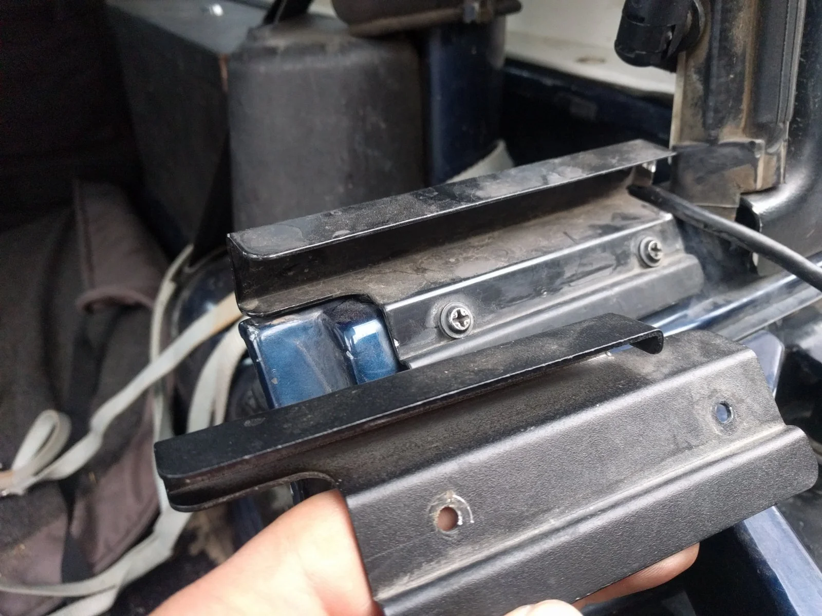

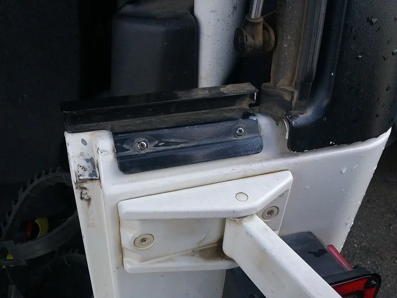

Figured I would post up this here. This is for folks considering the Bestop Trektop NX for summer/warm weather but are also planing to keep their hard top for winter.
The TrektopNX calls for replacing the two brackets for rear window on either side of the tailgate with smaller ones. Know that these will not work with the hardtop glass which will not be able to close with the smaller brackets. So I highly suggest keeping the larger brackets for reinstalling the hard top. They have the same mounting hole size/positions so it is an easy swap just be aware you will need to store these.
I didn't think about this when I installed the Trektop this past summer because part of me was thinking of selling the hard top at the time. I just reinstalled the hardtop and am happy I kept the brackets

I didn't think the hard top would fit with any of those soft top brackets installed... Will it? If so, I was obviously wrong! I only have a hard top, so I don't have a soft top to go by.
When i got my Rubi used it only had the hardtop. I guess the large bracket i have is for factory style soft-top since Rubi's came stock with both as far as I know. There is a lip on the bottom inside of the glass of hardtop that fits in those brackets and what causes the small brackets not to work with it. It is by no means snug though , so I suppose one may not need the larger bracket at all for the hard top.
The brackets on my TJ for the rear tailgate bar stay on with either top. The weatherstripping on the bottom of the rear glass is molded to fit over the brackets.
My jeep came with a hard top and had the wider rear brackets. Then I bought a Bestop Duster, and it came with the narrower brackets, so I think all of Bestops top use the narrower bracket. I factory soft top tail gate bar uses the wider factory bracket, so you could make the bestop stuff work if you use the factory tail gate bar.

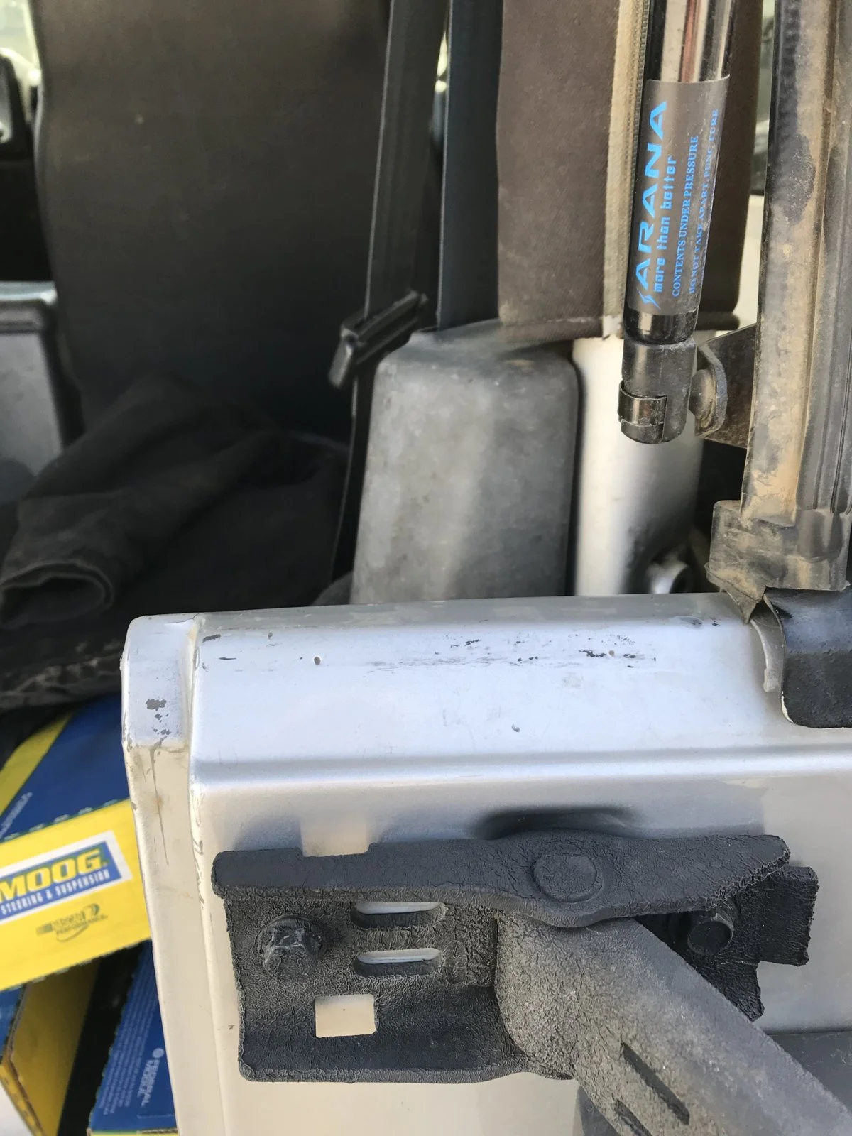

Crap man ! I bought my 04 used with the hard top. Mine doesn’t have those holder tabs. Damnit to hell that rear glass has given me fits cause it always pops out of the grove and rattles around. I’ve pulled the glass lower and tightened it up as much as I dare. Time to search the inter webs
