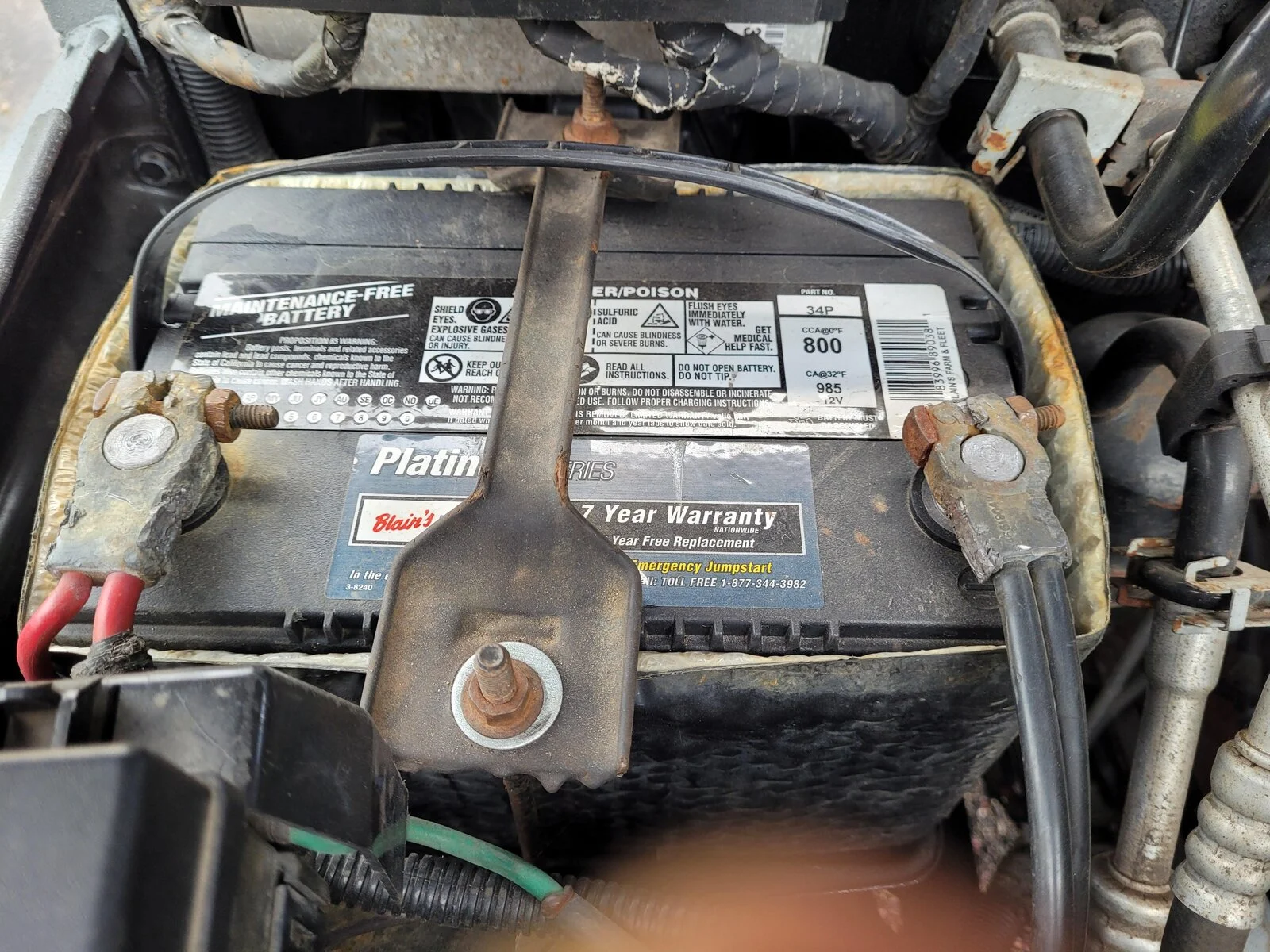

What is the plastic surrounding my battery?

I noticed that my battery has a bubble wrap like pouch arround it. I found a electrical plug which I assume is for an engine block heater as opposed to a battery heater? I have not been able to find time to trace the electrical plug down. I assume it is for a freeze plug engine heater. So is the bag like thing around the battery to protect it from heat? does everyone else also have one. I never saw one listed in aftermarket parts places.
PIC? I haven't ever seen anything like what you're describing so would love a pic.
Some came with a bubble-pack like wrap which helps insulate the battery from engine heat. The electrical device that sits underneath the battery is a temperature sensor that tells the alternator, via the PCM, when the battery is overheating and to slow down the rate of charge.

ok thanks, I will post a pic of it for others later when I get outside.
my 2014 ram ecodiesel has a insulation wrap that also covers the top. i think it might be more to keep them warm more than to protect from heat. batteries lose power if they get cold.

They make a battery heater that looks similar to that too.
I can't tell from the photo, if that's a heated wrap or just an insulated wrap.
But cord or no cord will answer that question.
Most of the heated battery wraps I've seen have been orange.
yes I could not really see any cord to the battery without taking it out. its getting cold here and don't really have a garage to work in. I guess I should plug my electrical cord in to see if it heats the engine or the battery. Seem obvious, but with little time I can't always play on the jeep.

If there's a 110vac electrical cord and plug hanging from your engine it's for the block heater. There is no heater for the battery.
