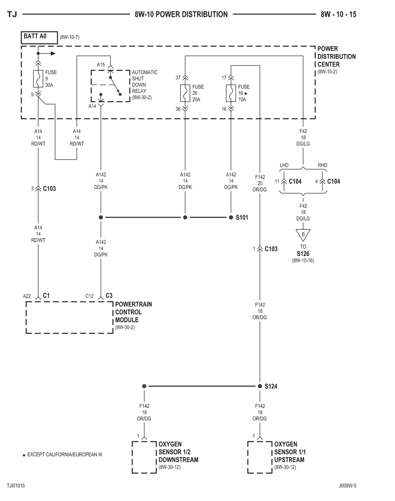

When you put that larger fuse in and the wire melted bare, its possible the dark green/pink wire(also ASD) melted together to a wire that is fed B+. That green/pink wire goes from the ASD relay to the: PCM, both oxygen sensors, and all fuel injectors.
I can help you isolate the circuit. set your multi meter to measure voltage at that center pin of the relay holder. Then pull fuse 26 and see if the voltage goes away. Then pull fuse 16 and see if the voltage goes away. if you still have voltage the short is either under the fuse box or goes towards PCM.
8w-10-15 will help you visualize the circuit.
So... DMM set to 20dcv. Probe on center pin. Pulled O2 fuse (16) no change. Then pulled inject fuse (26) no change.
You need to focus underneath the fuse box, possibly towards the PCM. If the red/white wire melted, the dark green/pink is the same exact circuit so it should be melted as well.

I am thinking red/white and green/pink are fused together directly under the relay slot if it does.

Now I flipped the fuse box that wire green/pink goes from 3 down to one, which turns to green and purple. There are no fraya or splits anywhere all the way to the backside of the connection to the computer.
It should only be green/pink. Its possible the heat caused it to turn purple where it is only 1 wire. Somewhere underneath the fuse box the red/white is making contact with the green/pink. Chase the red/white wire from the relay socket, it shouldn't be very long as it goes from the relay socket to the fuse 9 socket.
S
So I followed red/white which leads to ASD relay(29) no frays both wires look good.
That shouldn't do that. I am thinking you shorted inside of the PCM..
