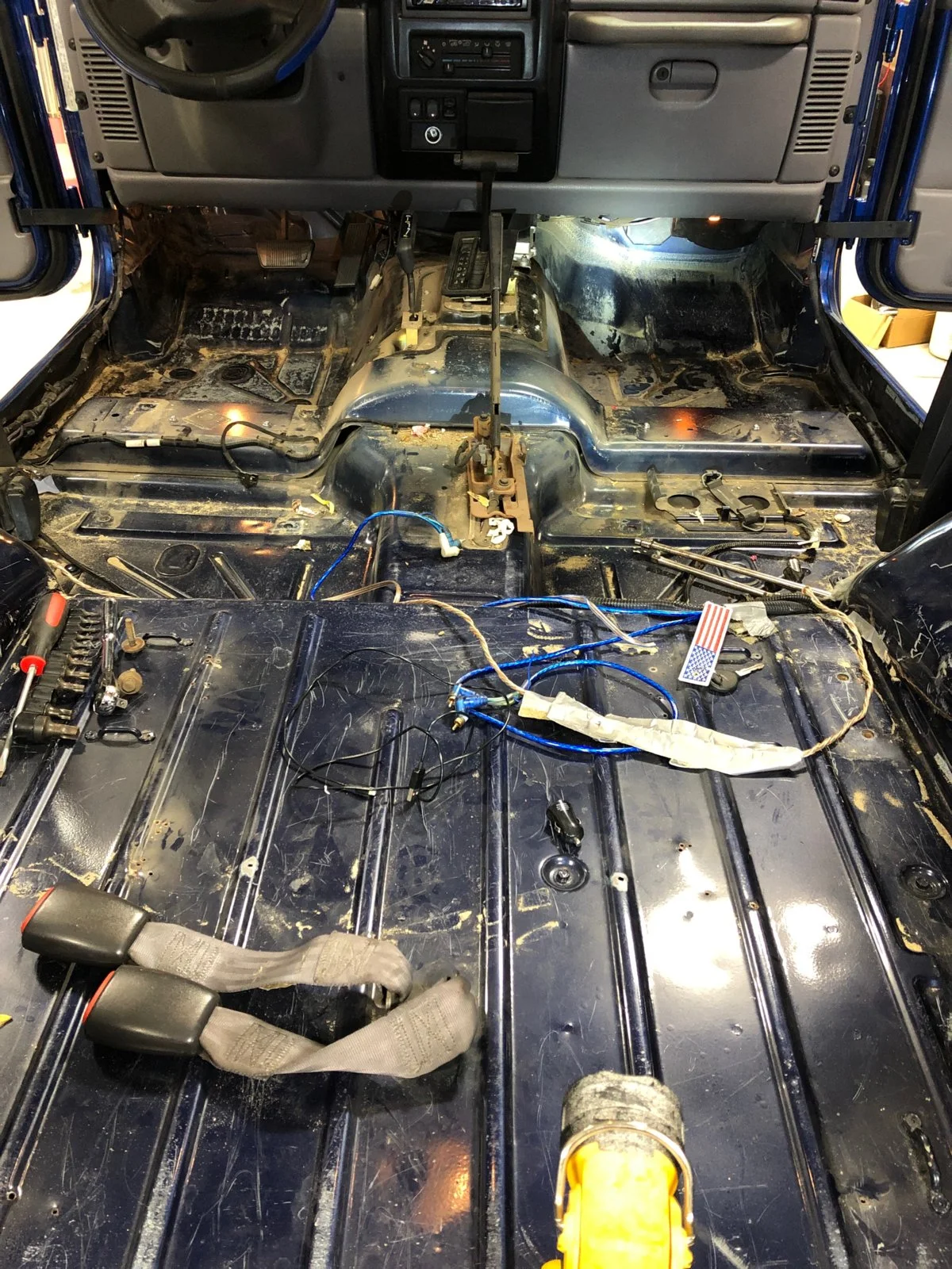

Here was the Jeep when I tore out the interior:
And here it is as of tonight, before I lay down the sound deadening and the new BedRug as well:

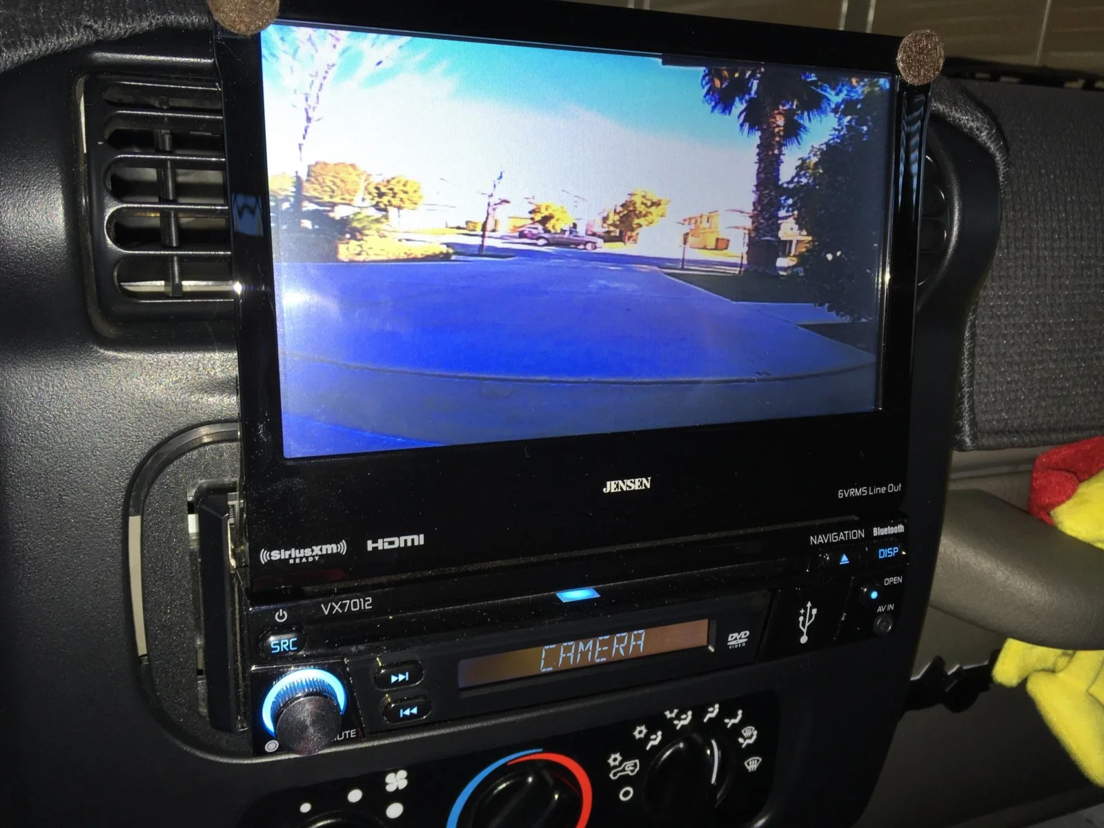

What are your thoughts on the screen? Does it bounce around too much? Is it stable?
Got this unit from Crutchfield 3 years ago - Jensen VX7012 (I know its a cheap brand but its been great so far). It does block the vents when open but I just close it when I run the A/C. I put felt on the corners of the screen to prevent rattling. I installed Polk speakers in the dash, Alpine in the sound bar and sub box in the back (insta-trunk area). It all sounds great even with the top off on the freeway. Unit came with rear camera plug so for $20 I got one from Amazon. Same thing with the HDMI plug which was even easier than the camera. Nice set up without breaking the bank.View attachment 56296 View attachment 56297 View attachment 56298 View attachment 56299
