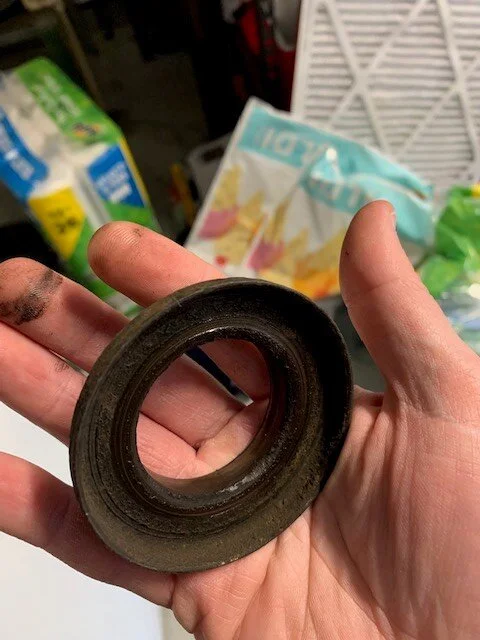

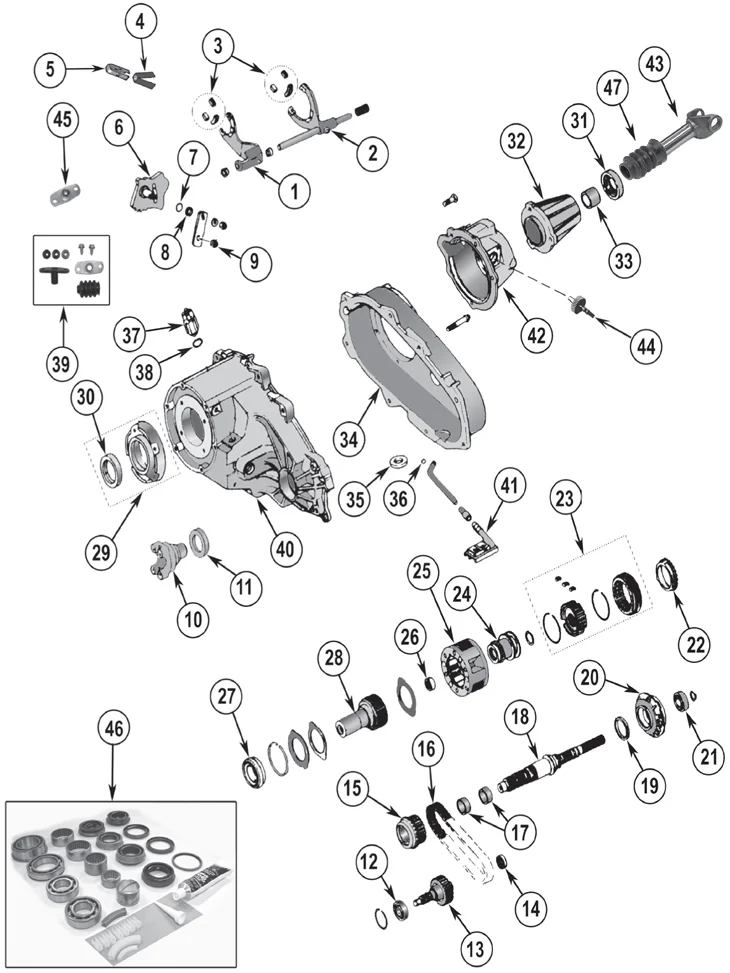

Shot in the dark, somewhat similar to my problem that doesn't seem too common.
I think it was part 11. It was loose. I could never figure out where it was coming from even after rebuilding the front driveshaft. The transmission shop I brought it to couldn't replicate the sound so I drove it in 4hi with them in the Jeep. It takes a little longer for it to make the sound if you have the driveshaft off and even longer in 2 wd but it will eventually start making the noise again. They started working to remove the transfer case and noticed the piece was loose. 60.jpg
