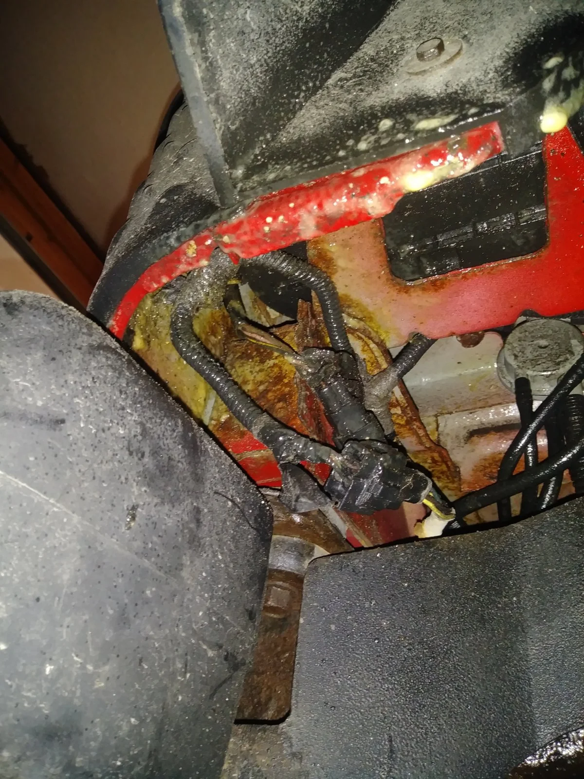

I'm missing this splash guard on my passenger side of my 04 rubi.
Whats it called and where can I buy a new one?
It’s part of the rear fender liner.
Try a junkyard, if you can find one with TJ’s in it, or contacting Daveysjeeps.com
Depending on your DIY skills you might be able to use something like an old truck bed liner if you can find a flat enough piece. Cut to shape, heat with a heat gun to make the bend in it to use a trim push pin in the factory hole on the underbody. Just an idea.
You can make one from the bottom of a laundry basket if you have to and screw it in with lathe screws. (Pan head washer screws or automotive trim screws are the same essentially)
