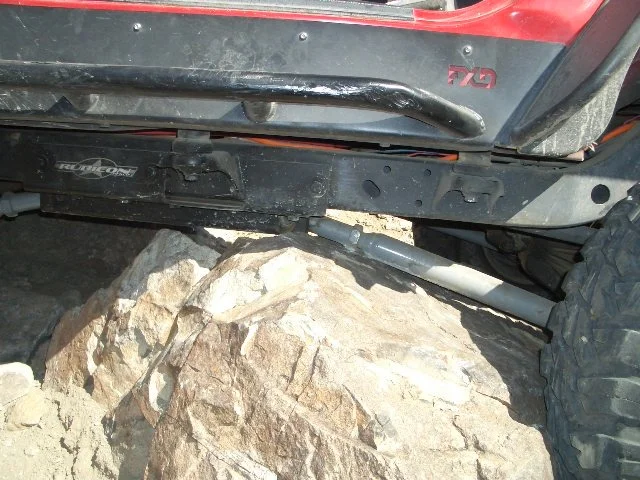

Yes I ran a Rubicon Express long arm suspension for years. The arm angles at the suspension heights we commonly install are not different enough to cause a difference in ride quality between long and short arms. Any ride difference you felt was attributable to something besides arm length. Shock model, tire pressure, tire size, placebo effect, etc. And just being an ME does not automatically make one a suspension expert.
After my TJ with the long arm suspension was stolen I bought a used TJ with a Currie short arm suspension. No difference in ride quality. But offroad the Currie suspension did nearly everything better. The only thing my previous TJ's long arms did better was getting hung up on the rocks.

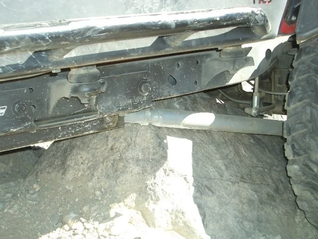

This is my previous TJ with one of its long arms hung up on the rocks. Again.
Reactions: D M
Why do you want a long-arm suspension? Bolt-on long-arm suspensions don't work worth a crap and despite their claims, they don't ride any better than a short arm. I installed a long-arm into my previous (stolen) TJ but my present TJ with its short-arm Currie suspension does everything better. Well not quite everything better... my previous long-arm suspension was MUCH better at getting hung up on the rocks. :ROFLMAO:
I have lots of these pics of my previous TJ's long-arms being hung up on various big rocks. Long-arms? Never again. :)
