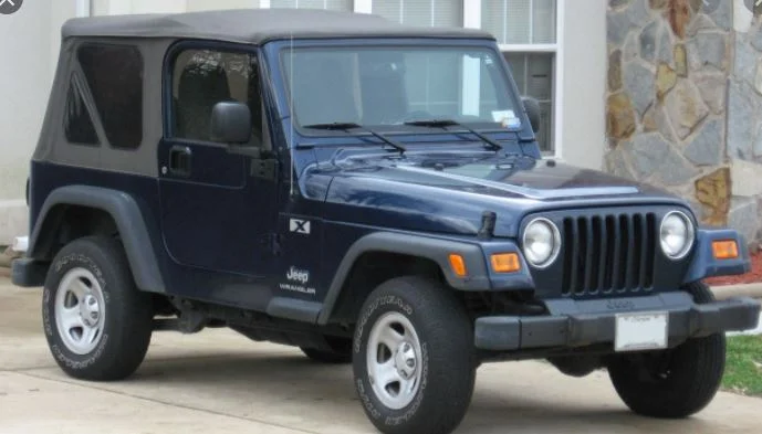

Stock Jeep
Same Jeep After Extreme Modification
Cost about 35000
30 cases of Beer
2 Cases of Whiskey
and 6 months of marriage counseling
