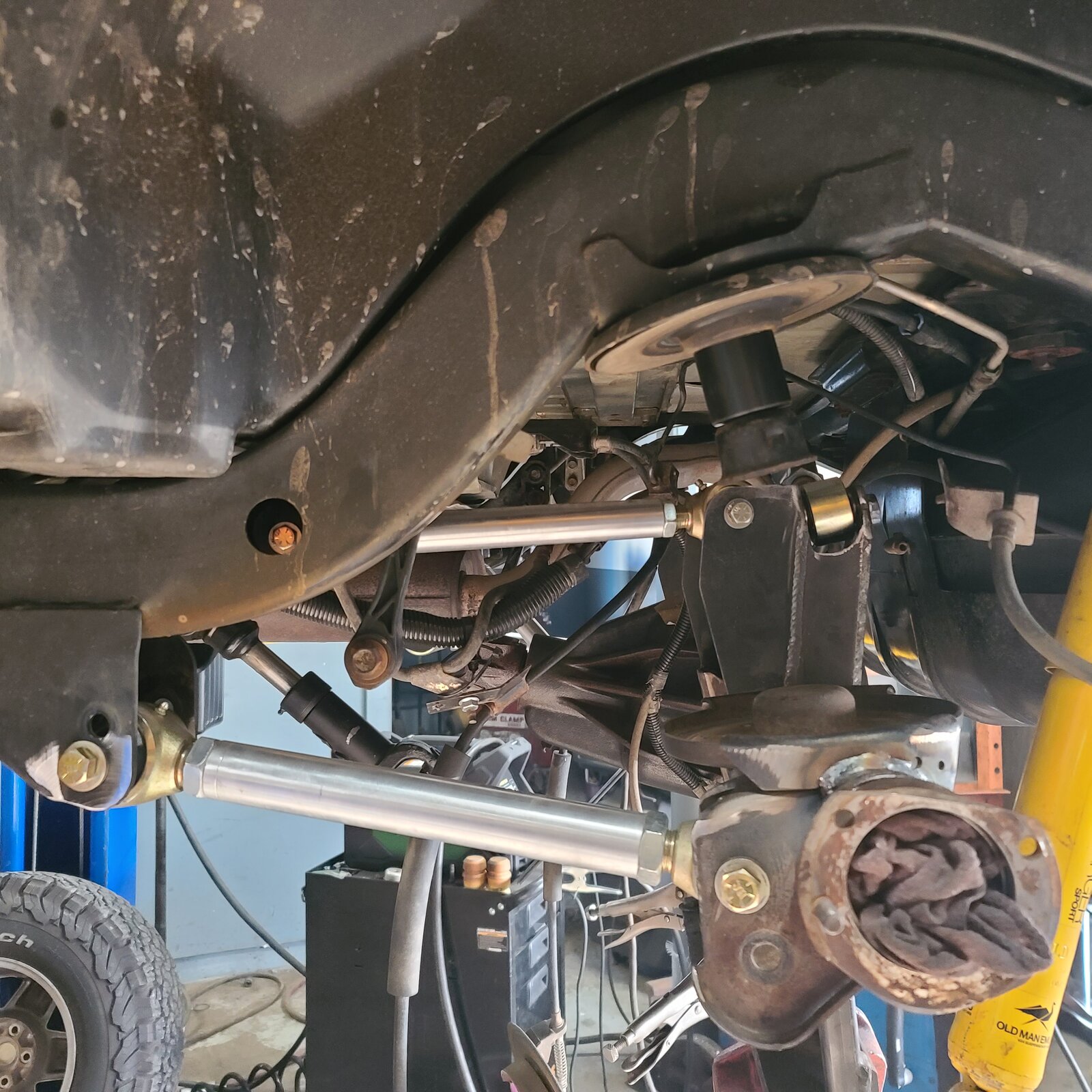

I have a Full Traction setup, and really like it, it’s is way better than my old short arm kit, or any short arm kit I’ve ever been in. I’ve done some tweeks here and there to it and have some more planned but I have no complaints. I’ve had it since 08’ I think.
Do you have the 3 link rear end? I've been looking at the Full Traction 6" long arm SRS suspension system, I think that's the one I'm going to upgrade to.
My personal opinion is that would not be the best decision. There is no such thing as a good bolt-on long suspension system. I installed one years ago and it was later when I figured out why more experienced friends were snickering at my choice.

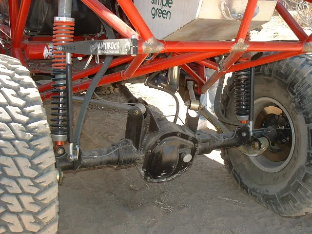

Outboarding the shocks can really help but losing the antiswaybars won't be of any help where a coil spring suspension is concerned. In fact you'd actually do better with an Antirock antiswaybar up front and the factory antiswaybar in the rear with extended links. Neither causes a reduction in usable flex or articulation. Stop drinking the antiswaybar kool-aid. Even competitors running similar suspensions in the King of the Hammers run some form of antiswaybar. Really. Savvy Offroad is one KOH competitor constantly winning their classes with f/r antiswaybars.
I'm running f/r antiswaybars (Antirock upfront) and my rig has great flex/articulation for the occasionally very tough rock crawling trails it enjoys doing.

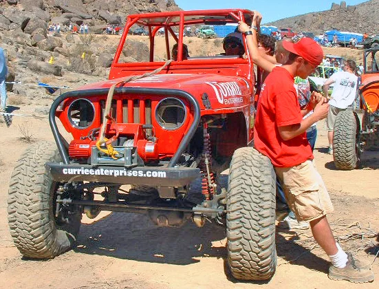

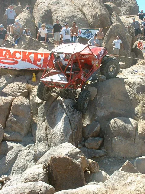

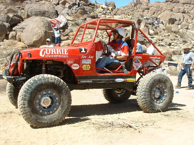

These are several photos I took years ago of John Currie's Fireant rig he won the overall championship with in the ARCA rock crawling series that preceded King of the Hammers. Notice he's running front and rear antiswaybars.
