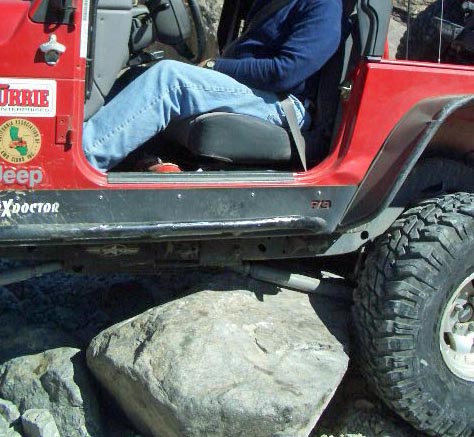

After my TJ with the long arm suspension was stolen I bought a used TJ with a Currie short arm suspension. No difference in ride quality. But offroad the Currie suspension did nearly everything better. The only thing my previous TJ's long arms did better was getting hung up on the rocks.
This is my previous TJ with one of its long arms hung up on the rocks. Again.
@Jerry Bransford can we please ban @Jerry Bransford from posting this pic anymore. He's posted it twice in the same thread. And although its highly relevant to this discussion, posting it twice doesn't make it any more relevant than the Rubicon Express sticker that attached to it.
