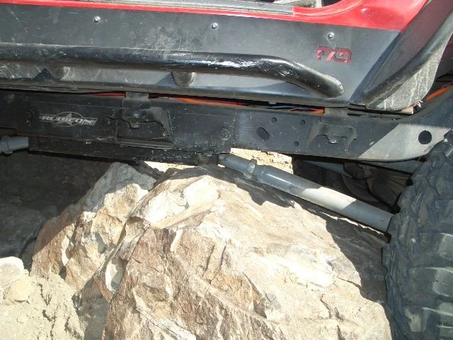

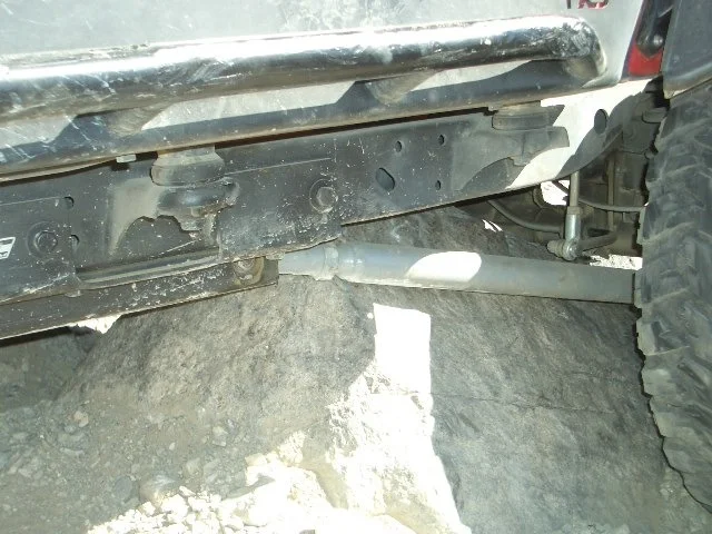

Why do you want a long-arm suspension? Bolt-on long-arm suspensions don't work worth a crap and despite their claims, they don't ride any better than a short arm. I installed a long-arm into my previous (stolen) TJ but my present TJ with its short-arm Currie suspension does everything better. Well not quite everything better... my previous long-arm suspension was MUCH better at getting hung up on the rocks. :ROFLMAO:
I have lots of these pics of my previous TJ's long-arms being hung up on various big rocks. Long-arms? Never again. :)

This is what Jeep builder/designer mrblaine and a buddy came up with after my TJ kept getting hung up on the rocks one day on a trail in Johnson Valley called Sunbonnet. I was the only one in the group of highly experienced rock crawlers (I am not including myself in that class) who was running a long-arm suspension that weekend... much to their amusement.
Their take on my situation...
