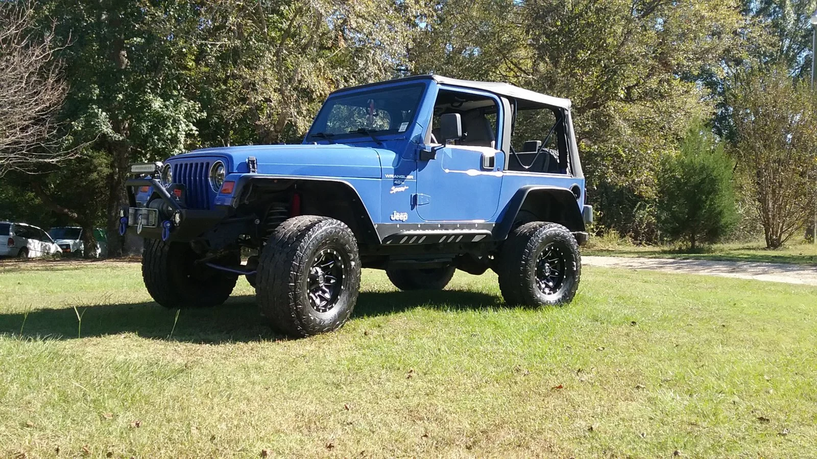

Better pic of the Jeep

ok yall have seen this before, but here are my next upgrades I have been thinking about. What are your suggestions to make my tj more trail ready?
currently I have 97 jeep tj 4.0 with 4" lift, 33" AT, 410 gears, Savvy upper adj. rear control arms. beefed up tie rod. new Rancho shocks , extended brake lines
