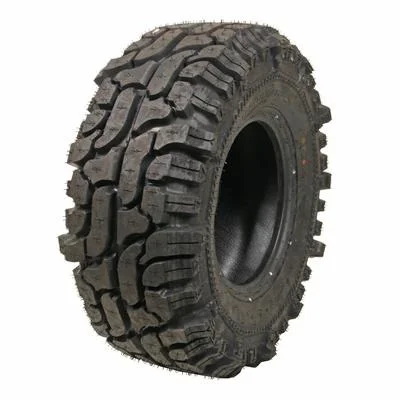

What the holy hell is a thornbird?
A Greta Thunberg?
Interco tire...don’t look quiet :)
