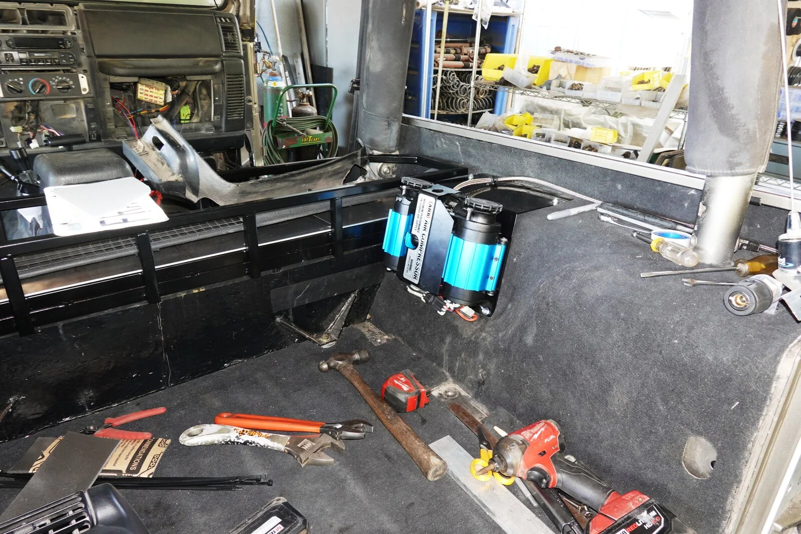

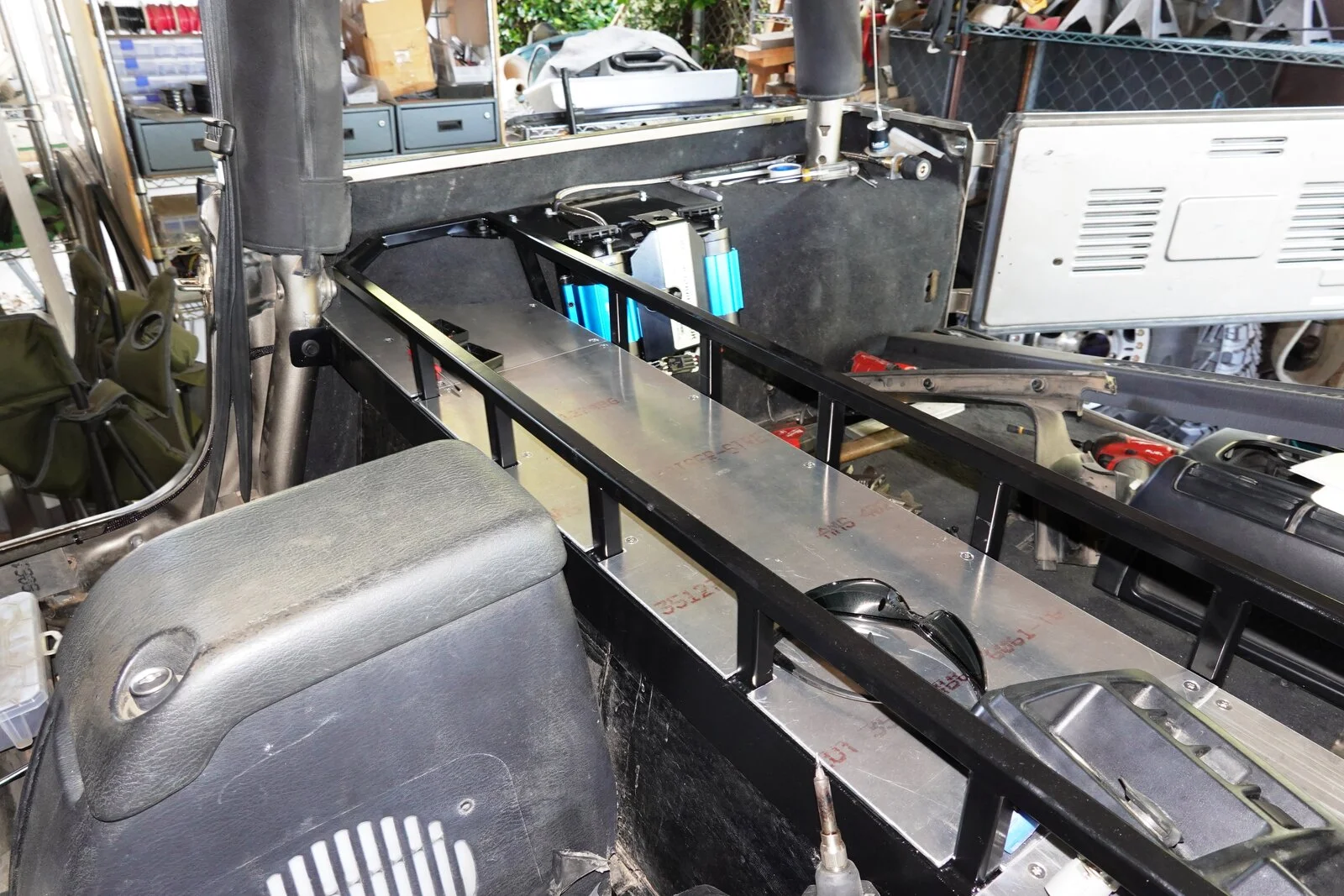

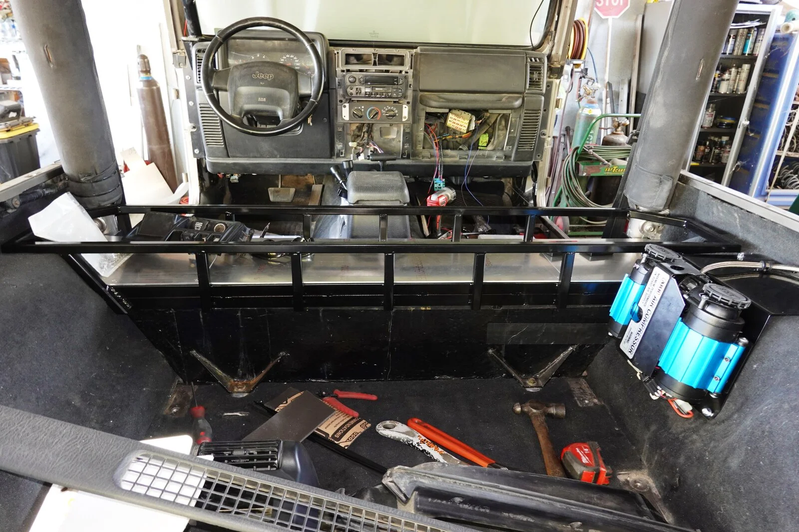

I just weighed the 104" TJ we stretched for 37's with RJ 60's front and rear. Or rather I weighed the sprung part. Front corner weights are 825 and rear is 600.
Front axle total less tires is 480. (axles weighed with a crane scale)
Rear axle is 275 less tires.
Tires x 4 are 460
Add in some miscellaneous bullshit and it should come in right at 42-4300 which I'm pretty happy with.

I may or may not be guilty of similar. The reason the rear corner weights seem a bit off is some of the fuel is under the front seats. The rear coil overs are supporting the rig 4ish" in front of the tail lights. We actually set all of the cargo right in front of the tail gate for a worst case scenario. The rest of the time it sits in the cargo tray we made for the top of the fuel tank.
