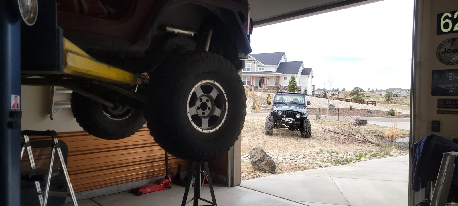

I outboard the rear when the Jeep was on 33s with a 4" spring and a 1.25" body lift, raised belly. There was more than enough room for 12s divided in half. That didn't change when I eventually put 35s on.
That being said, I wouldn't outboard until the pinion angles are well established. That means wait until the belly is tucked. During which, you are needing the body lift anyway.
