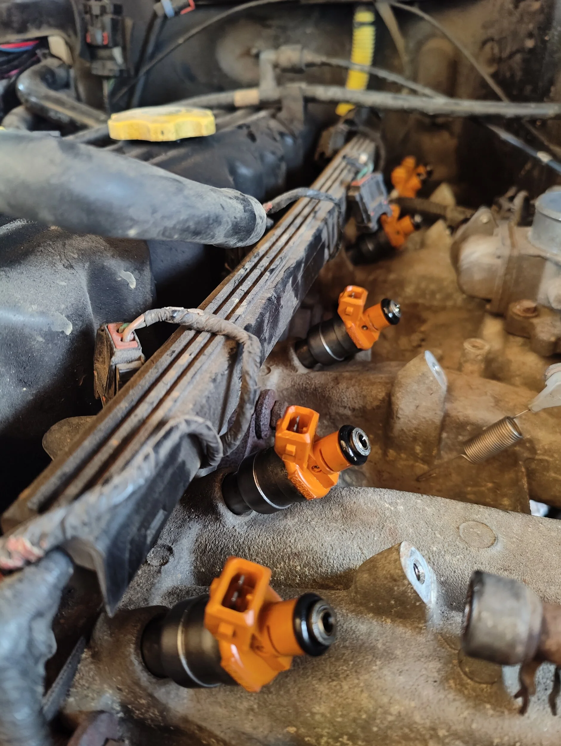

I got my TJ in late October with 140,000 miles, (Black Sahara 98% Stock and in great shape) I have been doing all the normal things that you do for a new-to-you vehicle, (oil change, spark plugs, air filter, replace oil pressure sensor, clean throttle body, clean and detail, etc. etc.)

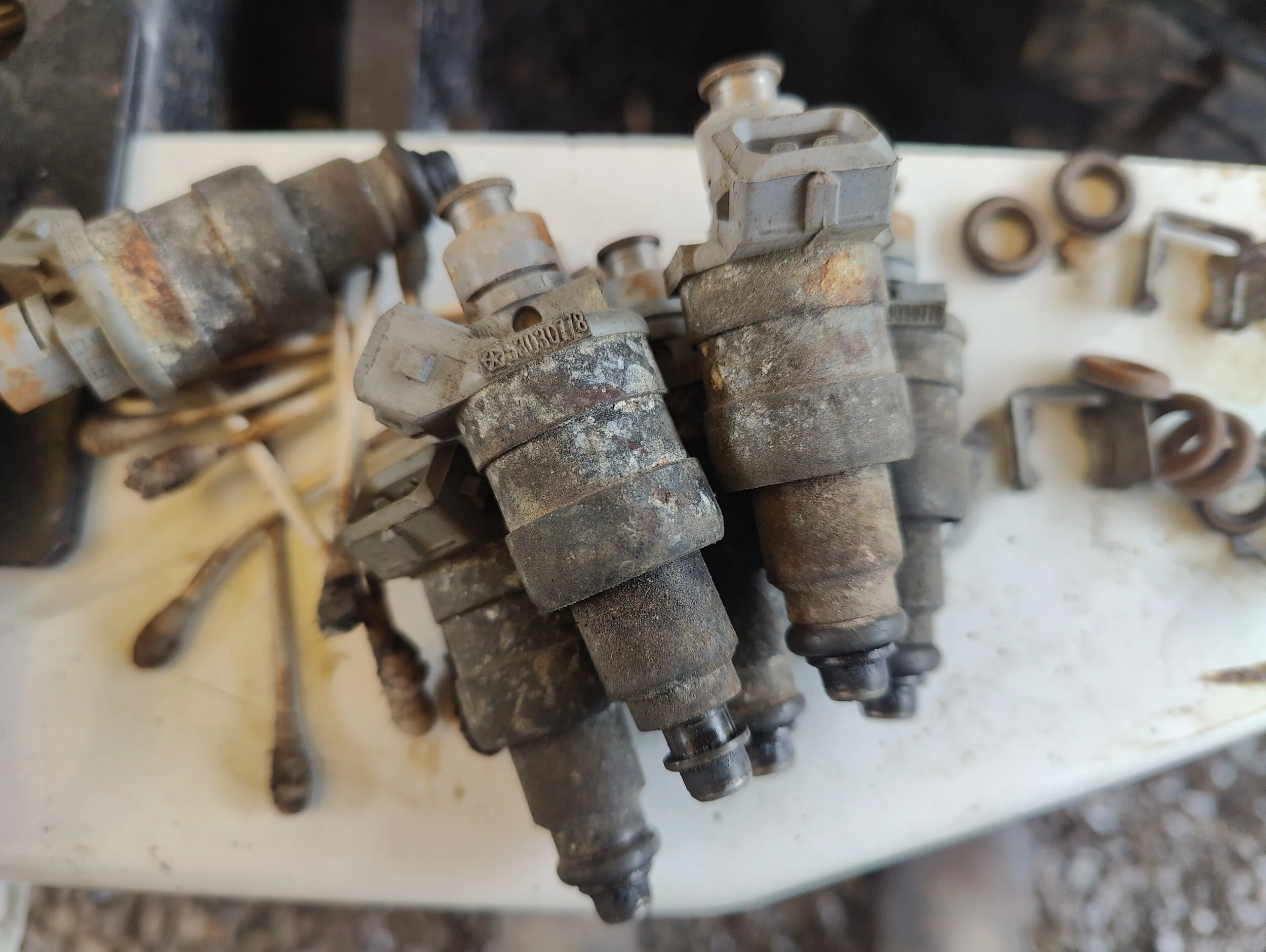

My Fuel injectors are the originals. They have many cracks in the casemate of the injector and I have the P301 misfire now and then. I swapped it to #2 and then got the P302. I have done injector cleaner in the fuel tank and I took the injectors out and cleaned the tips off.
I think at least the #1 is not up to par and I want to replace with the OEM Siemens/Deka but I am having a hard time sourcing from a legitimate outfit injectors. The jeep dealer near me did not even want to entertain trying to track them down and gave me a GO AWAY quote of $342.87 for EACH injector and noted that they are Remans.
