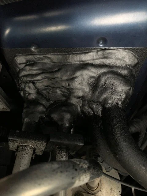

Mine ended up being a combination of things. First- my firewall to hood seal was bad- I changed that and 90% of the water leakage stopped, but of course 90% is not good enough on a leak like that. Mine was leaking thru the firewall where the metal A/C lines came thru-- I sealed that area up and it stopped. But I did do the cowl removal thing first-- cleaned and rodded that out but wasnt the issue. Good luck to you and keep us posted
