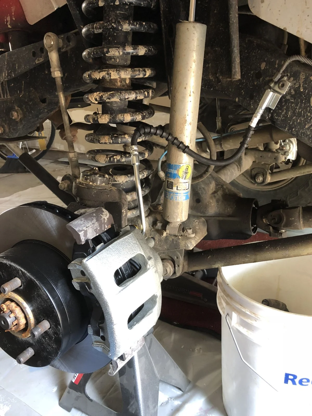

I am using the Raybestos YJ lines. BH38861 & BH38862
Reactions: OscarTJ
Got Crown Performance extended lines on my TJ. They're very nicely made and have held up perfectly, would certainly recommend them.
I've been running stock YJ front brake lines since 2010. Never had a problem.
