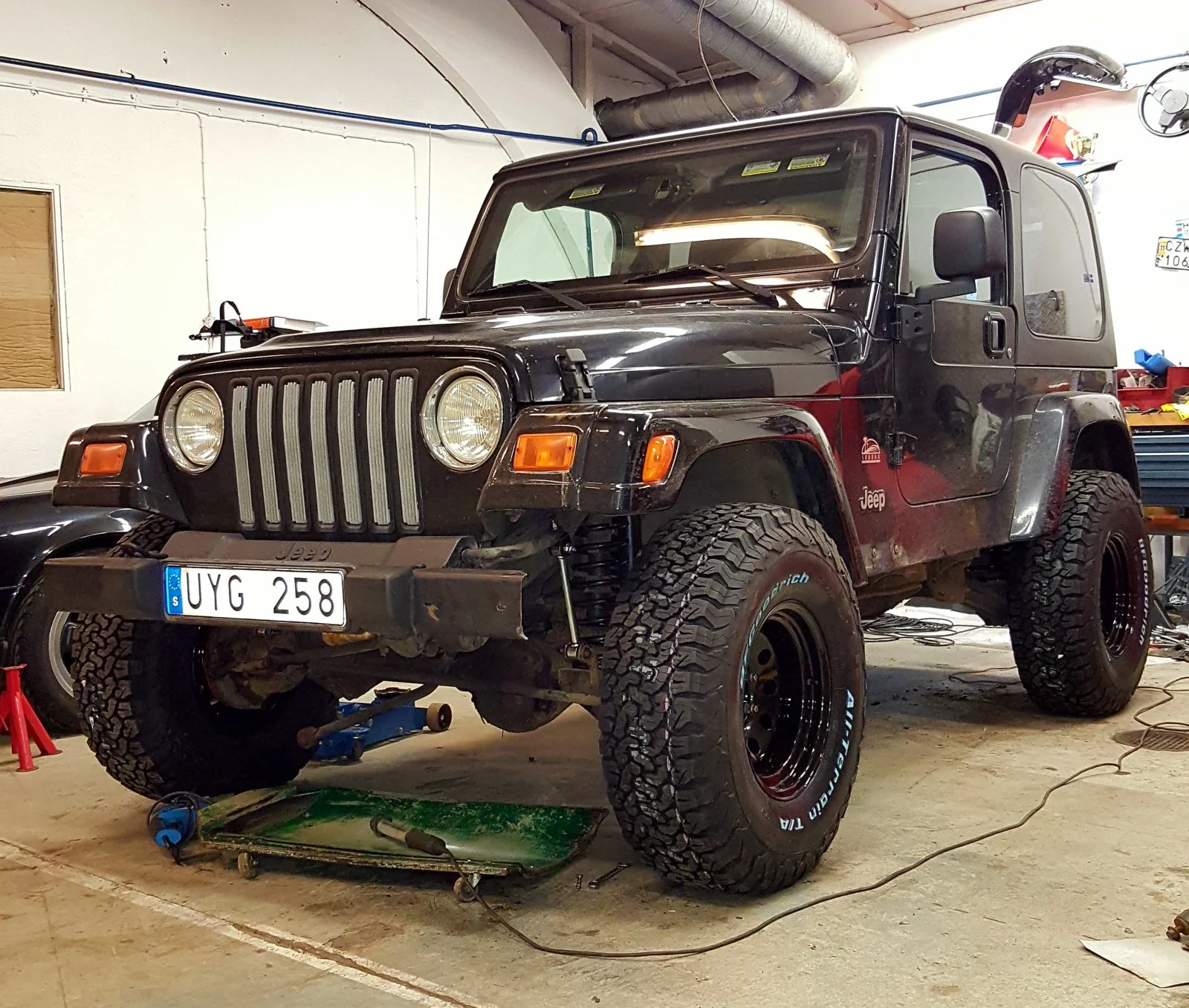

White letters out or in?
I have a Trailhawk Cherokee for a work car, It came from Jeep with white letters out. I can say without a shadow of a doubt, the 80s are over, and all street driven vehicles should have white letters turned in.
