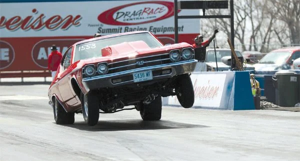

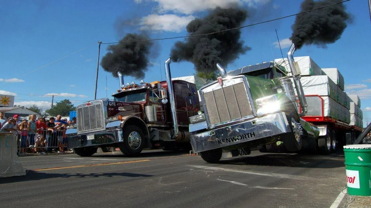

Torque lean can occur on any rear wheel drive vehicle. Passenger side only? Depends on which side is the driver side and what direction the engine spins.
Here we show off some left hand drive Americana!!!

i find the same guy in front of me quite often on the way home and it's crazy to watch him take off from a light, the rear right dumps and the front driver looks like it's gonna pull right off the pavement. little more engine he'd need a wheelie bar.

Any rear wheel drive car that I ever owned (mustang,camaro, chevelle etc) had some amount of lean to the passenger rear.
