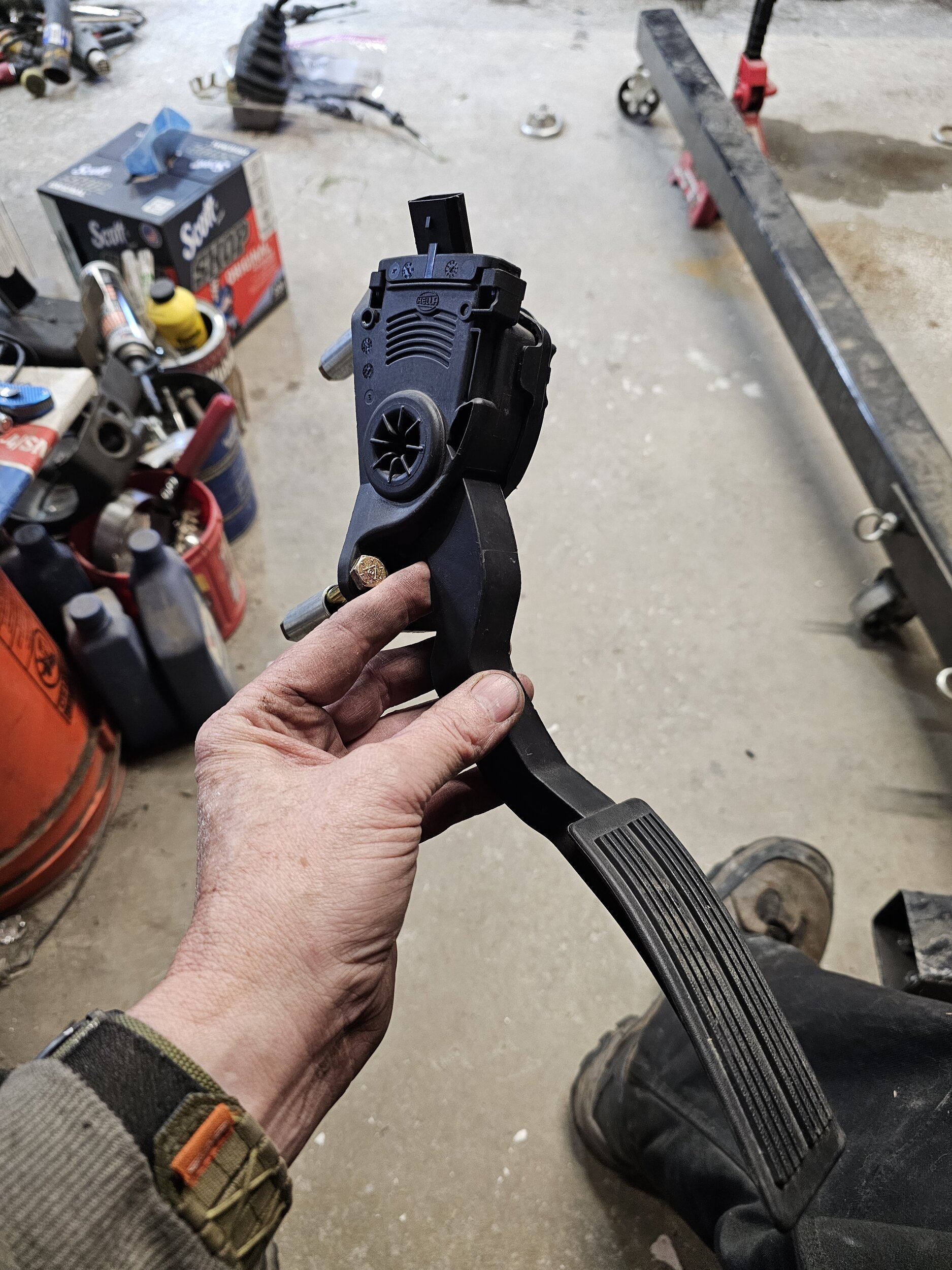

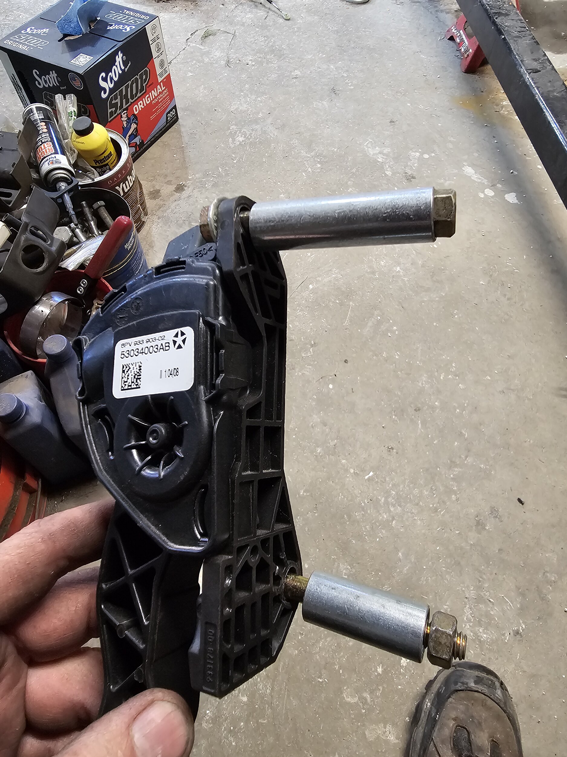

More Fuckery shit from this shop that did the install.
There's a few companies that offered a adapter plate for the DBW fuel pedal for the Hemi swap. Instead of sourcing one they just drilled holes in the firewall and used some spacers to mount the pedal.
Hopefully I can still find one now since the TJ platform isn't as popular.

That place really likes spacers and saving bucks. Not much thread was holding that trans mount on eh?
Nope not much at all. I wouldn't recommend the shop to anyone after seeing all the Fuckery they'd done 🙄.
Here I'd thought I was a hack. My work isn't on their level.
