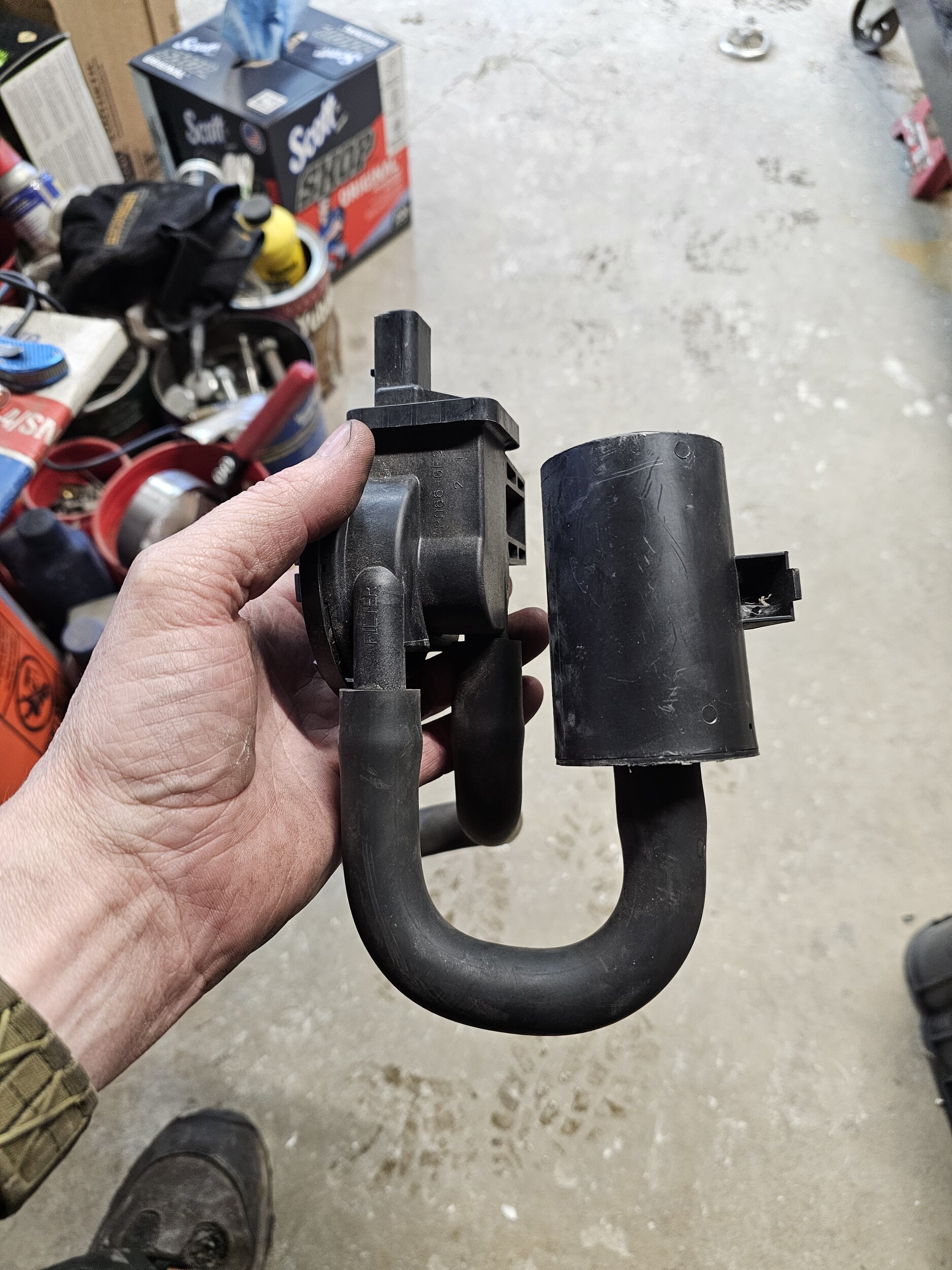

Got the charcoal canister removed from the NVLD detector and started looking at what I'll need to make it work with my GR tank.
Here's @NashvilleTJ setup that he did.

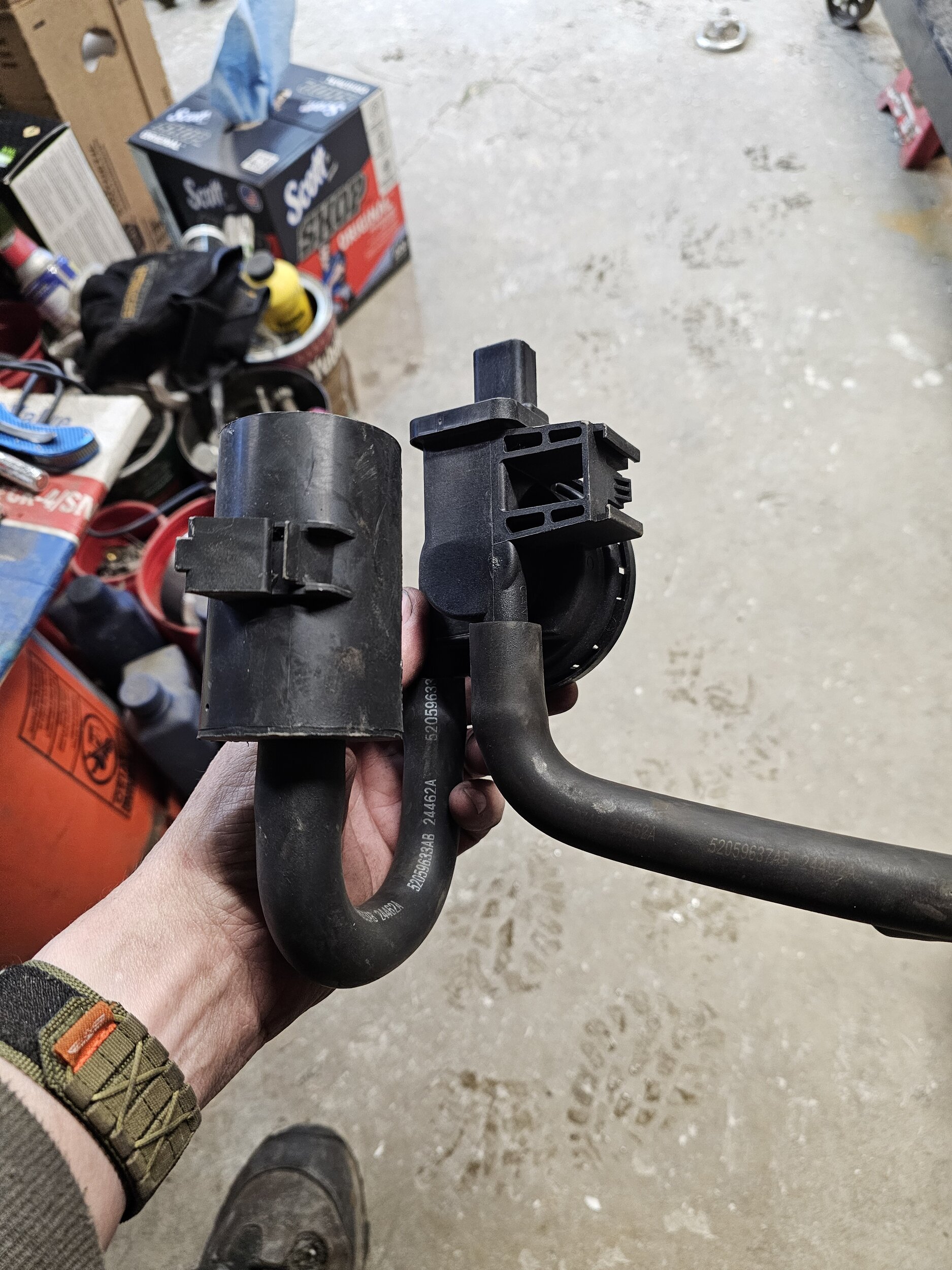

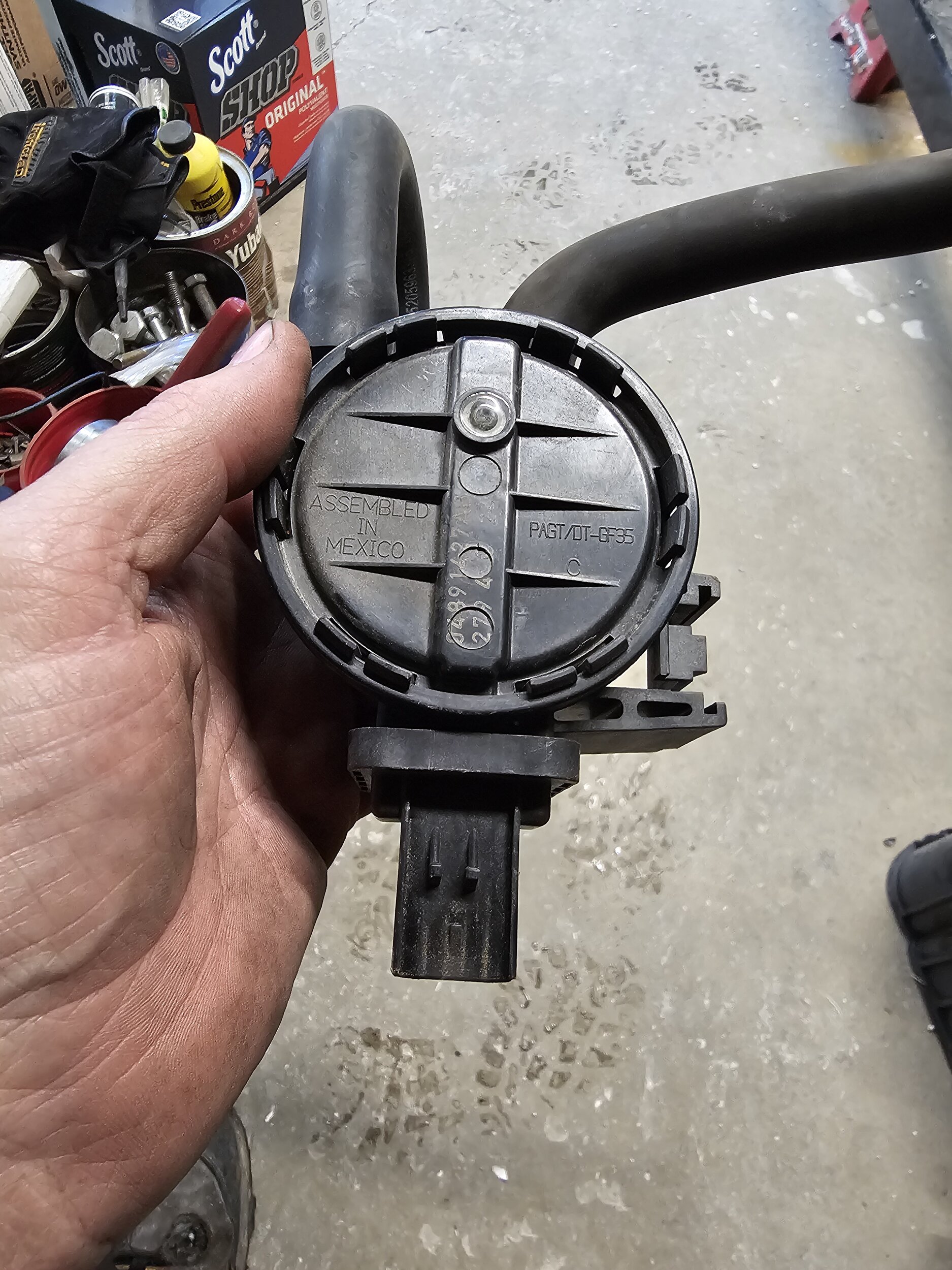

Jeff, What is this? Looks like a splitter or some type of valve? I don't have one on mine.
I'll have to fab up some type of mounting plate to tuck it up in the right rear wheelwell. This is all I'm working with on mine, I don't have the larger vent on the right side of my tank but think I can plumb the larger line into the smaller vent line on my tank.

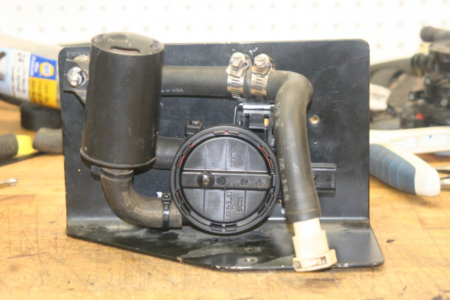

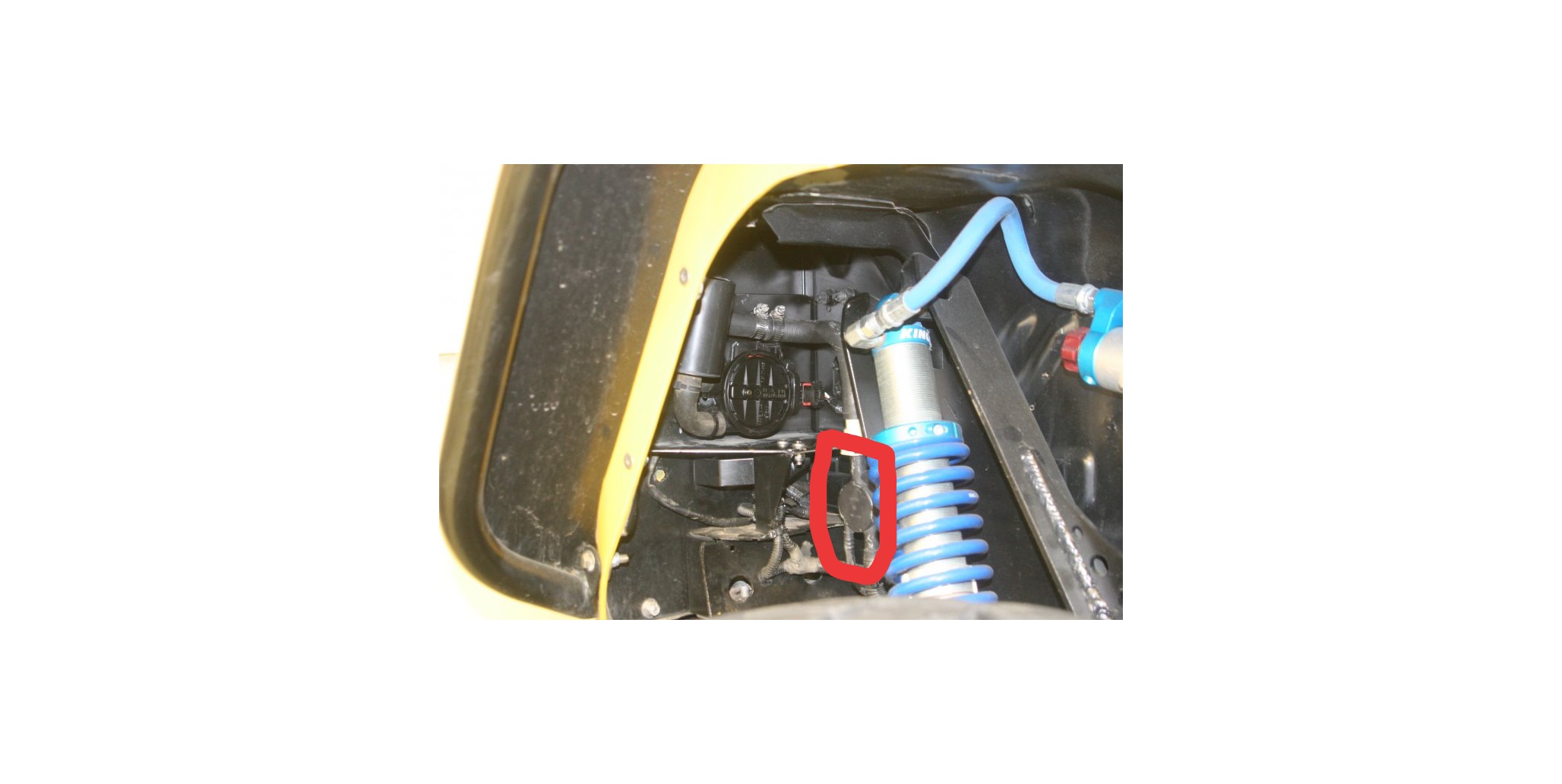

Then took a bunch of measurement s of how the motor mounts are on the donor frame. I'll have to adjust a little since my frame is a little longer in the front with the steering box rotation but there's also a hole on each side of the frame you are supposed to index off of. I'm just not sure if those holes are still there on mine with all the mods I'd done. So if not I also know how far off the front of the frame.
I also verified that I have 5/16" hard fuel line that came off my TJ so I'll leave the 8AN fuel line and then get some quick disconnect fittings to use on the fuel line. I'll remove the 6AN return line that I'd installed. Might have to make a short extension to reach the fuel rail but that's it.
That “splitter thingy” is a stock piece off my ‘04.

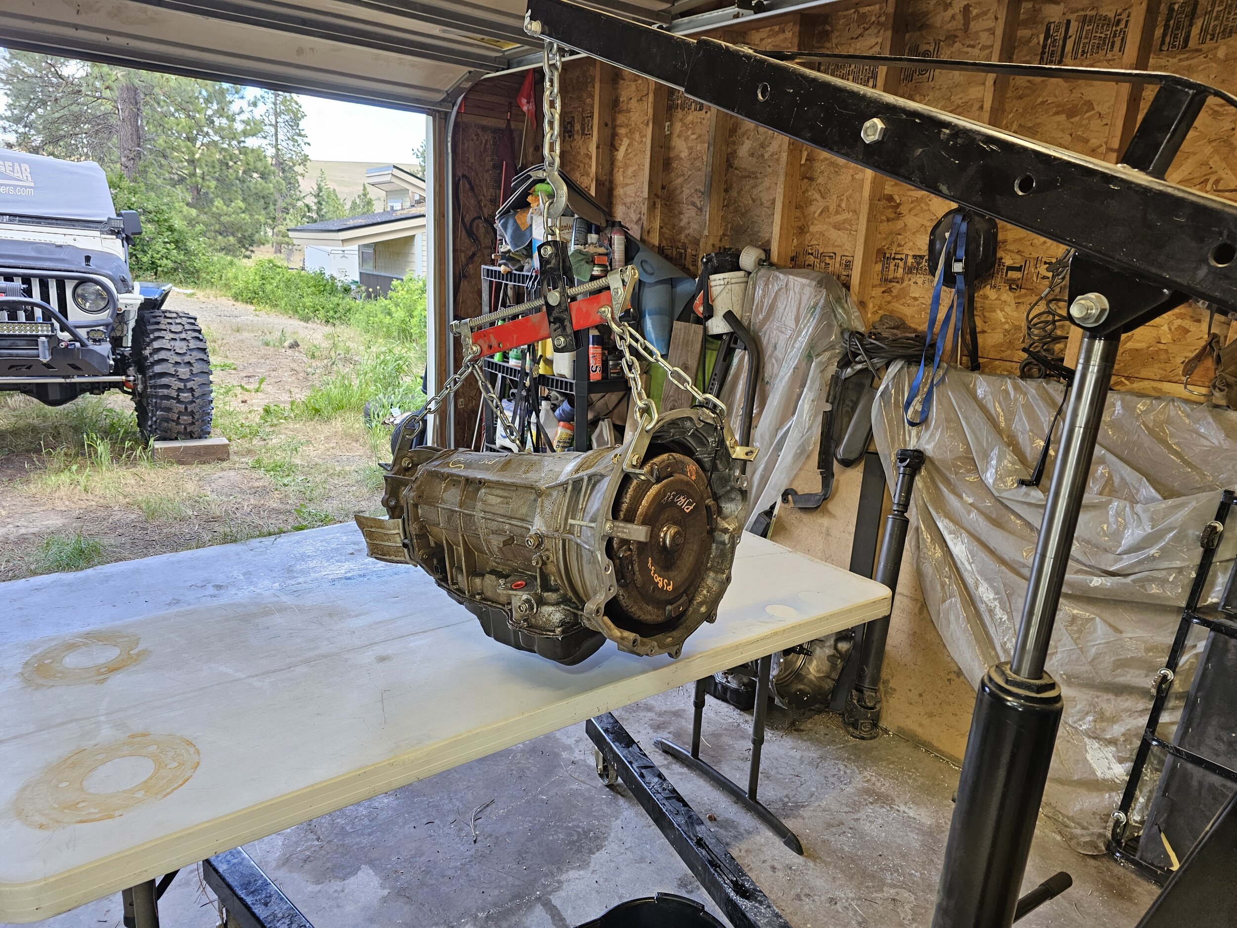

Brought my camping table into the garage and am using it to teardown the 545RFE transmission..
Got a Lubelocker pan gasket for the transmission. Also bought a pan with a drain plug. Have to weld a temperature sensor bung into the pan first.

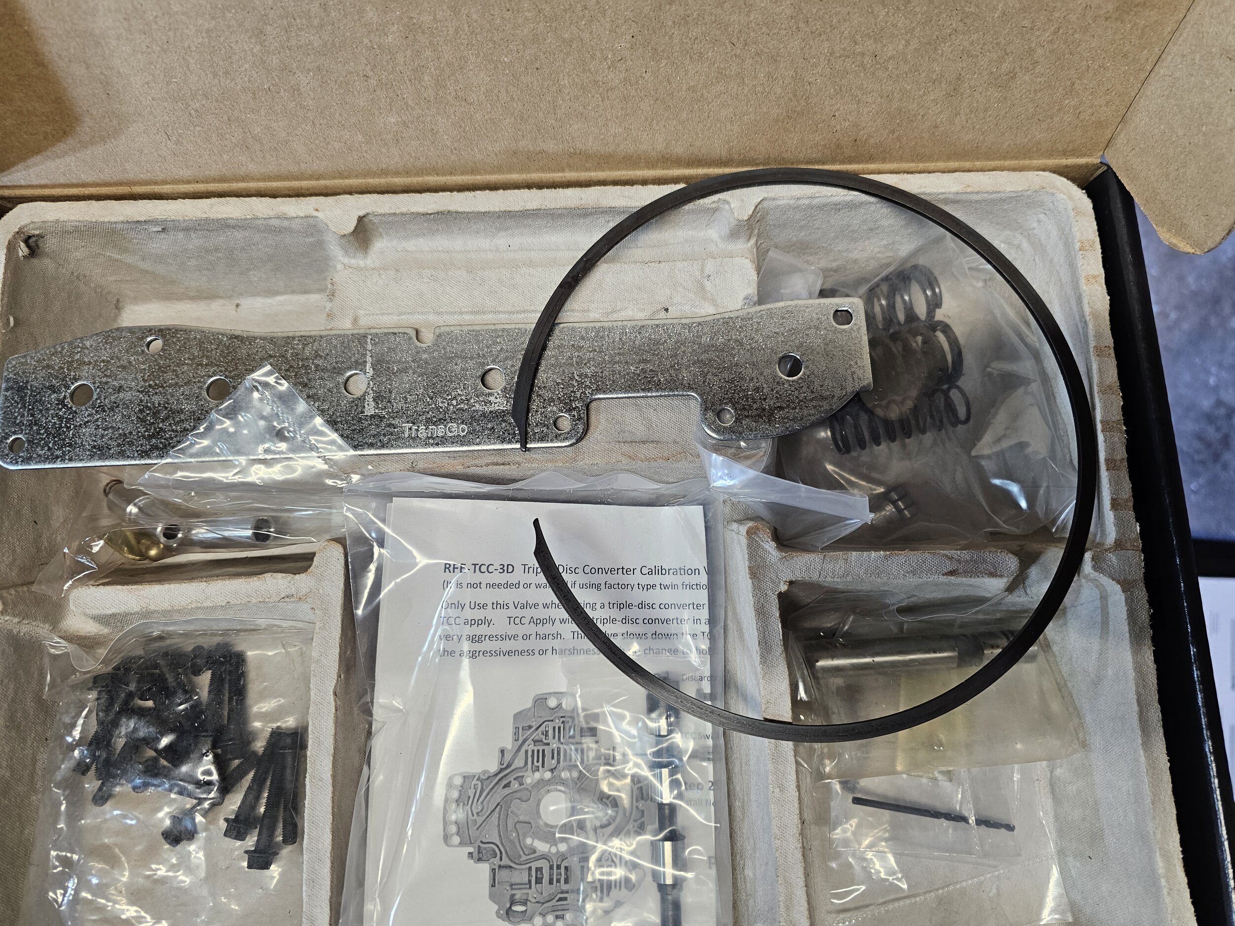

Then bought a TransGo shift kit for the transmission.

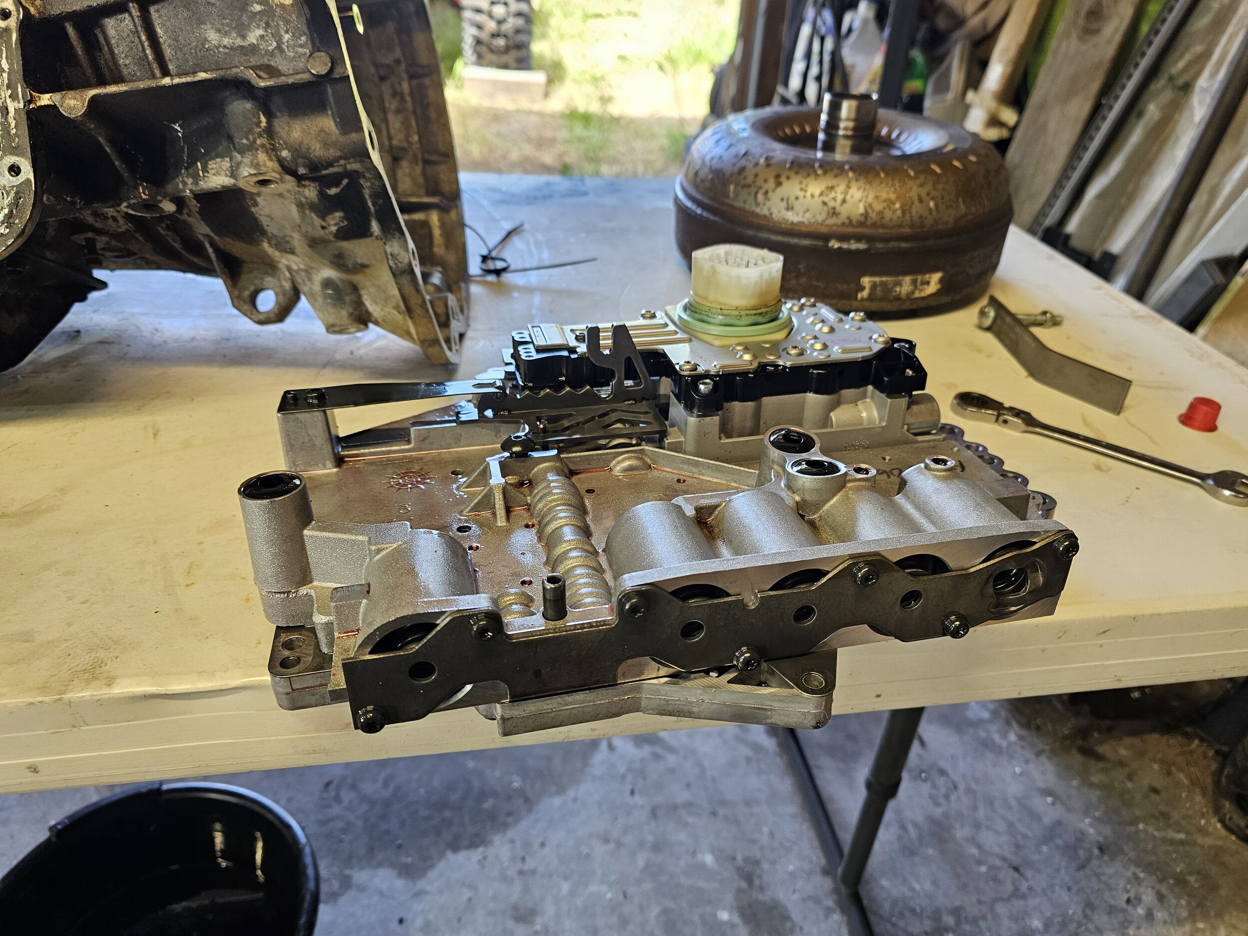

Got the pan off the transmission and the valve body removed.
The shift kit
Got some reading to do first..
The shift kit

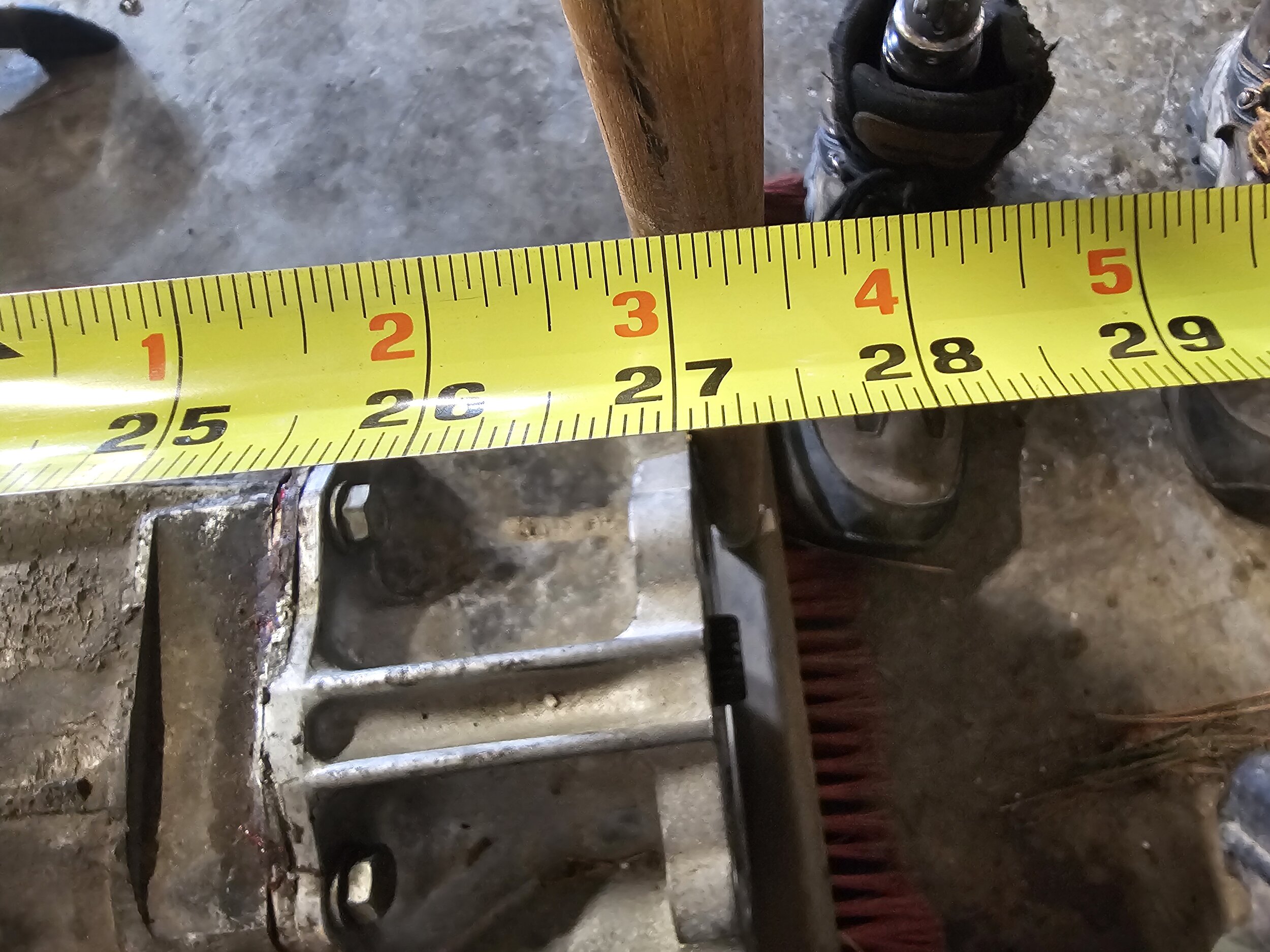

How long is that 545 from where the engine mounts to the tcase?
I'll measure the length of it tomorrow.
FYI we wheeled with @genesmail2001 last week who has like 30 years experience with transmissions if you have any questions he may be able to help.
Cool, if I have questions I'll make sure to hit him up.
Love this on the instructions.
Thank you.37" or 27"? 27 is pretty compact for a tough 5 speed auto
27"... I fat fingered it on my phone and wasn't paying attention... The newer 8HP70 is the same length if I remember correctly.
Should NOTE: The JK/JL folks talk about the 545RFE like the TJ/LJ folks talk about the AW4.
Uhhhh... The smart end of the stretchy stick says 27" not 37" :ROFLMAO:
I might be a little sleep deprived so what am I missing here?
Yep... Damn big fingers...

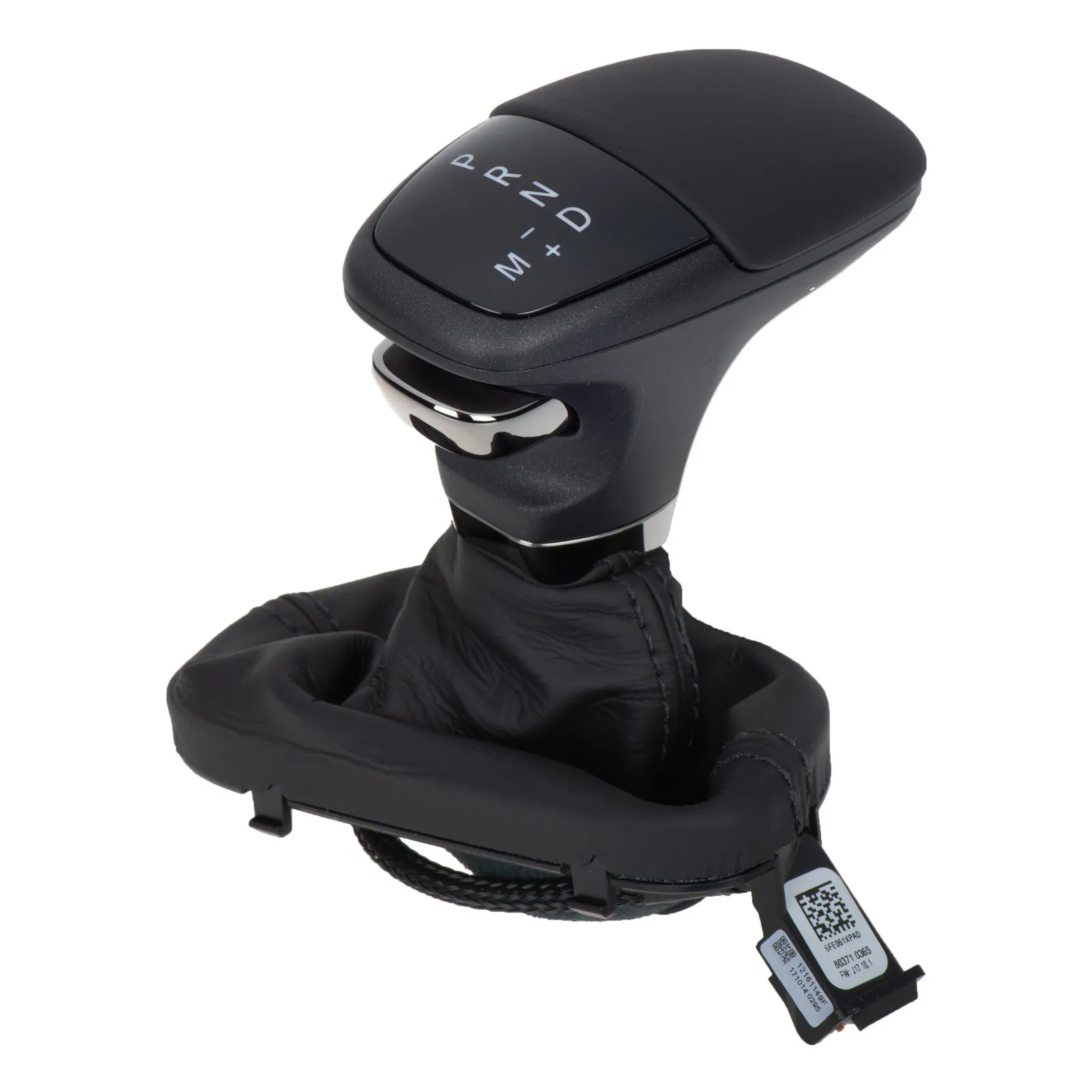

If I could find one for an affordable amount I'd get one. So far I can only find 2WD versions locally but have my eye out. Then the next PITA is that you have to use the shifter from the Charger/Challenger so I'd have to figure out how to make it work with the GR center console.
There is this shifter also.
https://www.kilduffmachine.com/store/p168/Kilduff_8PH70_/_8_speed_ZF_Shifter_for_swaps_#KIL8HP70.html
Fly by wire shifting... yee haww
So, in theory, a 4 pole toggle switch and an on-off-on momentary toggle switch could work.. If you're good at wiring that is... :ROFLMAO:
