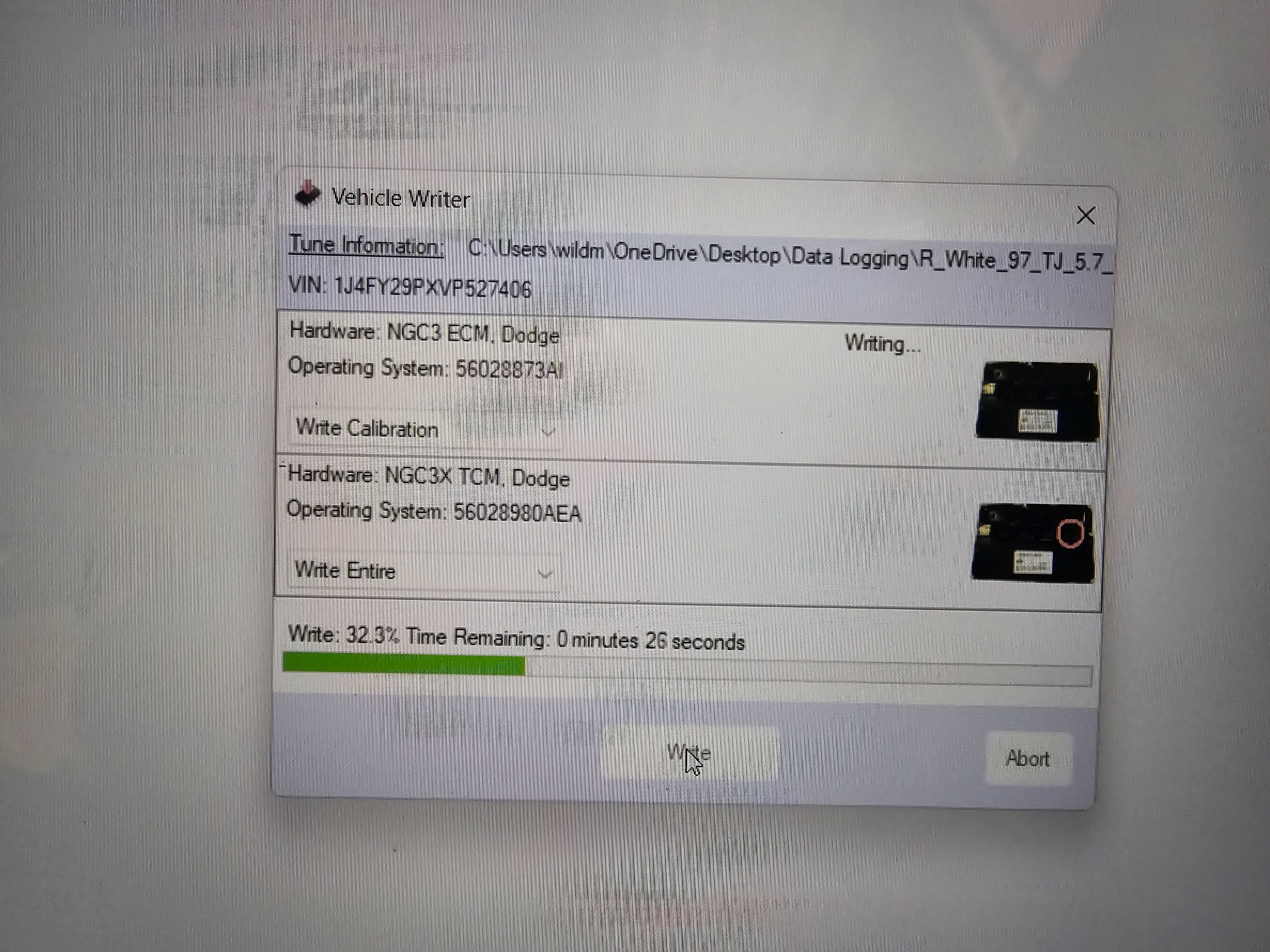

Ain’t this remote tuning stuff fun? Carbs are cool but tuned EFI is the shit.
It's a lot different than years ago.
But better than the old days of having to send your PCM off to be tuned and hoping it's right when you get it back.
