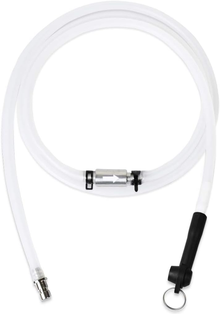

This hose is similar to what I used to have but it had a better fitting for the bleeder screw on the caliper.
And the hose wasn't as long. It was something I'd bought 30+ years ago and used it for many years. At this time it was a gimiky thing that most people didn't like.
I've got a GM/Chrysler style dual chamber master cylinder but with the PSC reservoir mount that adapters I'm seeing for it don't fit. I had to modify the one that came with that kit I just tried. But the bleeder was leaking out of the pump handle itself.
