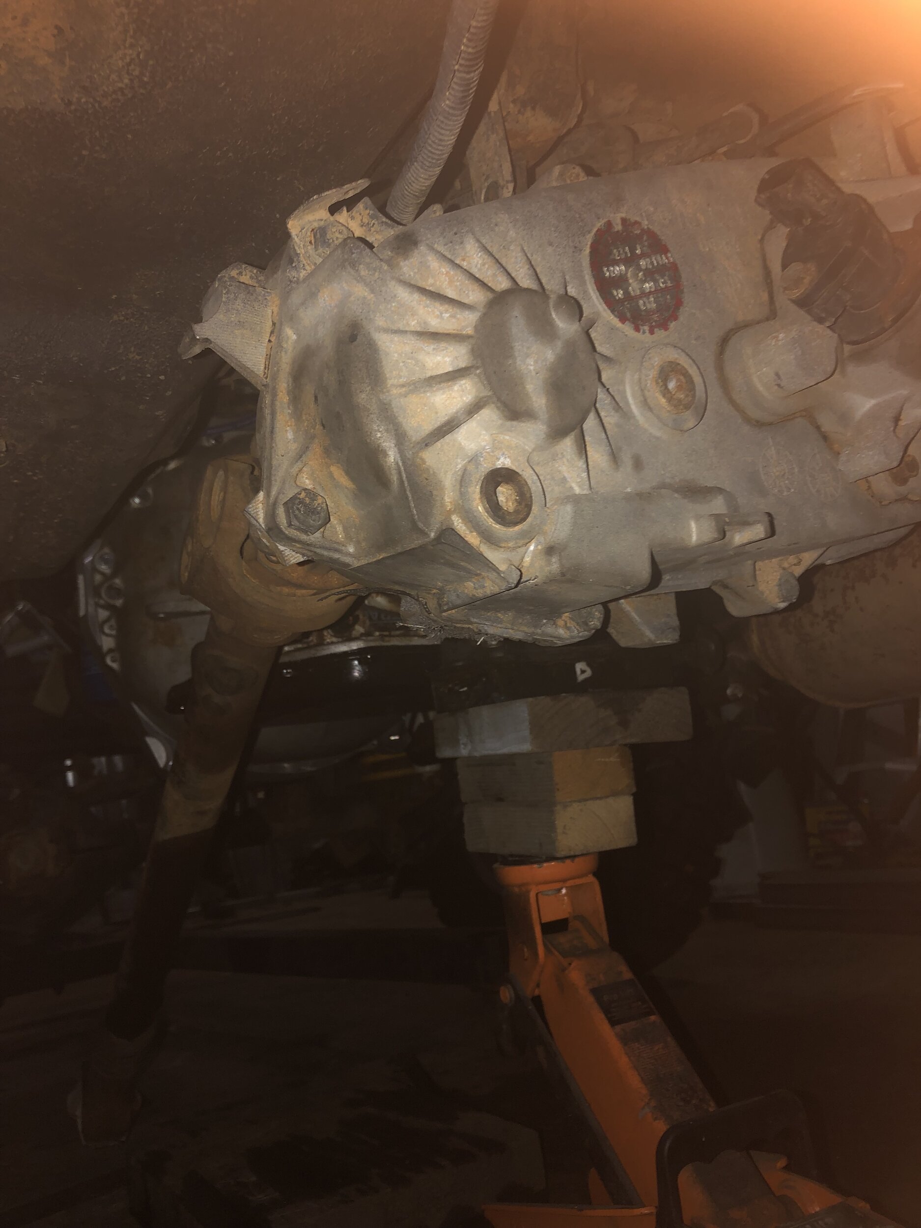

The Jeep 999 transmission was 1st used in 1980 behind the AMC 258 inline 6 motor. The 999 has stronger holding power versus the 904. This is due to the planetary gear stationary and double-wrap rear band. The 999 also uses more clutch packs and a larger planetary. This is obviously due to the increased torque capacity of the 4.0L engine. Overall, the 999 very capable behind the 258 and can handle most V8 applications. We have found the 999 was also used in rock buggies running heavy horse power V8 engines. Chris Durham is one competitor that ran an upgraded 999 transmission with a V8.
The 999 were used exclusively behind the Dana 300 transfer case in 1980-1986 CJ Jeeps. Later Wranglers would use the NP231 transfer case. Both of these transfer cases utilized the round circular 6 bolt pattern still in use today. The output shaft of the 999 always used a 23 spline shaft and a somewhat long transfer case adapter. Dana 300 transfer cases always had the front drive shaft located on the passenger side of the vehicle. Jeep Wrangler NP231 transfer cases always had the front drive shaft located on the driverside side of the vehicle. It should be noted that we have seen a rotational bolt pattern difference on the 6 bolt pattern on the rear of the Jeep Torqueflite transmissions. This could cause the transfer case to clock differently when using a Wrangler 999 on a Dana 300. Advance Adapters does offer a clocking ring/ longer input to correct the rotation. We sell this under part #50-8604
The Torqueflite 999 transmission used behind the 4.0 I-6 have a provision for the crank positioning sensor. The 999 transmissions found behind the standard 258 in the CJ jeeps will not have this provision.
The 999 is relatively short at 16.5" in over length; however, the tailhousing section adds an additional 6.125". This makes the Jeep 727 an overall length of 22.625".

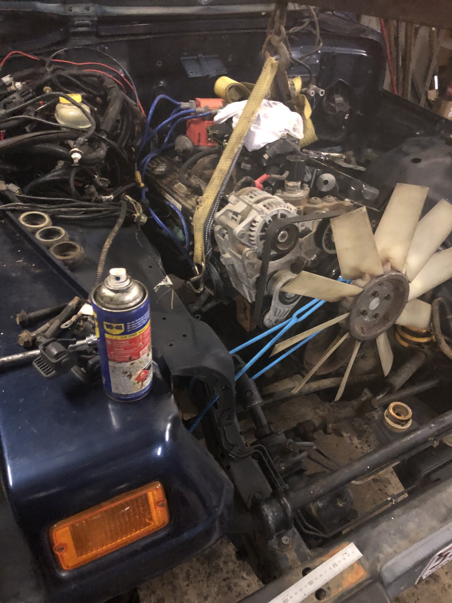

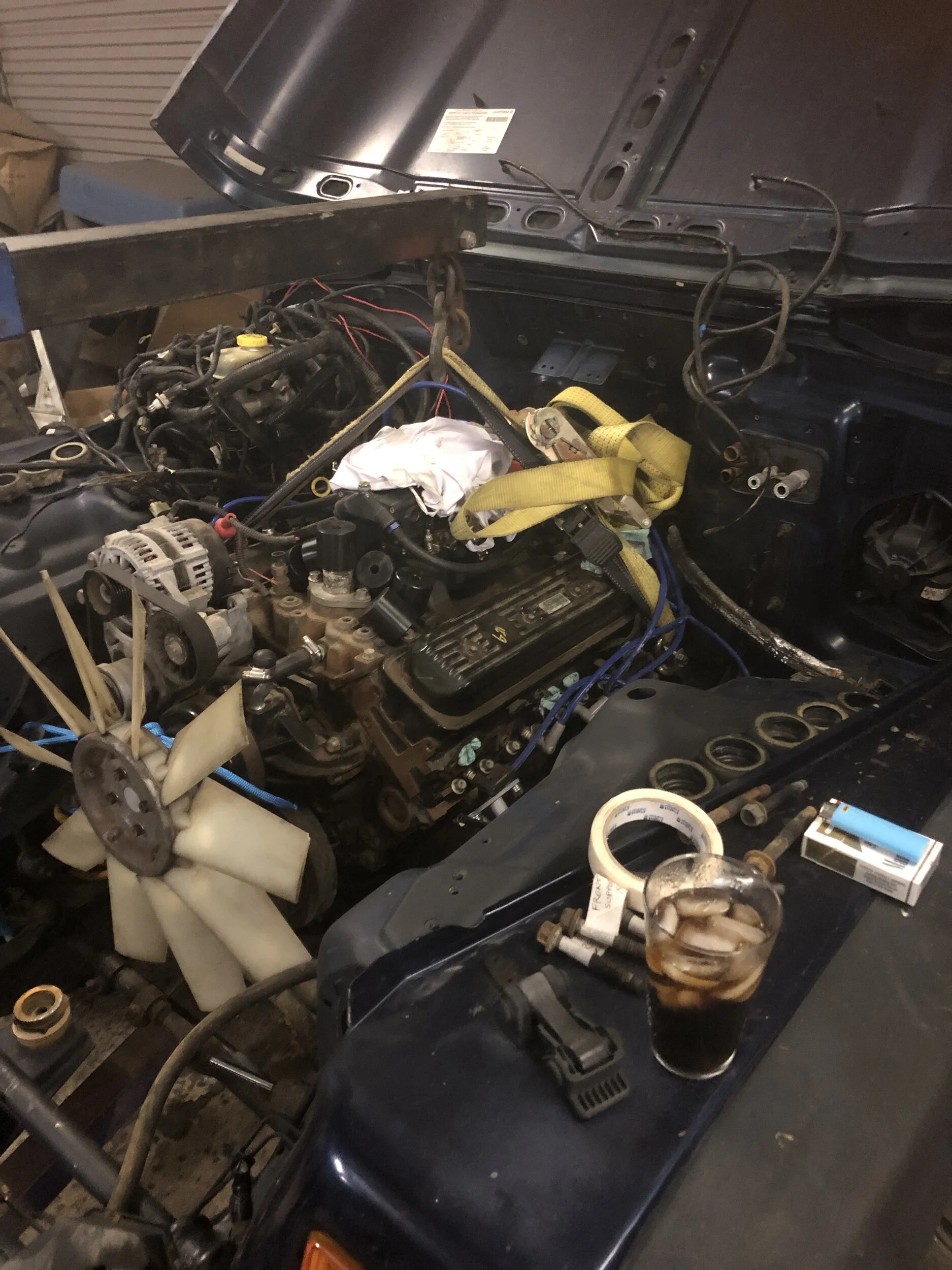

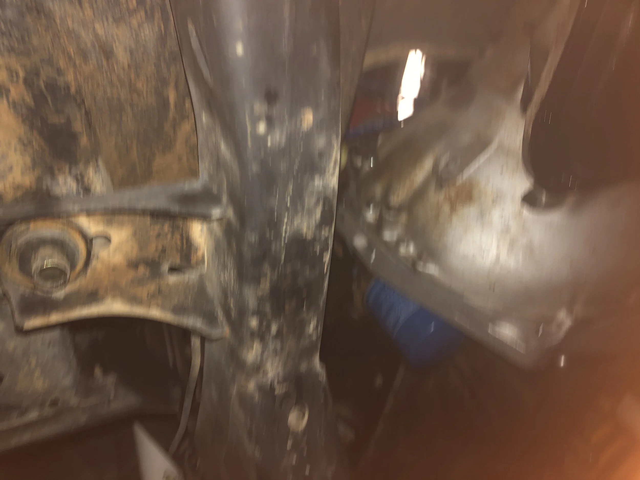

Cheers mate I sent AA an email about using the 350 they said it will be fine with 999 they also have given me a link for performance upgrades if I was going to doing extreme 4w driving with increased hp I can’t remember the company name but I have it so I will put it up for everyone else that’s thinking about this mod so far I’ve got the engine and gearbox box in I’ve worked it out so the gearbox is in it’s original place so no modifications to either tail shafts the engine still has good clearance from firewall and steering just waiting on a set of block huggers then I’ll bolt them on and fabricate a set of engine mounts there’s plenty of clearance for a good size radiator which you can get online to bolt straight in when I get a few of these things done I’ll do a full description of what I have done and what I used and we’re I got it from cheers
