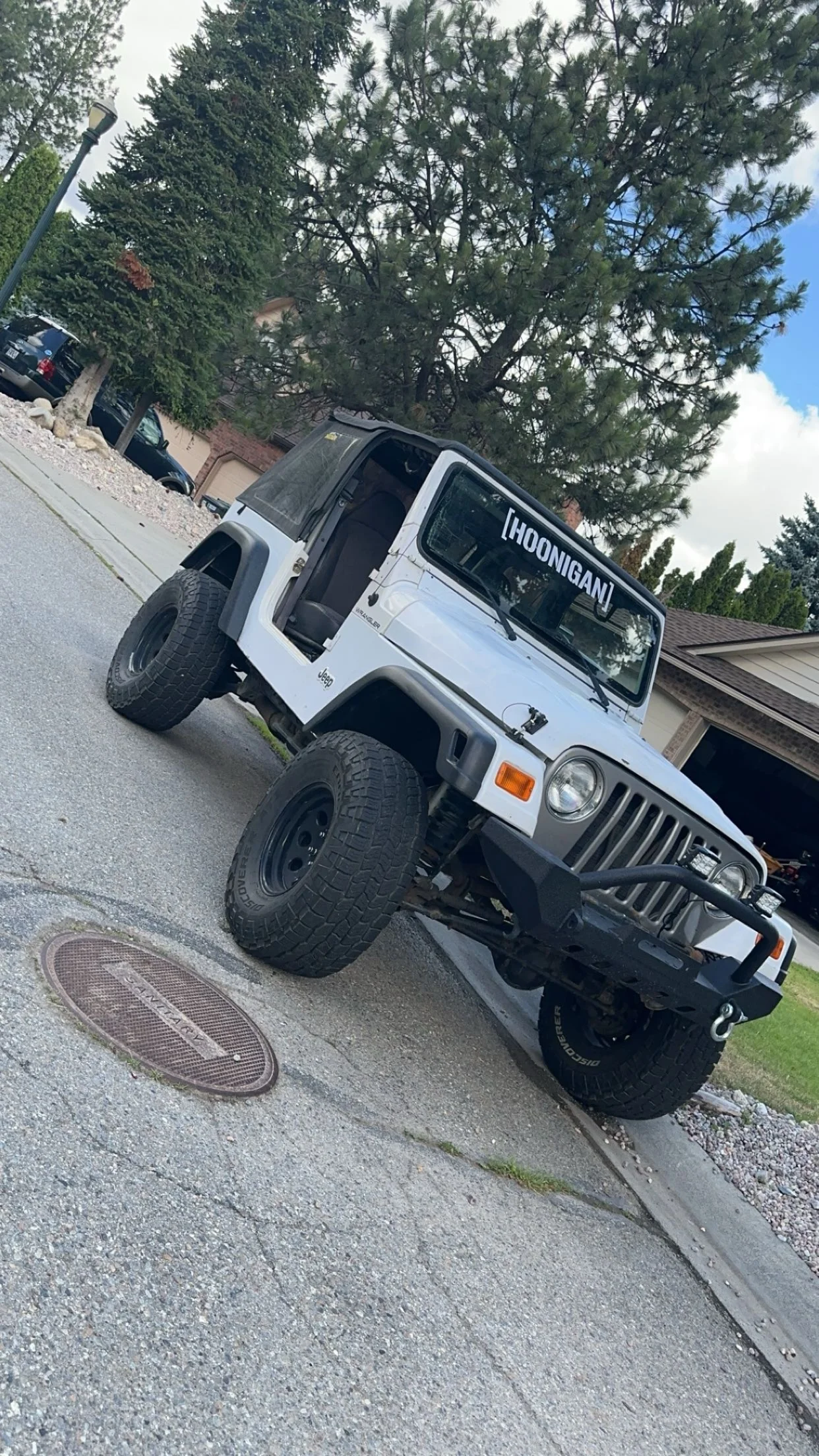

what setup you running in your jeep
and he the jeep if anybody curious

what kinda engine you got in yours
Long read: https://wranglertjforum.com/threads/wildmans-tj-is-getting-a-face-lift.19356/
I've got a Dodge Magnum 5.9 in mine with a stroker kit making it a 6.7 (408). Back in 1998 the Dodge Magnum was rated at 245 HP & 330 TQ but many say it was under rated back then.
