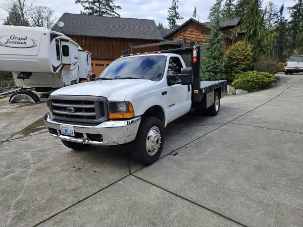

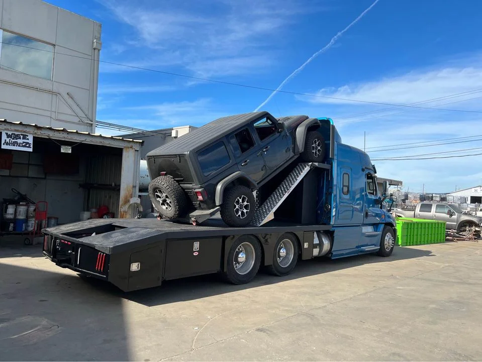

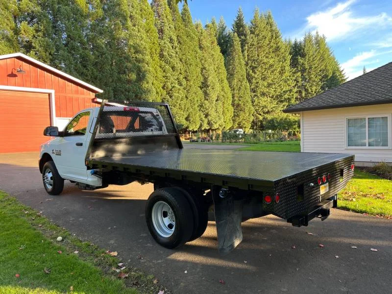

Here ya go. Haul your Jeep plus 1 or two more
