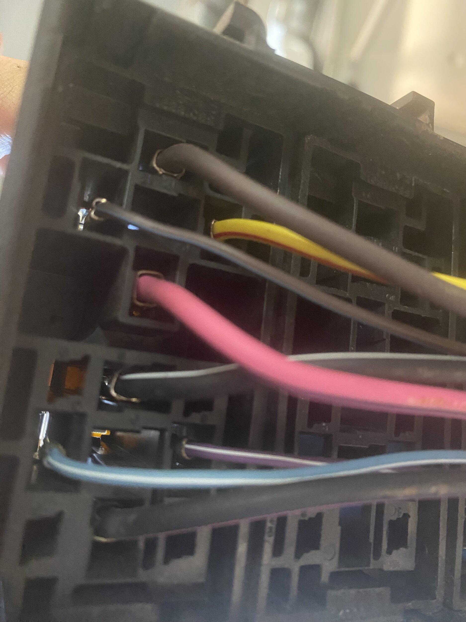

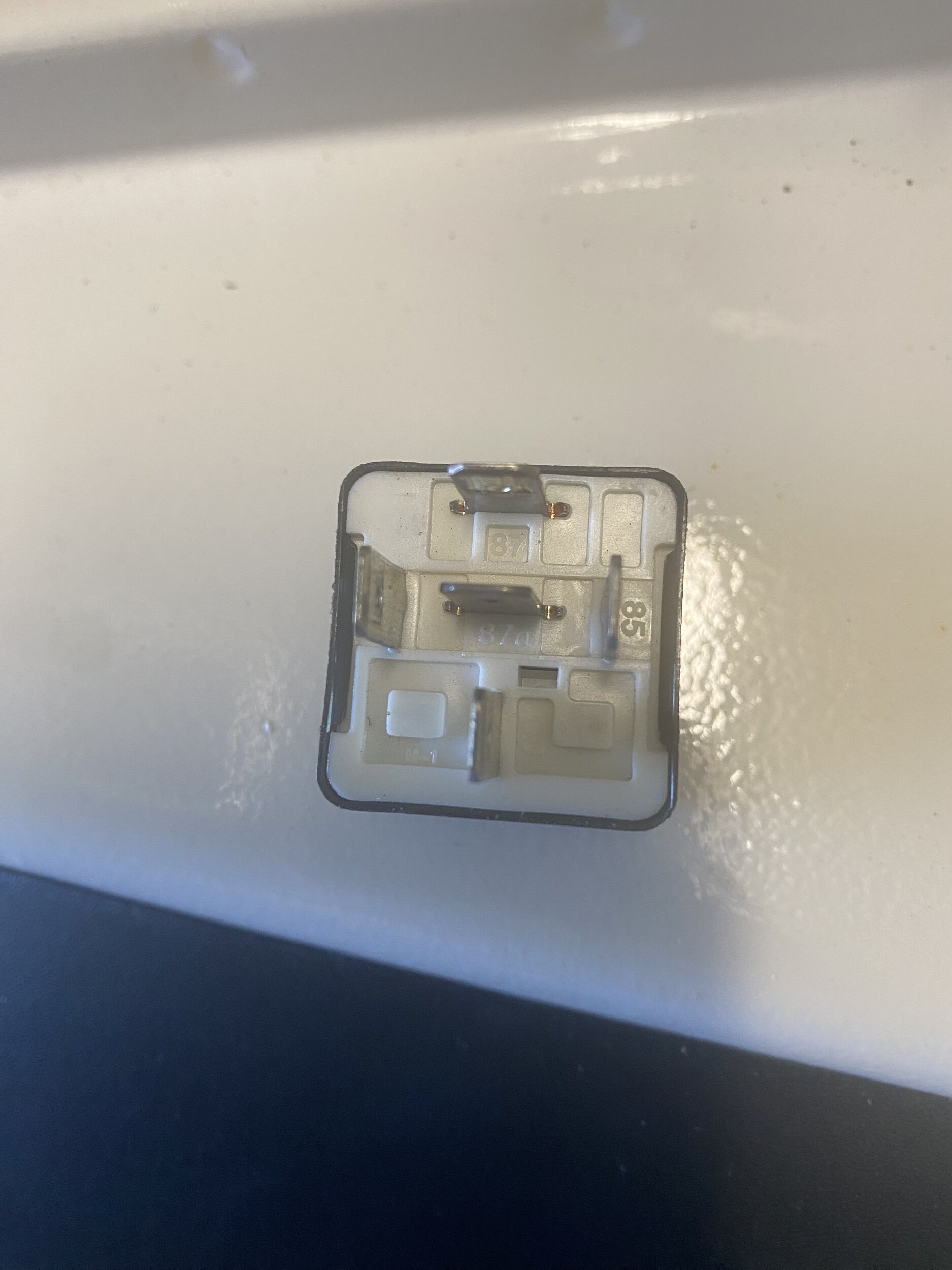

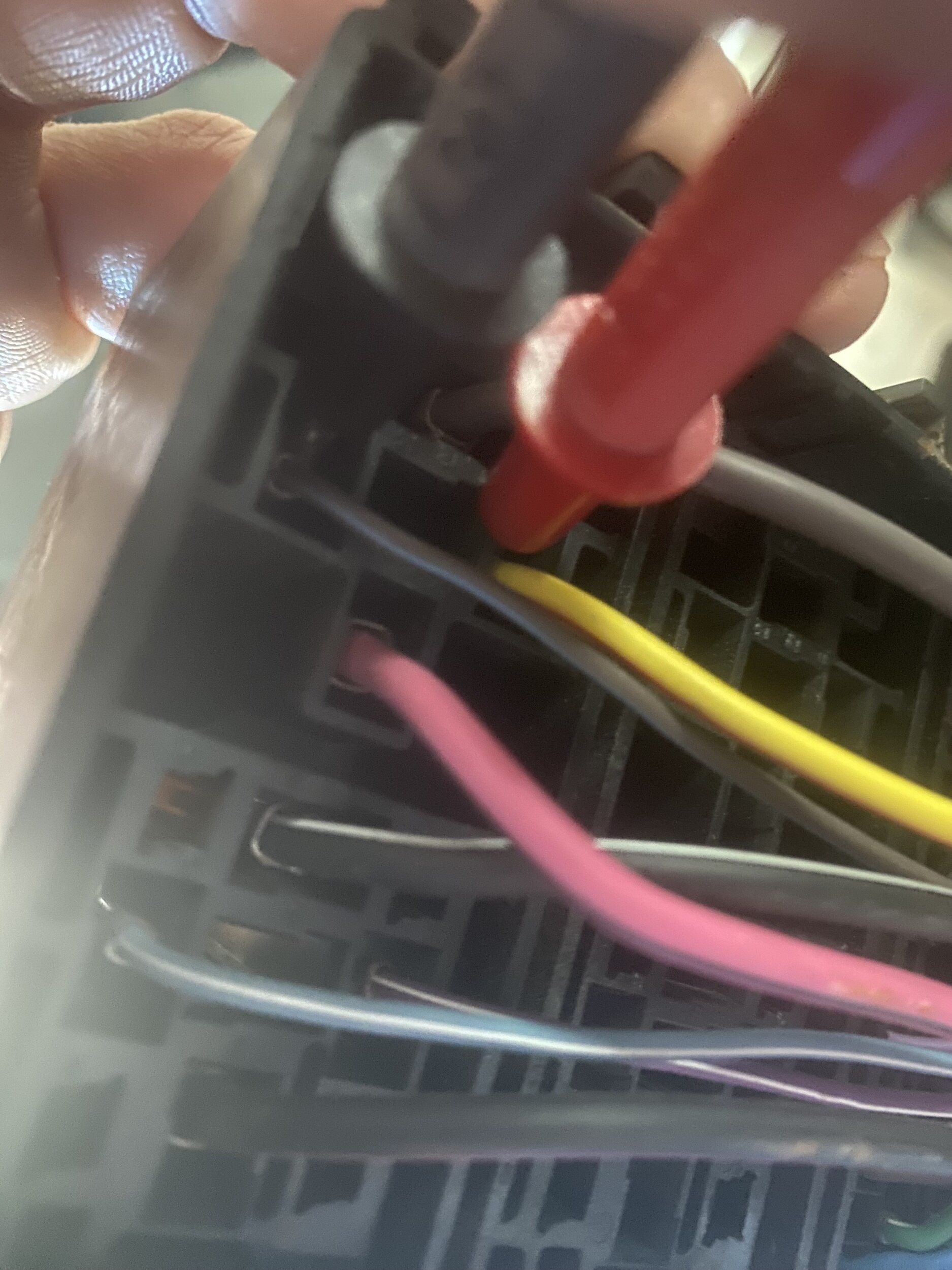

With each of the relays in hand, the resistance across 85 to 86 is 0.07 ohms, on both.

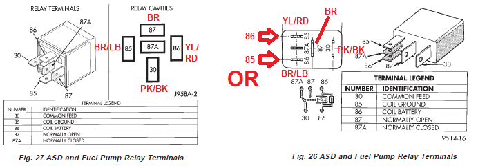

When you say jumper the battery negative to terminal 85, I'm not certain what you mean. On your first reply you have the relay diagram showing which color wires (typed in red) are for which terminal. However, on mine it is backwards.
Yours shows:
Terminal 85: BL/LB
Terminal 86: TL/RD
Mine is:
Terminal 85: YL/RD
Terminal 86: BL/LB
I want to make sure I'm jumping the right wire from the negative side of the battery.
Edited to add pictures. You can see that terminal 85 will be on the left side once installed. That will push it into the cavity with the YL/RD wire. Why doesn't that align to what you have and what the service manual says? I definitely didn't go pulling wires out of this thing. The PDC came out as one unit and I bolted it directly onto the new fender.

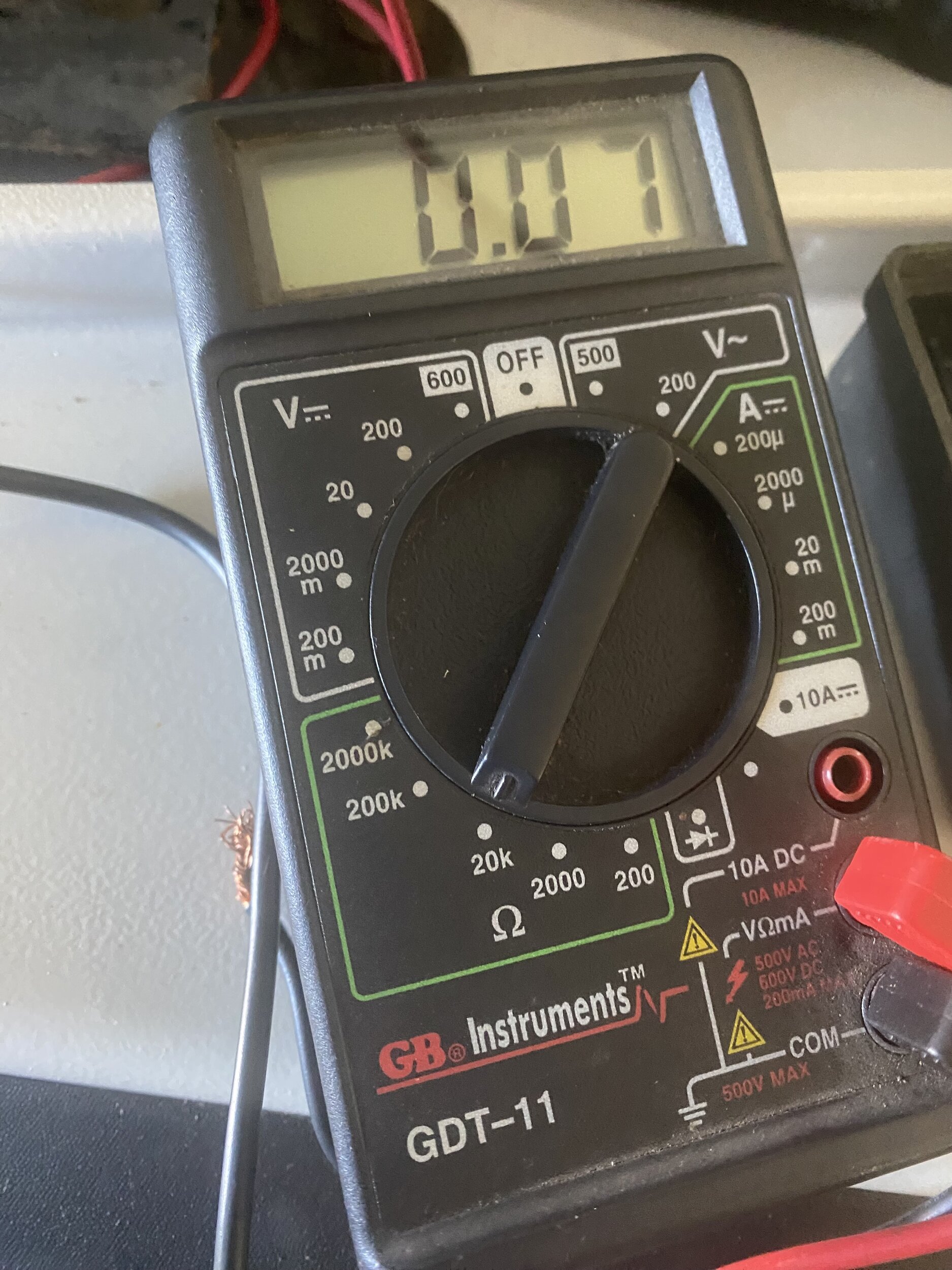

That can't be right. At that resistance, the coils would draw 171 amps at 12V. They should be several ohms. Are you sure you've identified the terminals correctly? Also, those relays may have a diode in parallel with the coil (to eliminate voltage spikes when the magnetic field collapses). Try re-doing the test and swap leads to see if you get a different reading with your red lead on one terminal or the other.

Yes, it's good that you asked, first. Jumping the wrong one will result in a short. The wire colors should be the correct way. I added the wire color notes to the relay drawings based upon the tables alongside them. Both say Terminal 85 is coil ground. It's entirely possible that they copied and pasted that and didn't check. I'd say BR/LB is the ground, based on the schematic. However, just to be sure, what resistance do you get when you go from the BR/LB terminal to Battery Negative? If that is less than 0.1 ohm, then we're back to head-scratching because that means the coil has ground.

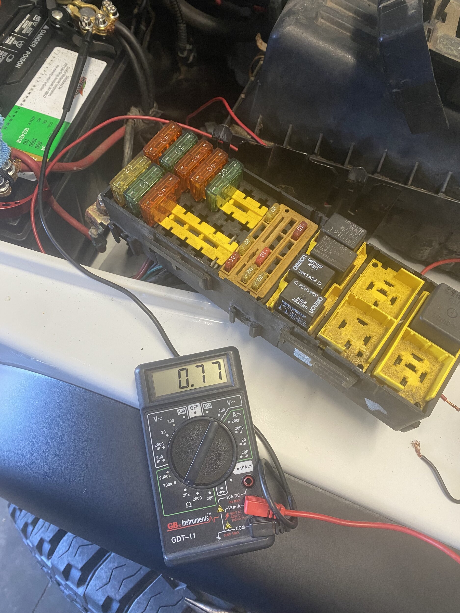

The resistance from the BR/LB wire is the 0.77 that I mentioned previously. I did that test based on wire color, not terminal. To be sure I just tested it again and it was 0.76.
As for the relay resistance across 85/86, I just tested it again and I'll add pictures below. With the leads swapped, I got the same 0.07 each way.
OK. So then I'm back to the coil ground problem theory. Jumper from BR/LB to Battery Negative and try to start it. Gotta go to my first meeting...
