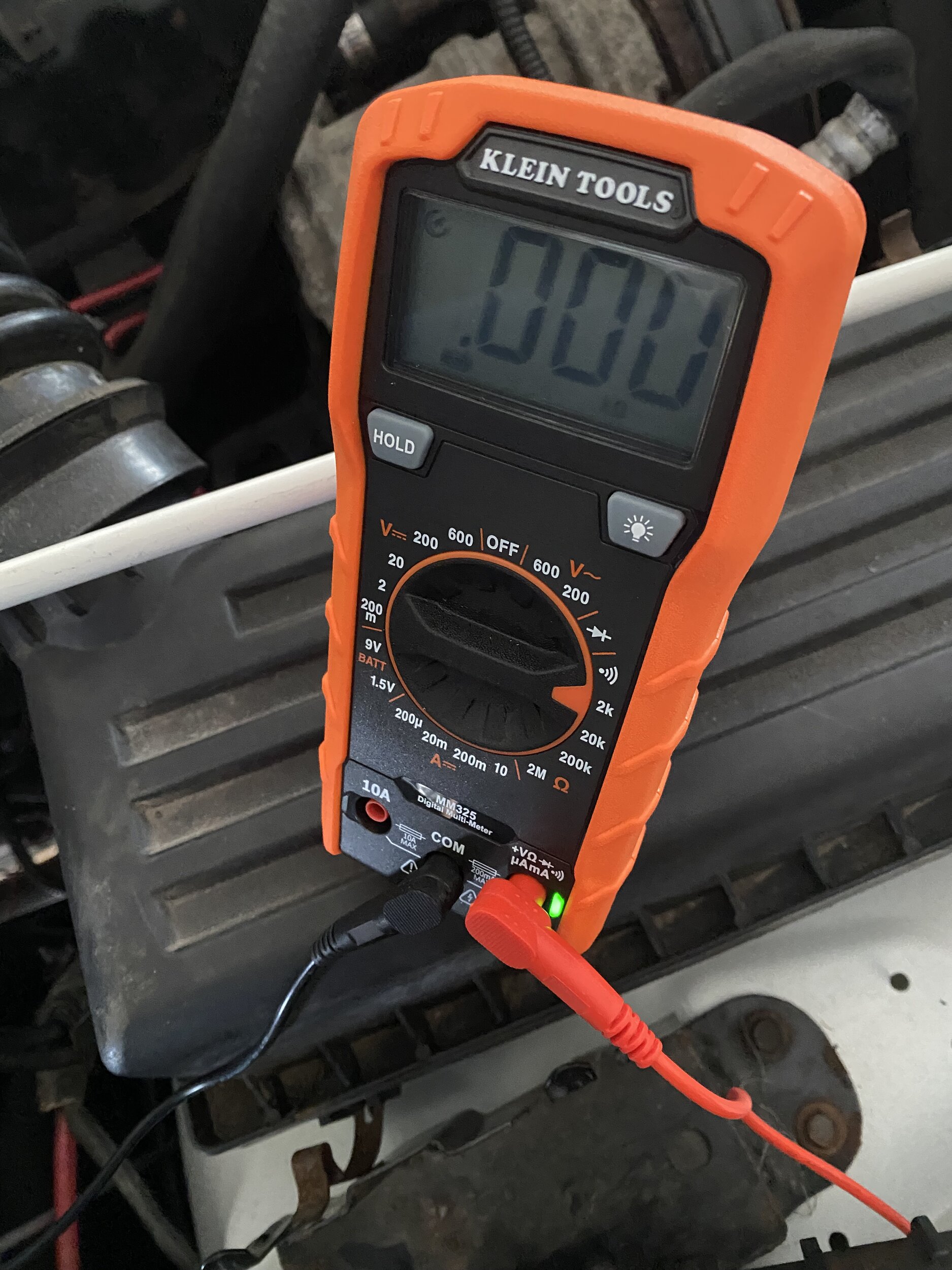

Results:
- G105 to the BR/LB wire on the back of the PDC: 0.00 ohms
- G105 to battery negative post (as requested earlier): 0.00 ohms
- Battery negative post to BR/LB wire on the back of the PDC: 0.00 ohms. (audible beep to confirm a circuit) - Edited to add
I confirmed there is a circuit being tested by using the audible beep setting. So the 0.00 ohms is accurate, I believe.

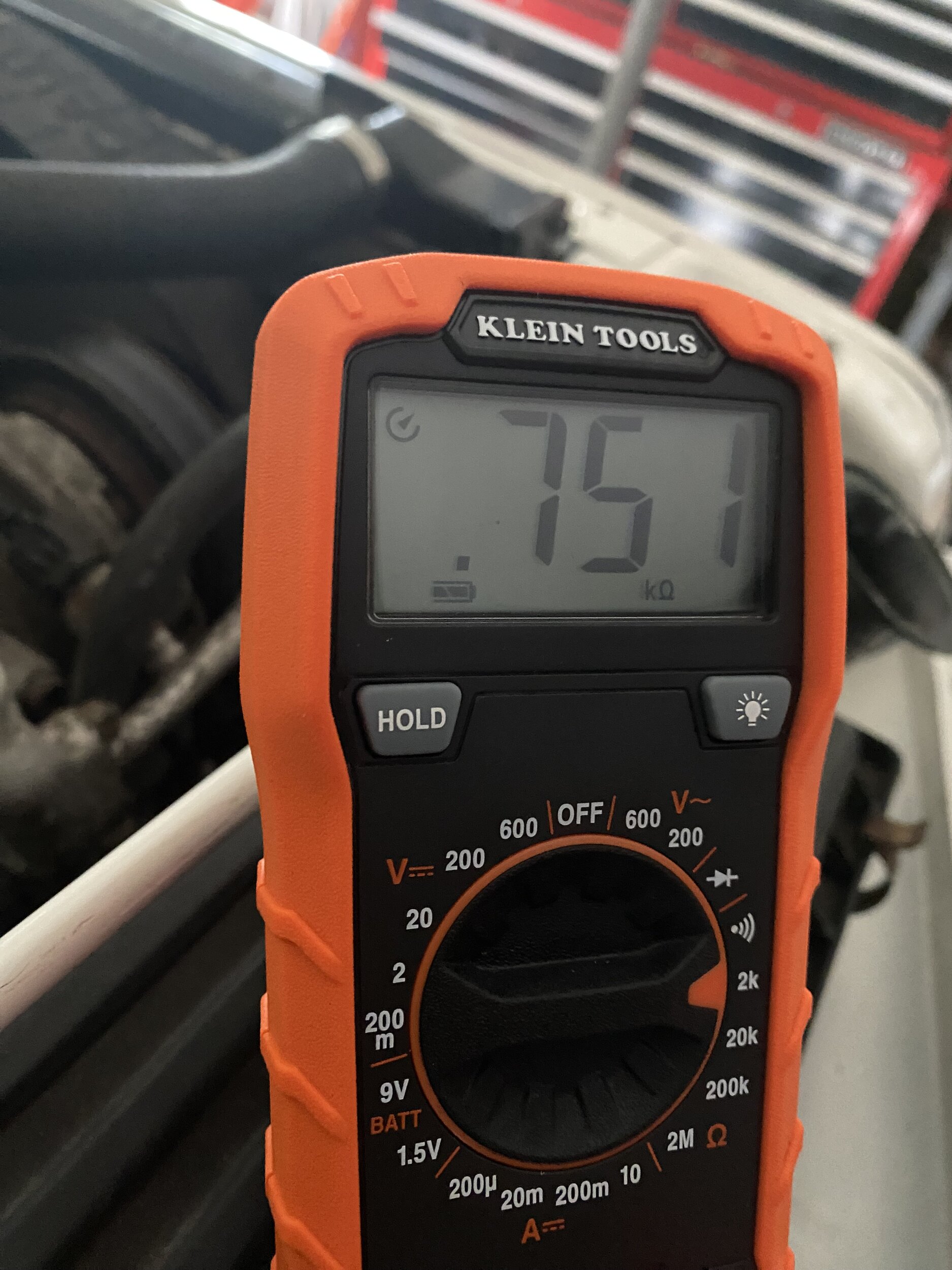

I tested the circuit with the C154 harness unplugged. It read 751 ohms.
If I am understanding everything correctly so far (that could be wishful thinking at this point), this is a perfect circuit now with the black ground wire reattached at the transmission jumper. There is no resistance from what I am seeing.

Results:
That audible beep function is commonly called the continuity setting. Looks like all this time your meter was leading us astray! Man-o-man..,
By "the circuit," do you mean you put one probe on C154 Pin 1 and the other on C154 Pin 3 with C154 unplugged. If so, I guess it's time to switch back to the didactic method. Nobody has responded, and there's a very important lesson there. By the way (again assuming I'm interpreting "the circuit" correctly) - stop checking that! You'll see why shortly.

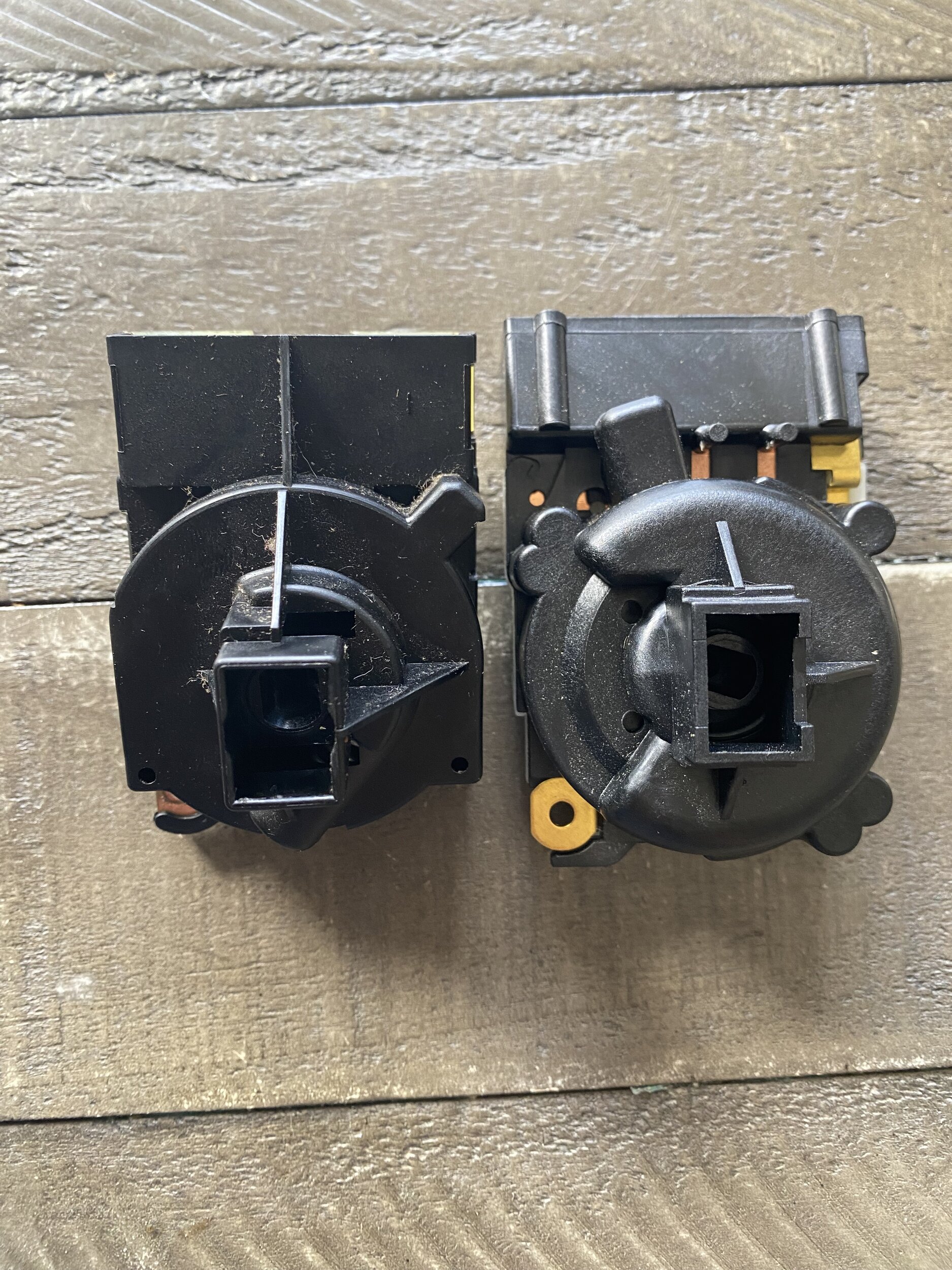

I'm still scratching my head here. Some very odd behavior. Some of your symptoms match what happens when the ignition switch is bad (they usually fail intermittently, from what I've seen on the forum, and how mine failed.) Other symptoms still look like a bad ground or other connection.

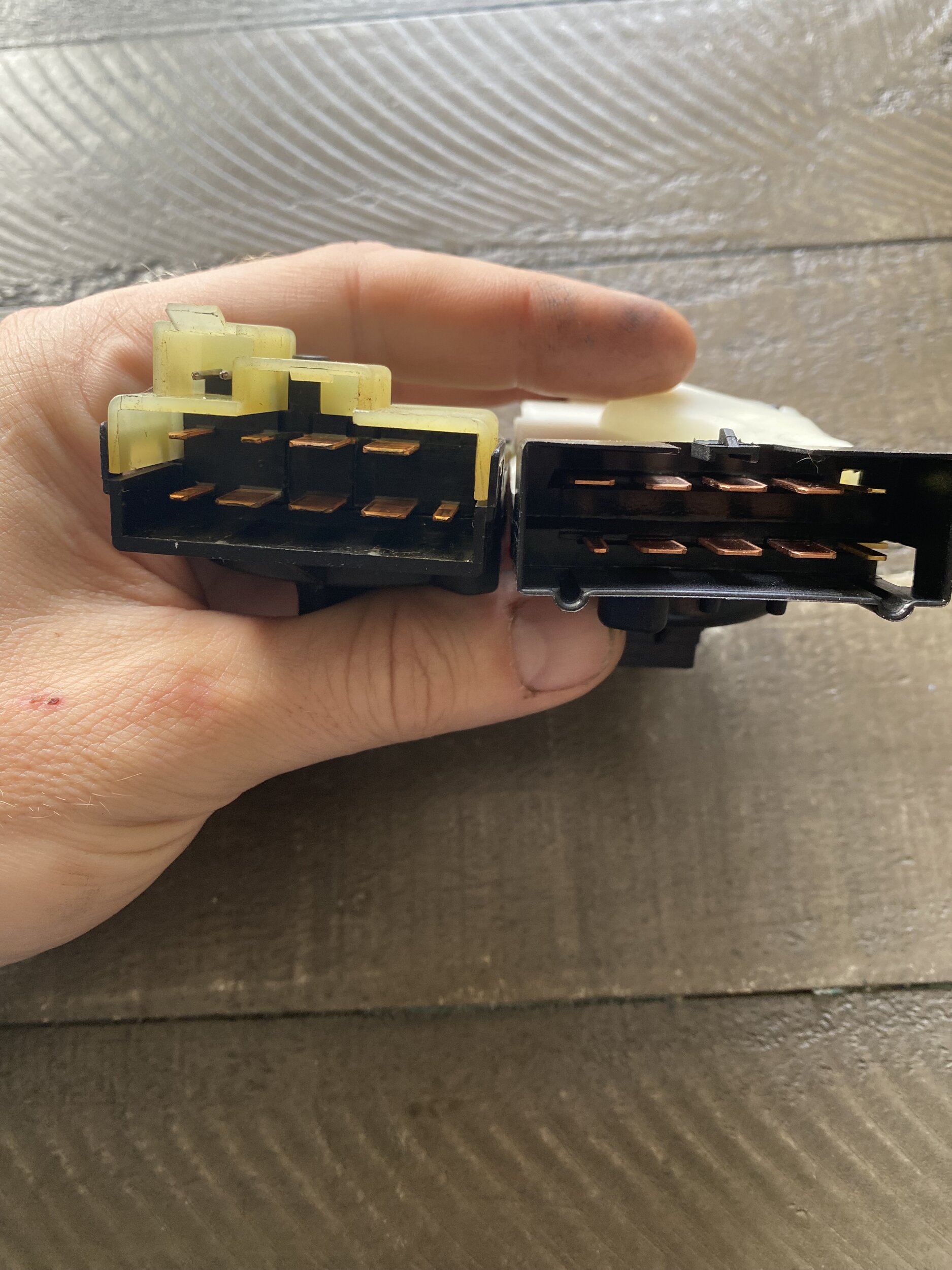

Or I guess I won’t be replacing the switch. The one I waited a long time for isn’t even close to being correct.

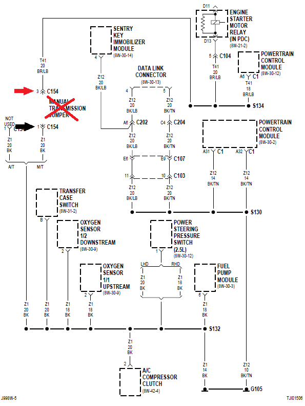

Back to my question. Trying to stay with the Socratic method, but it's tough for me. Think about what you were measuring when you put your meter probes on Pins 1 and 3 with C154 unplugged. With it unplugged, the Manual Transmission Jumper, which is the black loop on the mating connector, is missing. So, this is what the wiring circuit looks like with that jumper removed, and your probes at pins 1 and 3 (shown by the red and black arrows):
Looking at that schematic, what are the probes measuring? Anyone? Bueller, Bueller? (that economics teacher was definitely Socratic, too!)
Ok, it's time to discuss this post. Not a soul has responded, and of everything in this thread, I think this is the most advanced concept to understand, but it's also a very important concept. So, let me put this Socratic ball cap down, and put my didactic cowboy hat (my preferred head wear) back on...
A multimeter, when measuring resistance, applies a small voltage across the leads, the meter measures the resulting current and uses ohms law (Voltage = Current x Resistance, or V=IR) to determine the resistance, and that resistance is displayed on the meter's display. If there is no connection between the two points being measured, it's an open circuit with infinite resistance - current will not flow. In that case, the display will read something indicating open circuit (meters vary on what they display).
So, knowing that, is there a complete circuit to be measured with the probes at Pins 1 and 3 on C154? At first glance, I think most people's instinct is to say, "no, there is not - it's an open circuit. If you start at Pin 1 and follow the wires, you can't end up at Pin 3." There's no loop, right?
Well, no, not right. Yes, you do need a loop. However, there are actually many loops there, you just can't see them. Every one of those dashed boxes is a component - this schematic is incomplete. It doesn't show the other connections to those dashed boxes. Even G105 has more going on (it's not the dead end it looks to be), and that's key to understanding what you're measuring in the schematic above.
If you've been following along, you may recall that G107 is another ring eye on the same bolt to which G105's ring eye is attached. The other end of G107's cable is at the negative post on the battery. So, if you continue from G105, now off the schematic, you go directly to G107 and then from G107 to the negative post on the battery through that larger gauge main engine ground cable. Then, you continue through the battery from the negative post to the cathode plates, through the acid to the anode plates, and finally to the positive post. Still not a circuit though, right? How do we get from the battery's positive post to Pin 3 to complete the circuit we're measuring?
Through all of those dashed components, of course! Every one of them needs a complete circuit to operate, after all. Since we're doing our tests mainly with the ignition off, some of those components are open-circuit and not contributing. Others, however, are very complicated devices (like the PCM), or have their own "black boxes" on the positive sides of the dashed boxes above (like the oxygen sensors), and I have no idea what's inside those devices.
It's all these circuits that combine to make one very big, very complicated circuit, and I wouldn't even attempt to guess what resistance value to detect when testing as shown above. In fact, I would venture to guess that nobody in the world could tell you that without hours and hours of research. And that is why testing resistance as shown above doesn't really help us. Who knows what the value should be?

- The ignition switch is starting to go bad. When Sab had me ground the starter relay to the negative post of the battery, I was able to turn the Jeep on with the ignition. Sometime between that point in time and the next time I tried starting it with the ground wire fixed, without touching anything in the ignition, the switch was malfunctioning. Removing it and turning it with a screwdriver allowed it to start right up. I then reinstalled it and it is working again (new switch is here and I will replace it if it continues to act up). This unknown issue made it more difficult to track down as it started perfectly once and then not at all the next 40+ times.
