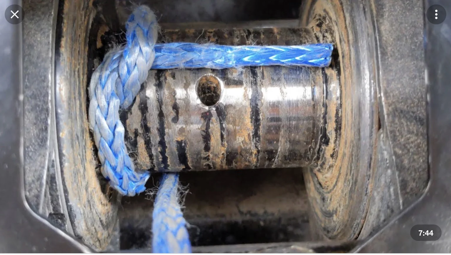

2-There are lots of ways to anchor line to the winch drum, how many understand that the style with the small screw into the side of the drum actually does NOT anchor the line?
3-How many are okay with the slip knot and over wrapped tail style of anchoring?

2) I understand the small screw attaching my rope is not an anchor and it bothers me every time I use my winch. I know the attachment point is just to provide tension and the friction of the line is what anchors the line. I am looking for a good way to secure my line.
3) I would like to see a picture of this style, I like the idea of wrapping the line over the tail. TRE shows something like that on their website but they use a bracket which could damage the line.

That seems to be the most practical for any winch that does not have an in drum anchoring system.

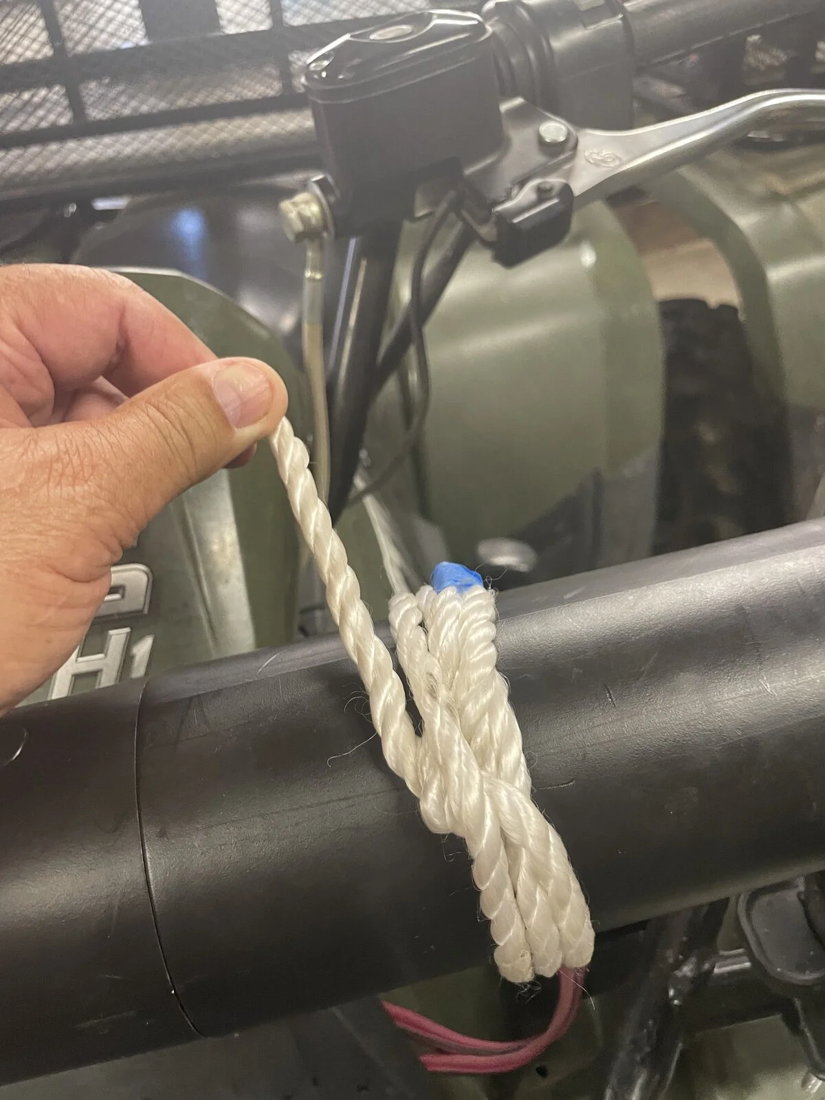

On the synthetic line I put on my quads winch, I used an eye spliced on the end of the rope with a clove hitch around the drum and an extra hitch over the eye after I ran the line through the eye. It can’t come off and it is a low laying friction knot around the drum. It cant come off the drum.
The knot looks like this; (demonstrated with rope, not a synthetic winch line)
A clove hitch is a great knot. Just make sure you have the working end oriented the right way to keep it in line with the correct rotation of the drum. Can't believe it never crossed my mind to use that knot with as much as we use it at work.
Yep, we use it in rigging operations all the time as well.
