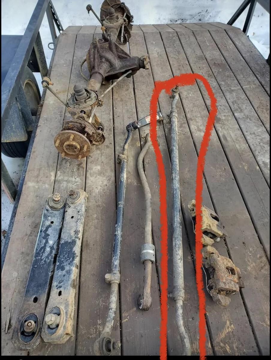

Can someone confirm by looking at this picture if this the the correct tie rod?Apparently it has good ends on it $20 for the entire setup. Guy is unsure if it’s off a v8 grand Cherokee.
Lol, am I not seeing something? The item circled has the ball joint end just like your pic above.
the lower portion is cut off in the picture so we can’t see but it looks like another threaded tie rod end/ball joint goesthere.
The drag link (part attached to the pitman arm) should have a tapered joint in it about 2/3rds down from the the pitman arm. That's where our (stock) tie-rod connects. The tie-rod itself (part circled) may be the same part, but it looks to me like the ends are longer than stock. If they came from the same vehicle they would connect at the passenger side knuckle? a different style of steering.
I'm no expert - most of what I know about this came from some of the older threads here - @Chris called ours Hindenbergen or something...
