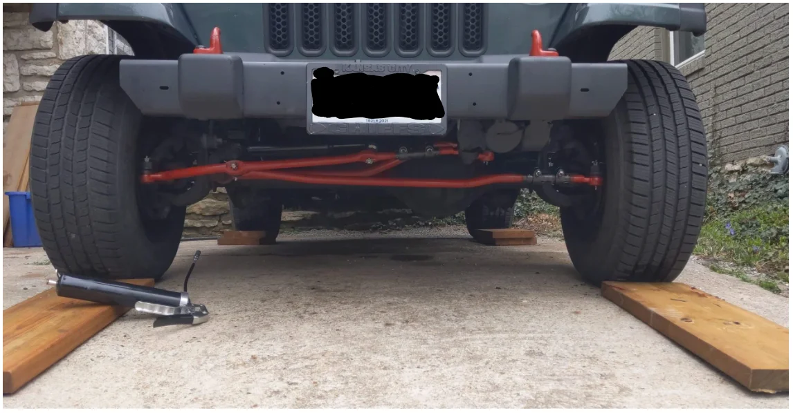

I'm 95% of the way done with this but am stuck on one small piece - I cannot for the life of me get the final grease zerk to thread into the TRE at the passenger side. It just won't catch - should I just go get another one? It came with the Moog parts I ordered.
Also having trouble getting the other zerks to accept grease but I always have that problem, my gun is shitty and slippery as all heck so it's a chore to force the coupler onto the zerk with sufficient pressure that it actually feeds the grease.
All in all, looks pretty good and was a fairly straightforward install. I'm sure my measurements are WAY off and the steering wheel is a bit crooked but I'm getting an alignment after some other suspension work so should be OK. Won't matter if I can't get this zerk tho..
Just wrapped mine up yesterday. I had a couple of the zerks go in wonky at first but was able to get them in eventually. If the threads on the zerk look OK and the plate it threads into isn't bent, keep trying. Try turning the zerk counter-clockwise until you can feel its thread drop in to the plate. On a couple of mine, they threaded in at a slight angle at first and then they leveled out once I started wrenching them in.

Yeah I likewise had one go in awkward - I'll try that. Ha, I also do the reverse thread trick by default now, one of the handiest simple things I ever learned. I'm with you on the gun, I've about had it - wish I had a pneumatic

It worked out fine. I just stopped by O'reilly's and picked up a pack of assorted fittings. Got one of those on right away, greased it and dropped it off at shop for upper control arms and alignment. Came out pretty well.
So I've been driving it for a couple days now - this is with the ZJ steering, new upper control arms (stock Crown replacements) and a fresh alignment. It's mostly FANTASTIC and definitely an upgrade over the worn out components I replaced.
