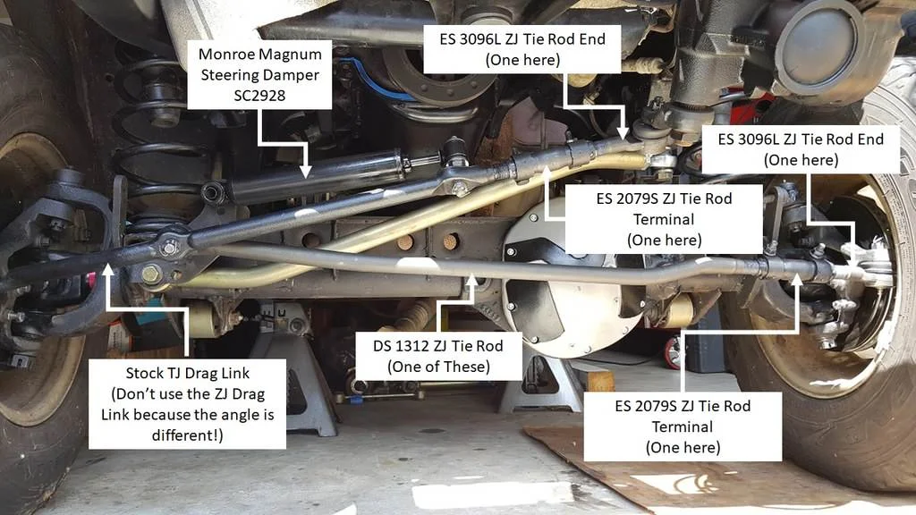

I'm not sure if this is useful or not, but after doing a dozen or more of these for myself and others, I put this picture together for people in a local club to use.

When doing this upgrade, if I Order all the parts Chris mentioned, wouldn’t I still need an additional inner tie rod to attach to the pitman arm?
A lot of people on this thread are reusing their old adjusting sleeve and tie rod attached to the pitman arm. Chris’s parts list makes that assumption.

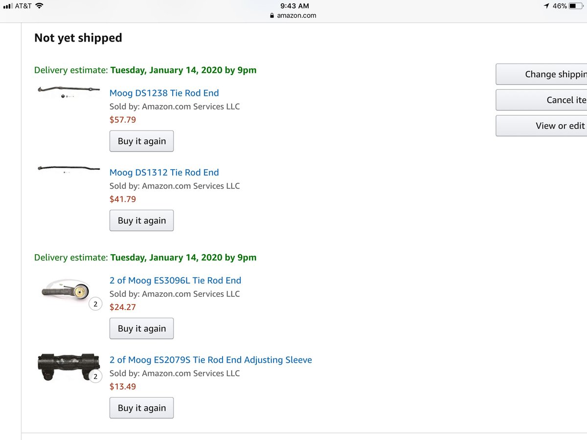

refer to thispicture
Probably a dumb question , but where does the part number 3095R go ? I have read this whole thread,studied the pics posted and just dont see it. I want to do a total refresh ordering part numbers suggested, do I need the 3095R part ?
3095R is not needed if you go with the ZJ Tie rod upgrade. The ZJ tie rod has the TRE built into it.

The picture I provided is the correct list of parts. Some people re-use their terminal or adjuster sleeve (ES2079s) , but for $13 it's not worth the hassle. Just make sure you coat them with anti-sieze during the install. This makes adjusting them later super easy.

I'm about to do this, and am still confused about this (sorry to beat the dead horse!).
I believe that the Moog ES3095R is the replacement passenger side tie rod end if you're re-using your TJ drag link? It's my understanding that the ZJ drag link's damper mount hole is at a different angle and can lead to interference with some aftermarket track bars (though some have no issues with that).
Since the ZJ drag link is the same strength as the TJ one, why not re-use it and just replace both tie rod ends and save the extra cash?
