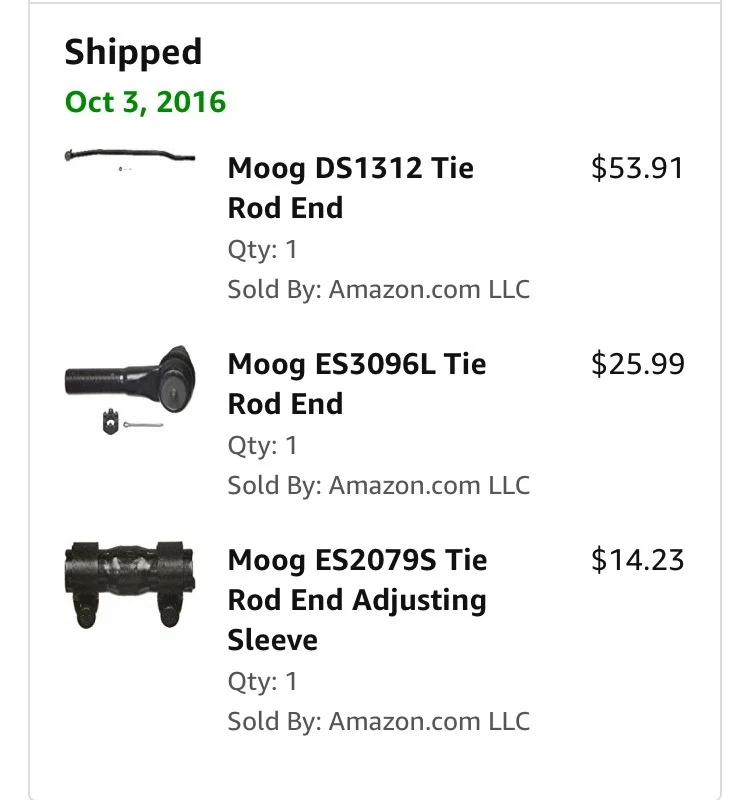

ES3095R Tie Rod End (x1)
ES3096L Tie Rod End (x2)
ES2079S Adjusting Sleeve (x1)
DS1312 Tie Rod End (which is your Tie Rod) (x1)
DS1430 Tie Rod End (which is your Drag Link) (x1)
Steering Stabilizer of your Choice
