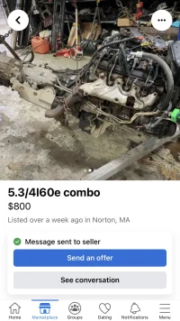

I think its finally time to write this thread as my 5.3 ls swap is in full swing now. I am a 20 year old with poor money managment skills and a jeep, this is my first ever project of this size so if I make mistakes please feel free to correct me I am here to learn and to help others who plan on taking on this swap. The jeep was a 2003 2.4L with nv1500 5 speed transmission. The engine is a 2004 5.3L ls out of a Silverado.
If anyone has any questions or advise feel free to ask. I will upload a spreadsheet of the cost at the end my goal is to keep it under 5k. I will try to keep this thread as up to date and accurate as possible.
