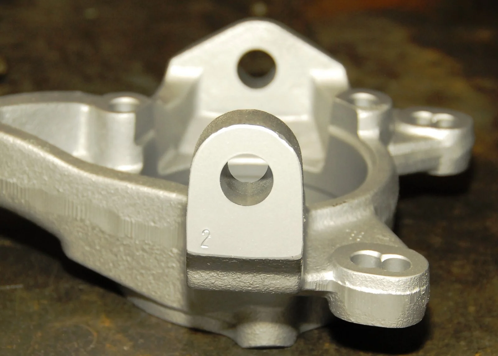

Ours are run on a big CNC mill. That isn't the problem. The problem is understanding the process, what to pay attention to and how to fix the issues when they arise. If you don't know what causes the problems or that they are even problems, then you don't know how to fix them.
New aftermarket is iffy at best. They don't control the patterns very well and get a lot of pattern shift when they cast so they wind up fairly messed up because they don't fixture the same part to part.
Some of the Crown parts we tried to use were just terrible. They don't understand the end result they were trying to accomplish so they didn't know how to QC them with an eye on the final result.

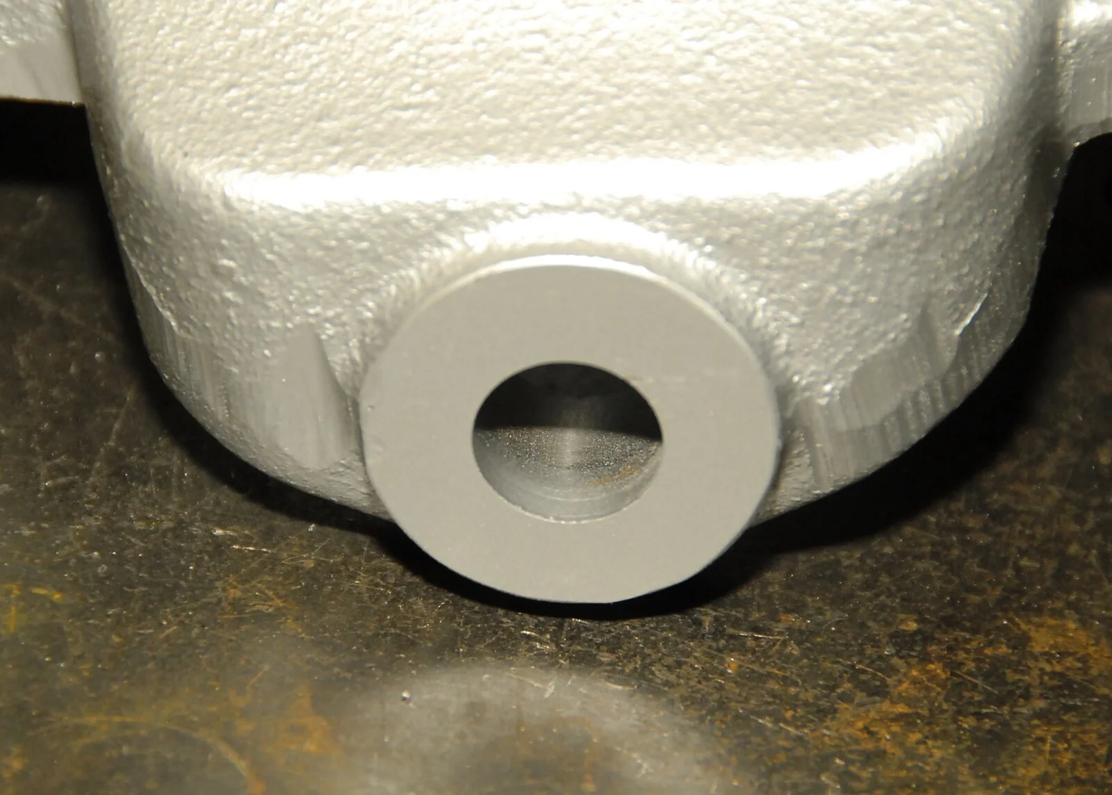

This is one of the issues we ran into that was very common. The alignment axis of the lower ball joint hole is supposed to be on center with the axis of the upper. That is a correct taper reamer shoved in the lower hole to show where it points. Rusty is OEM, other is Crown.
In the last pic, note that the reamer shows the hole slightly offset to the right side. That brings the lower support rib into contact with the side of the lower part of the OEM inner C and limits full rotation of the knuckle on the

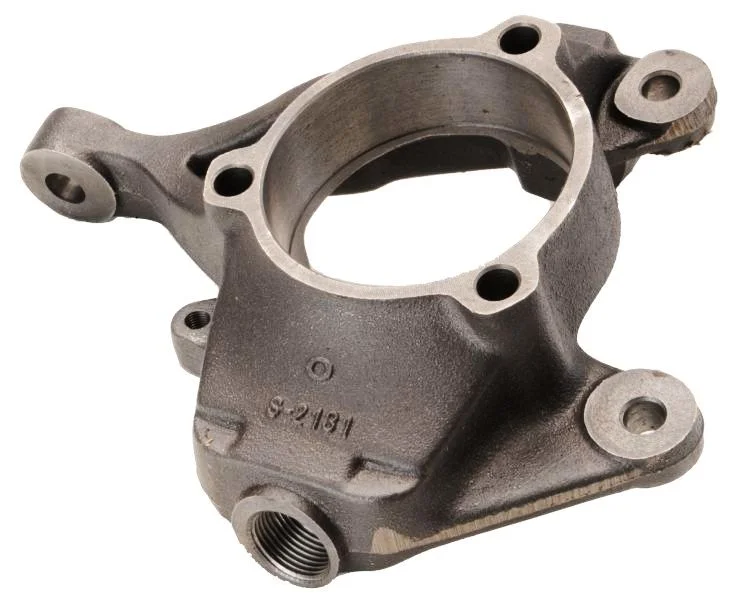

It is and it doesn't stop there. This is a pic taken from their ads. They have zero shame.
One of our competitors is using that knuckle to build their brake kits on.
This is it in real life.

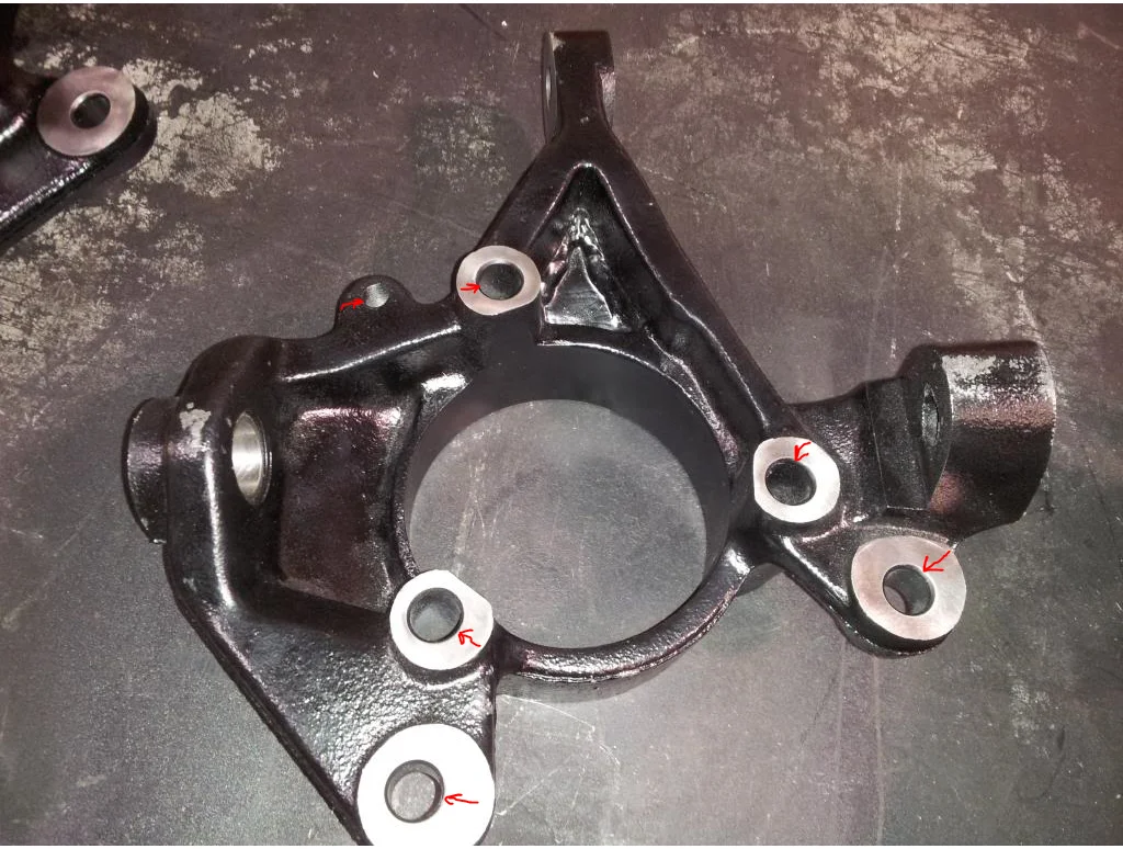

In the below pic, the arrows show the direction one half of the mold pattern shifted. That likely means they are using the other side as the datum to locate the part in the fixture. One side shifts or rotates which throws the other side off. It is cause by worn patterns, crappy foundry practices, or lazy workers. The machinist should reject those parts since they skew the strength first and then the overall appearance of the part. When we have ours done they sometimes shift a tiny bit and that bugs me even though I know casting is fairly imprecise.

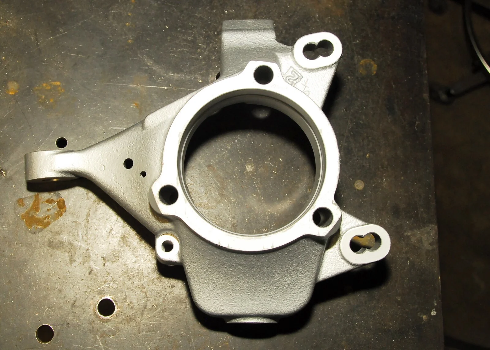

This is what we shoot for. We don't always get it this good but we never stop trying to.
That is just really sloppy engineering line control from Crown (or whoever runs the foundry for them in whatever country). These things can happen during manufacturing but they should never get out of the factory and into the hands of the end customer. There is no excuse other than "we don't give a shit".

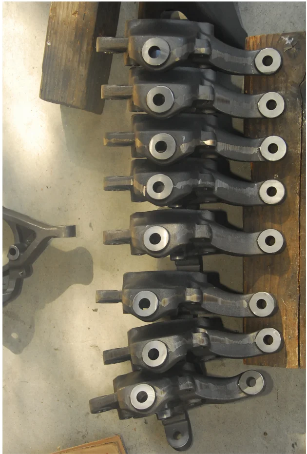

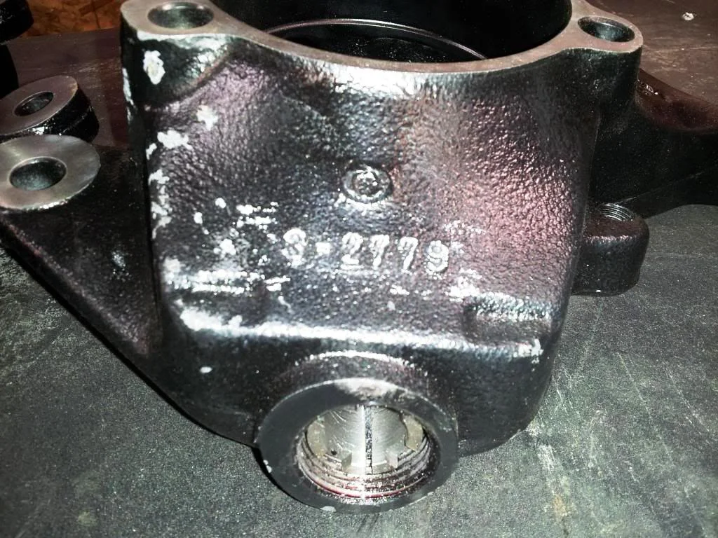

We get it sometimes. Our first and second batches were good, then the third one started showing some shift. We had to rework the patterns and reject an entire batch of knuckles to get it resolved. In our case due to the beefed up casting changes I made, it was not a strength issue but one of aesthetics and "that isn't what I paid for".
This is what I rejected.

I don't disagree but if you look at the reject picture, all of the pertinent dimensions are dead on, the knuckle axis is perfectly aligned as it should be, only a few of the holes are aesthetically affected by the pattern shift. In case it isn't clear, there are two halves to a pattern that makes the cavity in the sand casting mold. Each half makes an impression in the sand with alignment dogs and then the two halves are put together to pour molten iron into. If the alignment dogs are slightly off, one side shifts out of alignment with the other side. You wind up with a mostly functional casting in our case but the aesthetics are less than desirable. We still hit all the dimensional numbers dead on, they just didn't look good. The other ones above are not the same in that they are functionally compromised.

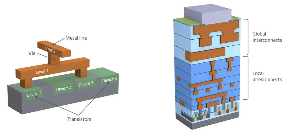

In semiconductor manufacturing .. we have what are called "Via"s that connect two metal lines that carry signal or power. Typically this is part of what we call the back end part of the flow (front end being the transistors themselves). We use extreme (as in wavelength) UV photolithography to make the patterns as to where the openings should be on the metal lines that need to connected to other metal lines above and below. Sometimes, the mask patterns that get generated towards making these openings have a small shift (in the order of few nanometers) and it can cause unintentional shorts and opens. It is called "mis-registration" in the lingo and whenever that happens, we have to generate the entire mask layer (which can be very expensive, since changing one layer may cause other layers to change, and hence new patterns generated for those layers as well). Note that just 1 via mis-registation can kill an entire chip that is functional otherwise.
Very many times, due to cost or the involved timeline, management wants us to figure out what the risk is (measured in terms of projected part returns per million for running the production line with the issue) before approving generating a new mask layer. We have to always fight the fight to push for the new mask layers since the amount of work it takes when we get a customer field return and debugging what caused it is a severe loss of time - but probably cheaper compared to the loss in terms of returned parts.
Same type of issue so you understand my challenges just on a much smaller scale, not the challenge, the shift.
