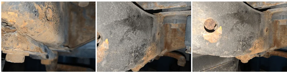

'02 Wrangler X Rust Nightmare: Looking for Advice

While the frame under the skid plate is obviously terrible, the rest of the frame, at least from the pictures, looks OK. Even the torque boxes look alright. I have to disagree with the others who say that if the skid plate area is that bad, then the frame is probably just as bad everywhere else. That really isn't the case with TJs. Thanks to the lack of drain holes, water and salt and muck collected at the lowest points of the frame without anywhere to go. The rest of the frame is *usually* OK, though obviously not always.
What you showed here is definitely fixable with Safe T Caps. The rear control arm area is probably also rotting away, so you'll most likely need the full channel caps. But you should naturally check the rest of the frame first. The other part of the frame that occasionally rots out is at the rear corners. How does the frame look there?

Sucks that this happened. I can’t see everything on your photos, but to me your best option is to replace just the center section of the frame with SafeTCaps. With the center section removed you can clean and treat the inside of the frame with rust converter, then spray the remainder of the frame with a rust converter. The torque box (floor support) appears ok in the picture that I see. Unless the brakes lines are leaking there likely is no urgency to replace them although that is a job you can likely do yourself. I wouldn’t expect welding in a center section of the frame to cost more than $400-500. Cheer up - you own a Jeep.

What a bunch of bastards to sell you a Jeep like that. It looks like they did a fairly good job of covering it up too. Looks like they even painted the driveshaft. Not many people would have noticed any signs of the condition of the frame. I'd definitely talk to a lawyer first, but if that doesn't come through then I'd look into safety caps. There are plenty of shops around Illinois that have done them before since half the Jeeps around here need them.

I took a look at the rear driver side frame and ahhhh! I'm going to brush it off tomorrow after work to see how deep it goes..
My 2 cents worth...not seeing the spring perch you reference, but Pocono Metal makes just a center frame section and is much cheaper than Auto Rust version. They also have control arm repair pieces along with the floor supports. I just did mine! The actual skid plate is pretty stout and you should be able to clean up. I also did the brake lines for the whole Jeep in Stainless Steel for just over $100.00. I dropped the fuel tank, that skid plate was junk! Mine isn’t a daily driver, just a toy I have had since new in 2000. You might get away with fixing the center sections and clean up the rest as best you can until you can do those.

Like I said, the frame is toast in more areas than just the skid plate.
Take a scope to the inside of that frame and I guarantee you'll see it's rotted in more areas than just the skid plate area. That being said, the only real solution I see here (if you plan to keep it for a long time) is an entirely new frame (or another TJ).

Personally, I don't see a problem with installing some safety caps on this one. They would work fine for this use case.
I would weld in some new segments, clean up as much rust as possible, and see where you stand. You could either keep the Jeep or sell it at that point.
