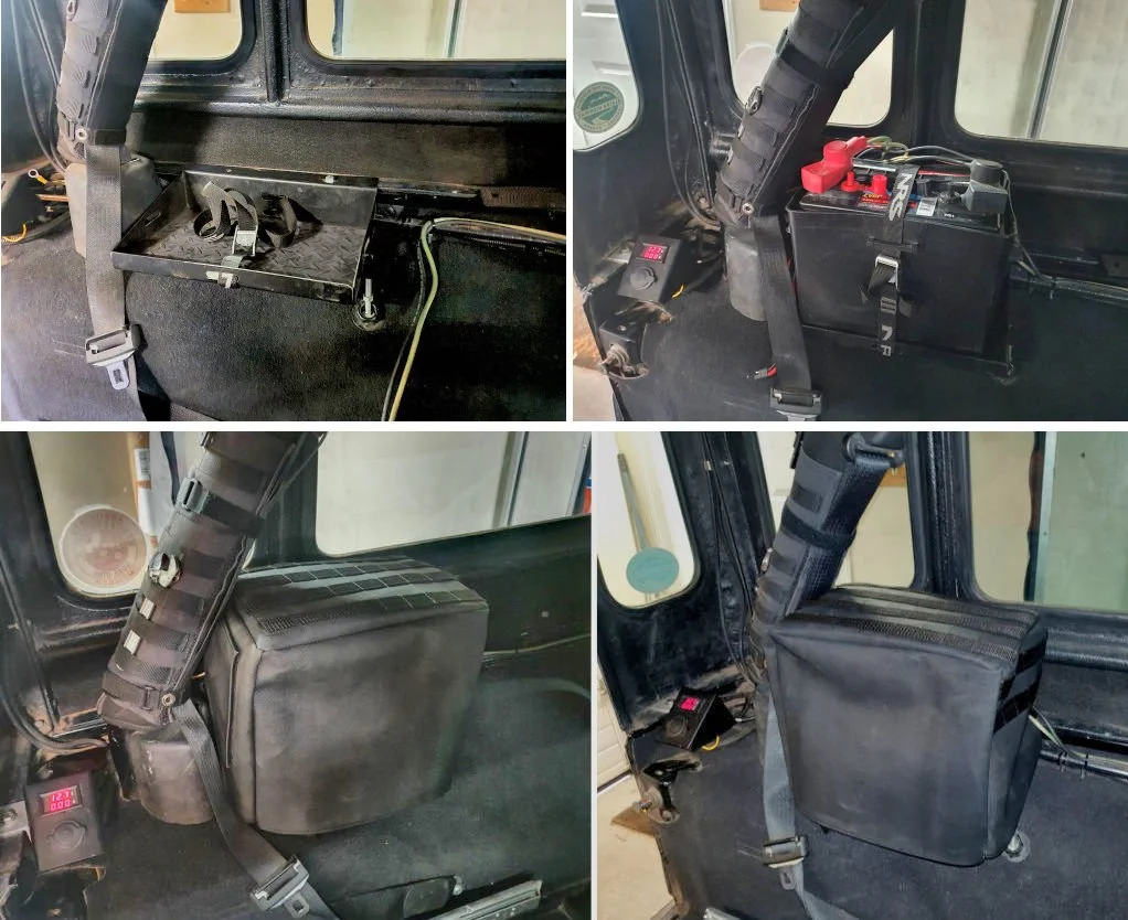

I have a dual battery system, with the second battery mounted in the back. The auxiliary battery gets charged by the alternator when the Jeep is running, but when the ignition is off, the auxiliary battery is isolated from the starting battery so the kitchen/fridge can never drain the starting battery.
The auxiliary battery is kept in a tray over the rear inner fender:

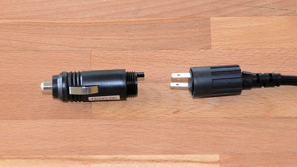

If you have an ARB or Dometic fridge (and some others have this too), the plug on the end of the DC cord comes apart - the "cigar lighter" part comes off, leaving a connector that secures with a threaded sleeve. This is the plug from a Dometic with the cigar lighter tip removed.

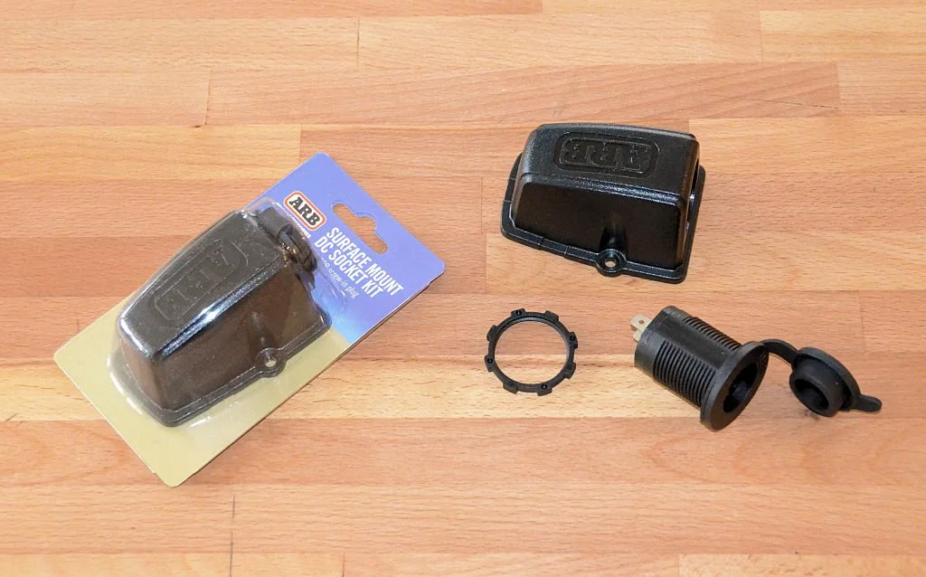

The two-prong plug goes into the outlet pictured below, and the collar around it screws into the socket so the plug cannot vibrate loose. The ARB socket comes with a housing; in the photo below the socket has been removed from the housing and can be installed without the housing if that suits your needs better than using the housing. The ARB sockets with housing are available lots of places for about $12.
If your fridge does not have a two-part plug like the ARB and Dometic fridges do, ARB sells replacement cords with that plug which you could splice onto your current fridge cord, assuming the fridge end of that cord doesn't fit your fridge.

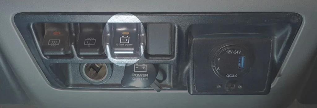

I added a 2 port 12 volt plug along with an 800 watt inverter under our cargo platform . I ran a 10 gauge wire for the power ports and a battery cable for the inverter . The 10 gauge is fused at the battery and has power all the time . The cable for the inverter has a breaker and continuous duty solenoid to turn off with a switch on the dash .

And if nothing else I highly recommend the ARB screw-type plug and socket; a cigar-lighter type will let you down someday.
I also recommend the ARB screw type connector. Been running it for years.
