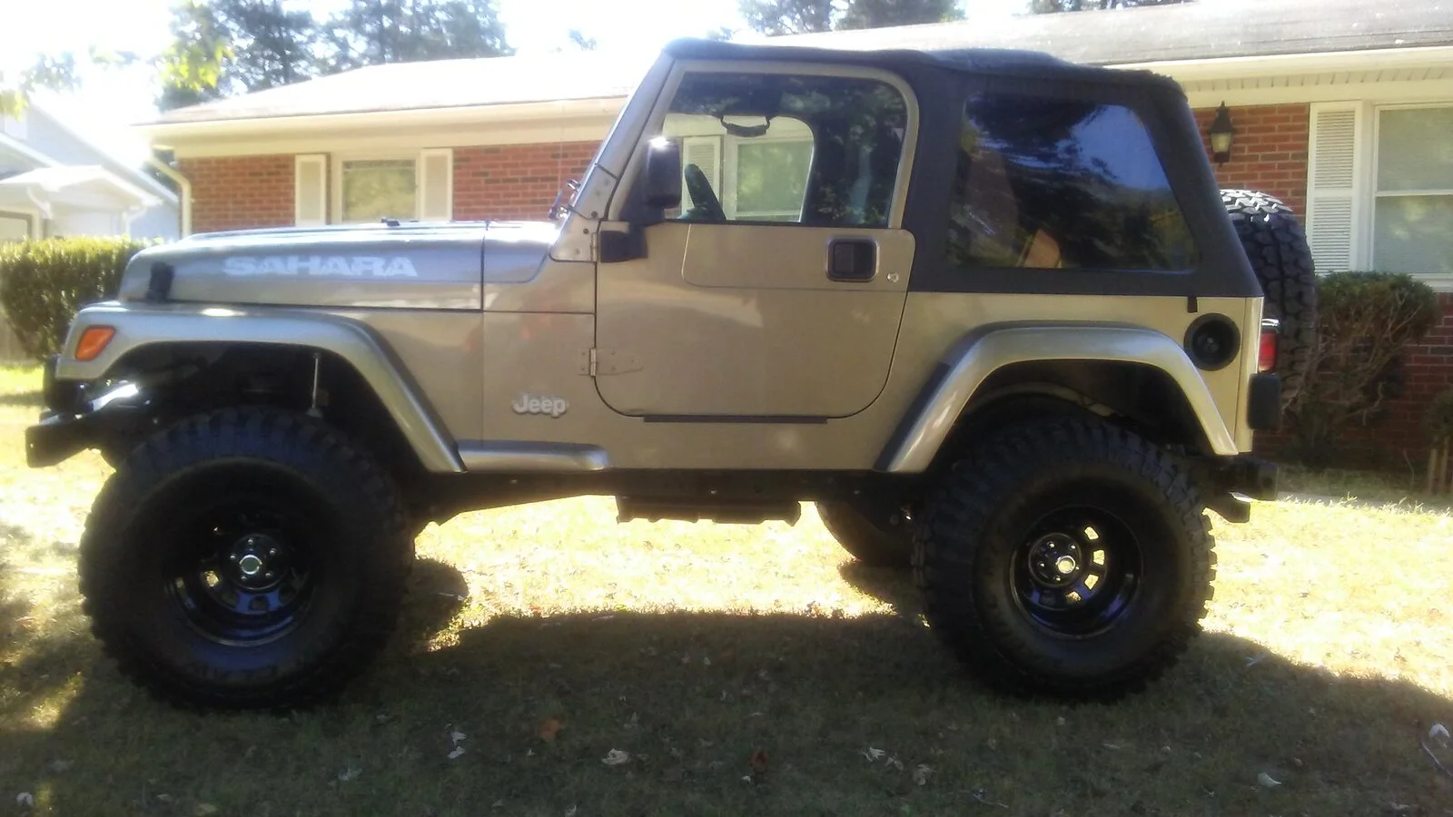

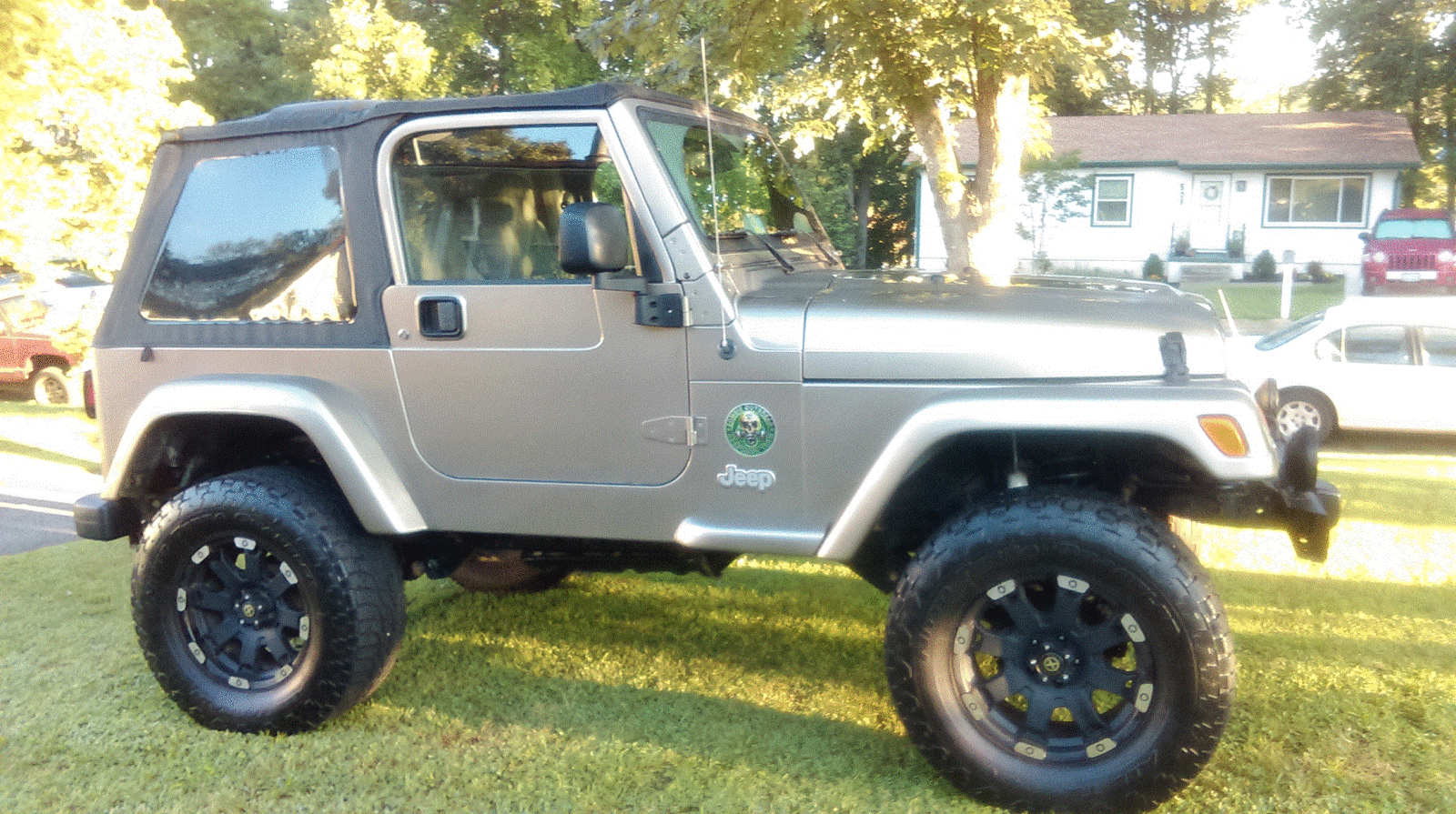

I bought a Jeep with 17" wheels and AT tires on it. They were sold within 2 weeks for some 15" wheels and MT tires.
