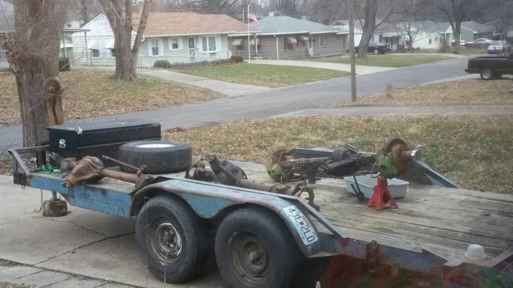

made the 6hr round trip for my hp44, now back home and have the 9 " tore down for moch up.
Looks good, beefy too! How thick are those axle tubes?

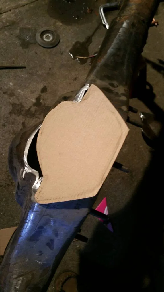

Not sure. This 9" had a 3rd mount on tip for a anti wrap bar. Well I couldn't get my grinder in far ehough. So I it with a hammer to knock it loose. Well it came off, but also tore a 1" hole in the housing. So now I'll have to plate it

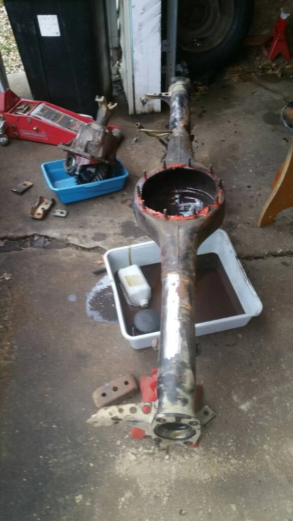

new housing is on the left. Have to remove everything from the one on the far right and install it.
Here goes nothing.

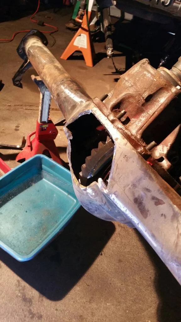

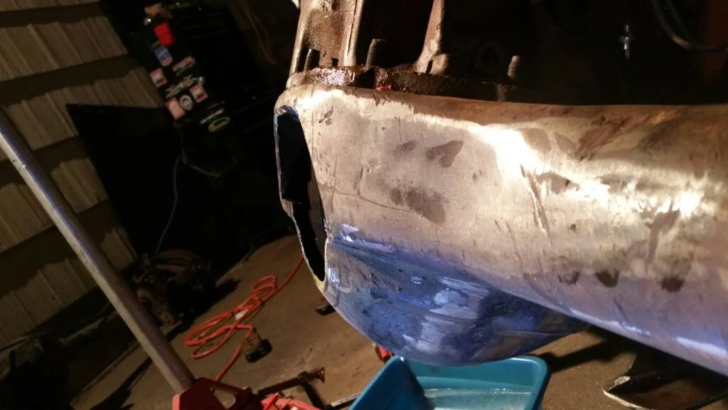

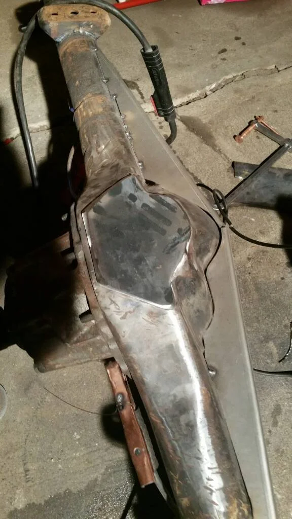

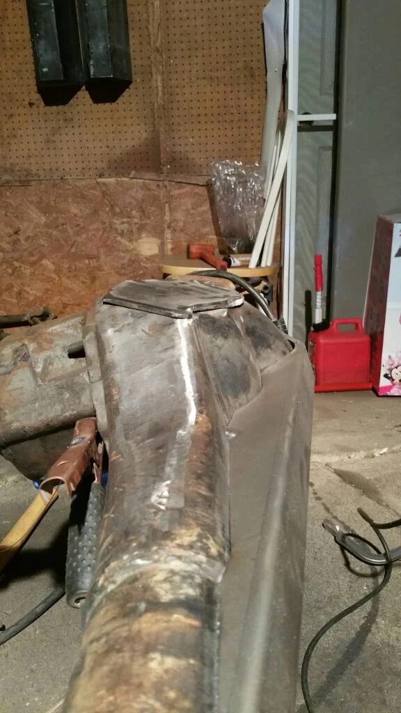

shaving a 9"... my first try. Turned out great. I copied a clip from youtube. For the "cut line"..
Thanks. Not bad for my first time. Just gotta remember not to rush it. I ran out of welder gas, and my grinder shot crap. So I'll finish it another day i guess
It looks like that will be one beefy / strong axle once it's done! What axle shafts are you going to run?

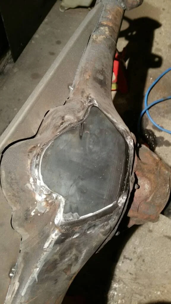

had to buy a new grinder. Got the outside plate welded. Need to pull the 3rd member out and run a bead inside the housing.
Also put a pre-load on the housing so I can weld the back bone .
Looks good so far! Are you going to pretty it up and powder coat it when you're all done with the housing?
