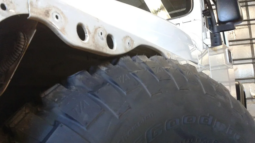

Body lifts aren't bad as long as you stick with 1.25" or smaller BL. This is what the fender looks like without the plastic flare,

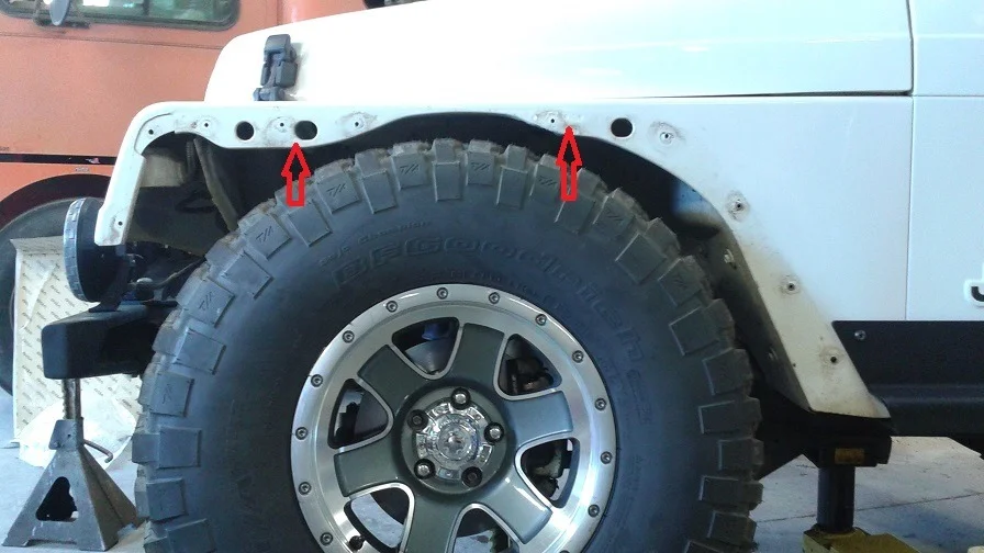

The arrows indicate the most common points where the tire will hit if not bumpstopped properly.

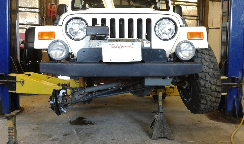

Here I'm checking for clearance at full bump with the wheel at full lock.
can I replicate this myself to see if the bump stops are right? and if not, would a 1" body lift solve the problem?.....
and in addition, would I need anything else? motor mount lift, t case drop, etc?
Only thing a body lift will do for you is give you more suspension travel before the tire hits the fender. This would be beneficial if you end up needing to add more bumpstop to avoid interference with the fender.

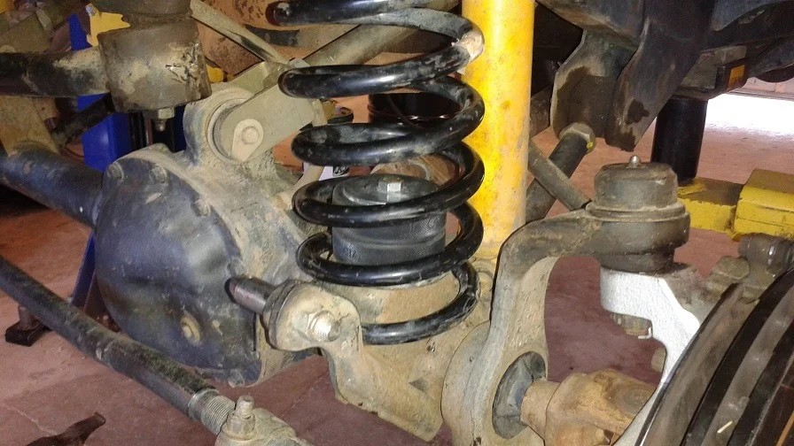

This is 2" of added bump stop to the front for reference.
By adding more bump stop you are also limiting your suspension up travel. Moving the body up 1" allows the suspension to up travel that 1" more before the tires would rub. The other option would be taller springs, but that opens up another can of worms.
