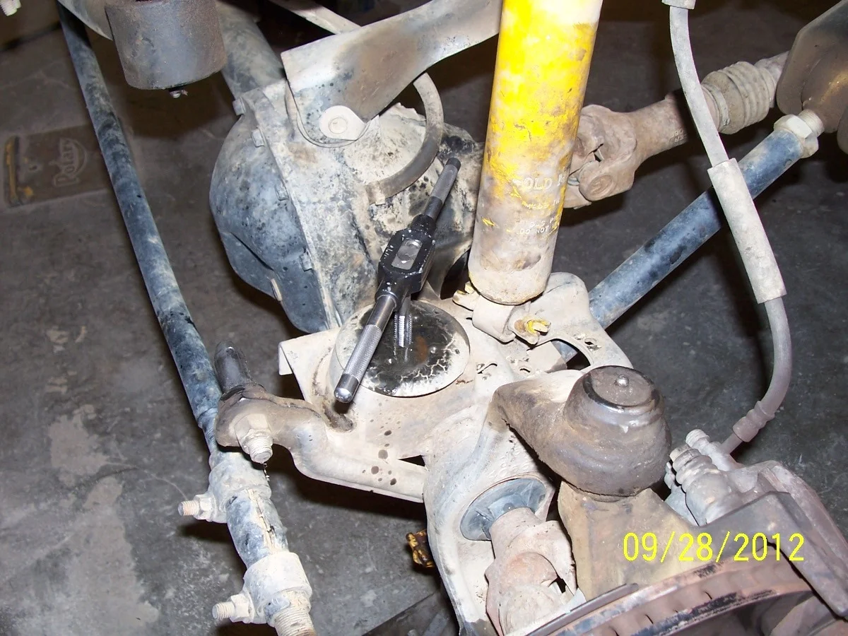

Based off my jeep, which has a 2.5" lift and 33X1050X15 tires and 1" wider Rubicon flares, I needed 2" bump stop extensions in the front, and 1.5" bump stop extensions in the rear. I'd start there and adjust to suit your rig. You'll have .5" less lift, wider tires, and narrower flares. It's a bit of work but the best way to set it up is to pull the springs and shocks then set the axle at full bump then you'll find out real quick what hits and what fits. You have to pull the springs anyways to drill/tap threads for the added bumpstops.
In this photo, I'm drilling/taping thread in the front axle lower spring perch to add bump stops, which happen to be 1" hockey pucks.
