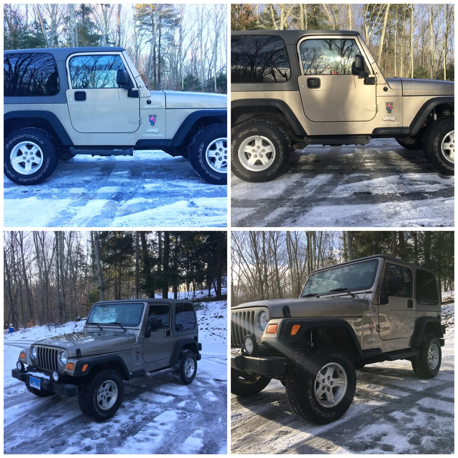

2" lift w 33" inch tires

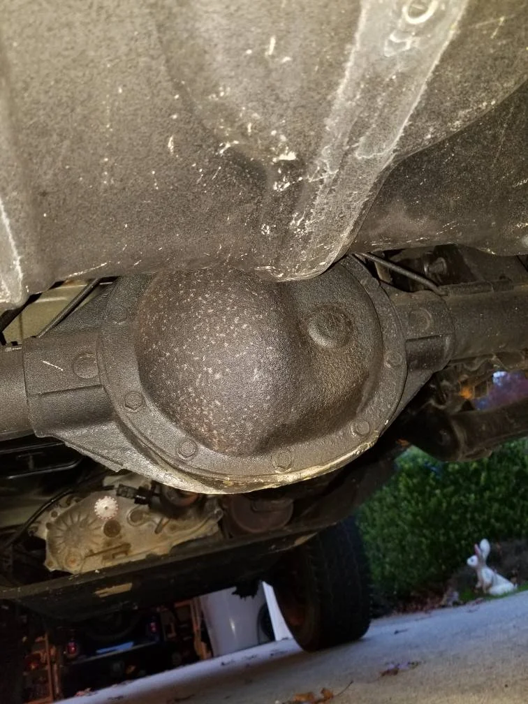

The reason I listed the fill plug is, the Dana 44 has a metal threaded fill plug, the Dana 35 has a rubber fill plug. Dead giveaway besides the shape of the diff cover.
I just looked at diagrams for the differential covers for the 35 vs. 44 and mine is definitely the same as the 44.... not sure if that's accurate but I assume it should be?
Has to be. Another dead give away. What model do you have? Sahara or Sport?

X didn’t have the Dana 44 as an option. Could have been added by the PO. Why not shoot a pic and post up!
okay looking again, this is definitely the 35..... I think the bolt pattern threw me off bc on one of the diagrams I was looking at, the bolt pattern was completely different so I thought it must not be the 35 but taking a closer look, it definitely is
Reactions: Fouledplugs
well darn, that's disappointing.... I guess the axle upgrade will be added to the list of improvements..... definitely have a project
