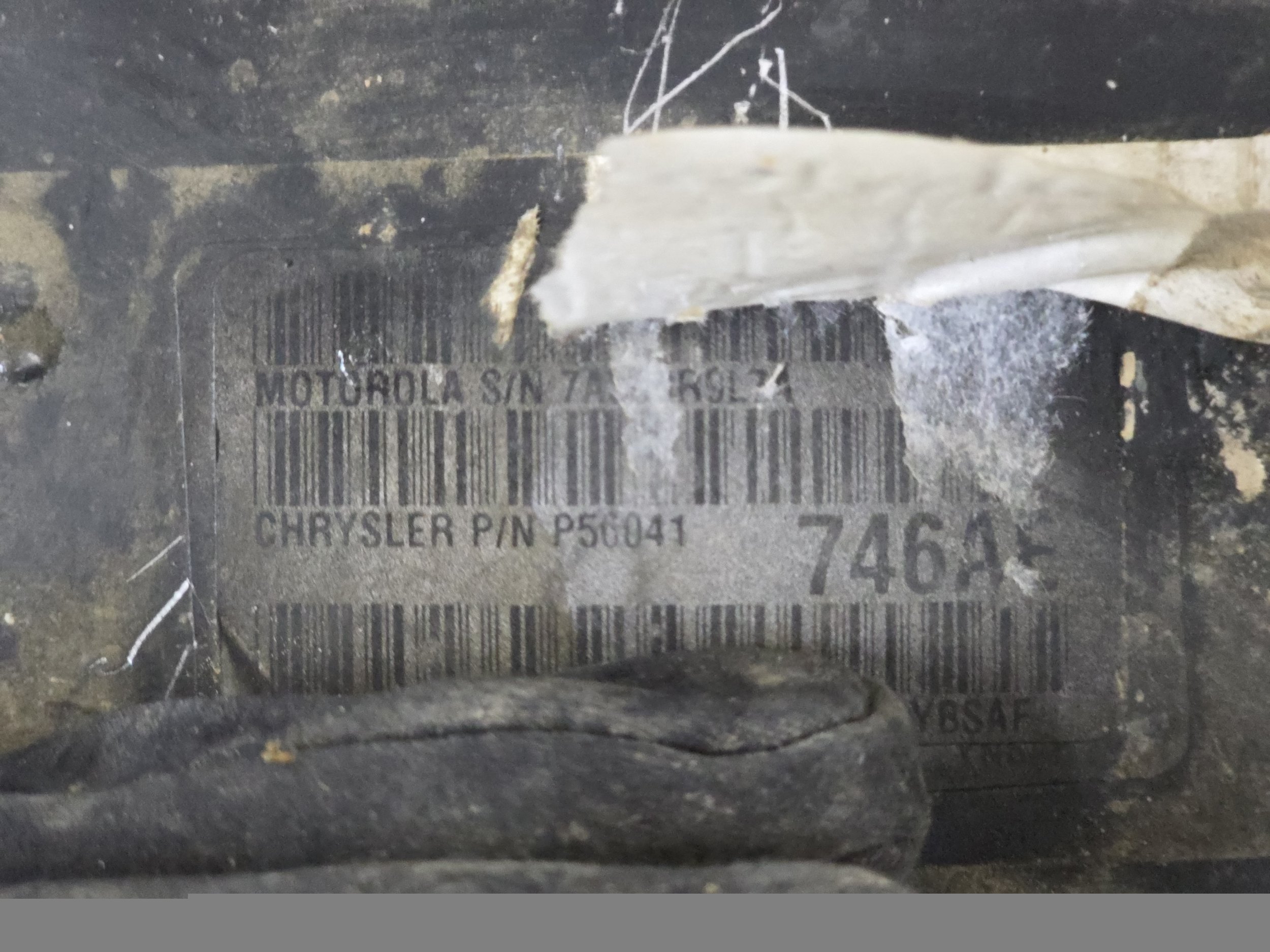

When I first did my swap with the 5.2 I ended up with 3 bad PCM's before I finally got a good one. I understand yours is not that issue since it came out of a good running/driving truck... Which would also most likely exclude things internally with the transmission... So I would look at wiring since I really don't think the TV cable could be the issue but I also can't say it isn't.
But I don't know what wiring since 1-3 gears are hyd controlled from what I understand and it's only O/D that was electronically controlled.
