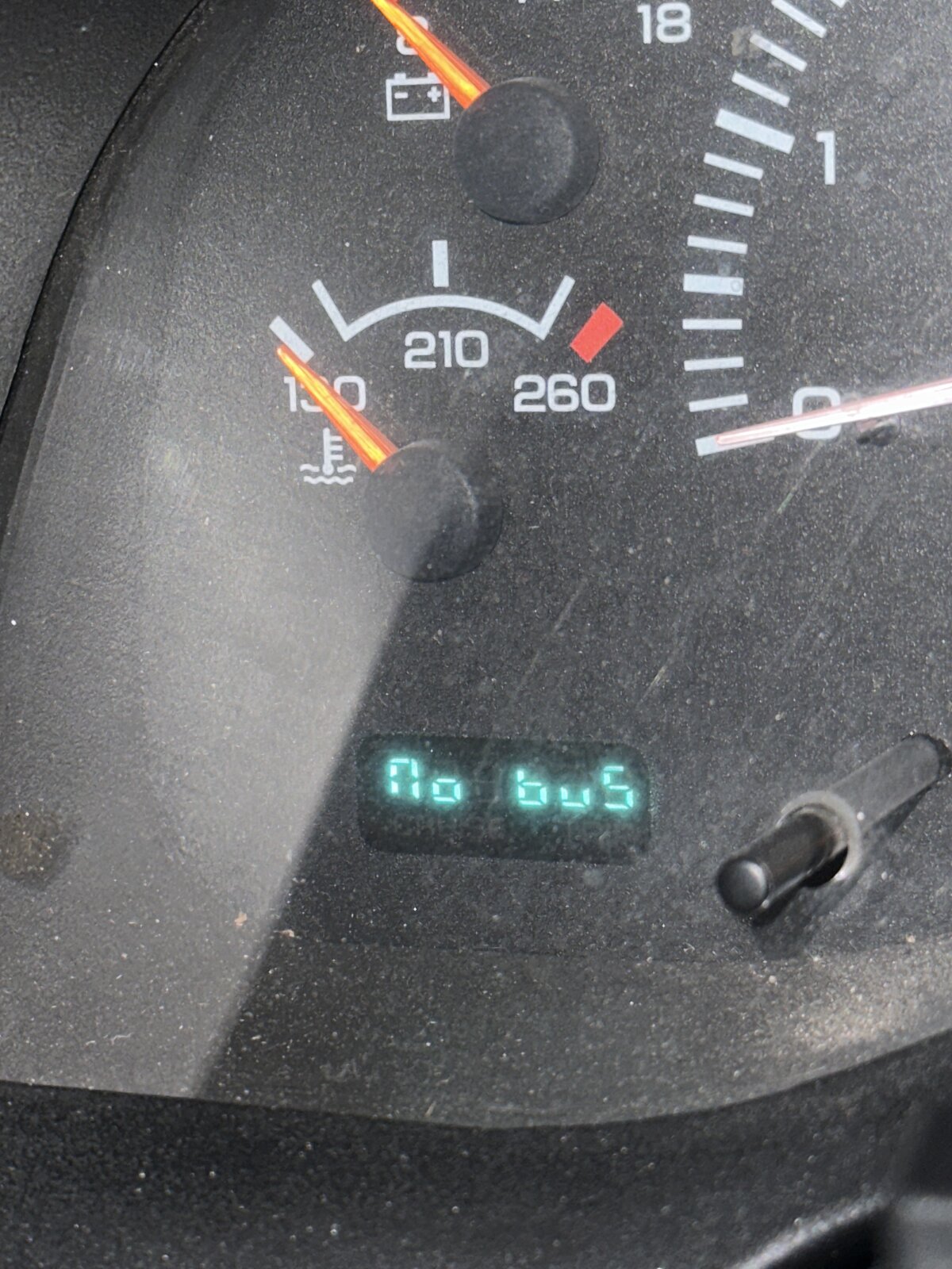

I have a fully running 01 ram 1500. I just ordered a 2002 ram ecm for a 5.9 auto off eBay that I will use to test on the 01 before I dismantle it. My goal is to get a bus error on the dash on the ram but for it to start. My reasoning for going about it this way is that I just don’t want to be chasing issues after I do the swap and not know if I need to chase wiring or pcm issues.

To provide some closure for someone else going through this. I swapped an 2002 ram 1500 5.9 auto pcm and got the pcm error I was expecting about 30 secs after turning it on.
Reactions: Wildman
I'd say that this is a GOOD sign that a 2002 PCM is PCI & not CCD.
