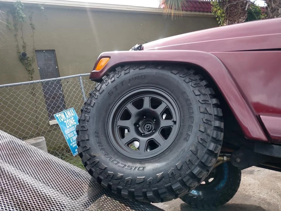

The latest update was swapping out load range E tires for load range C. I kept the same 33x12.5 Cooper Discoverer STTs, but changed wheel size from 16” to 15” opting for 15x8 XD301s.

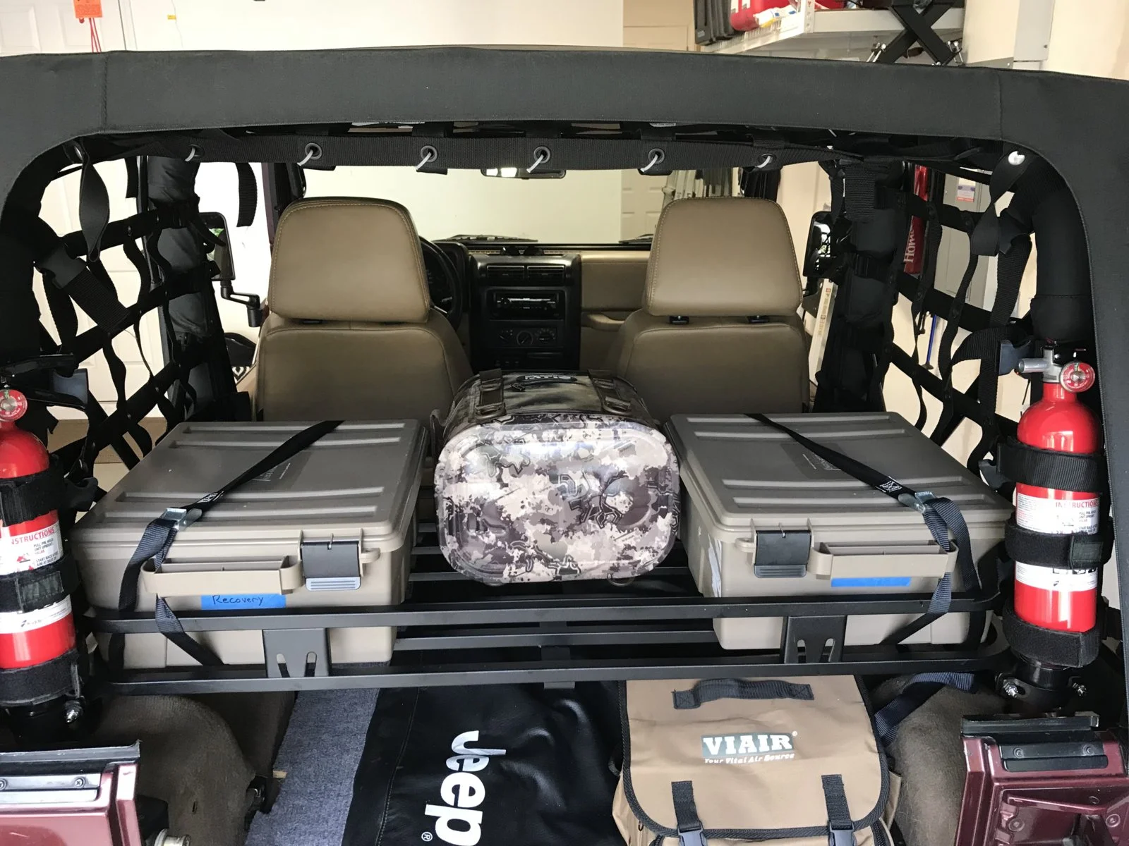

I never added this...
Storage is always an issue in the damn TJ.
I was strapping my boxes and compressor down in the back, along with a cooler and backpacks. Then on top of that I’d have to load in the bag with the soft upper doors and windows (never know in Florida when it will rain).
76075
I always thought that there had to be a better way. Then while I was in Maine, I saw that my father had an Olympic products storage rack and it dawned on me that I could put the boxes and cooler on the rack, and slip the bag of doors and windows underneath it. Duh.

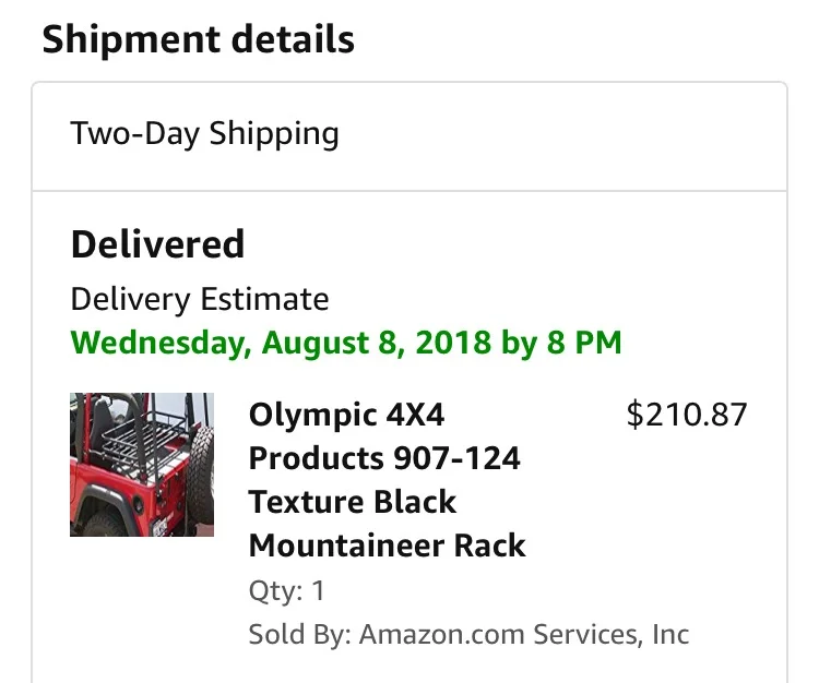

I went searching for the best price, and I don’t know how it happened but the stars aligned and I found a crazy Amazon deal.
Regular price:
76076
Crazy deal price:
76077

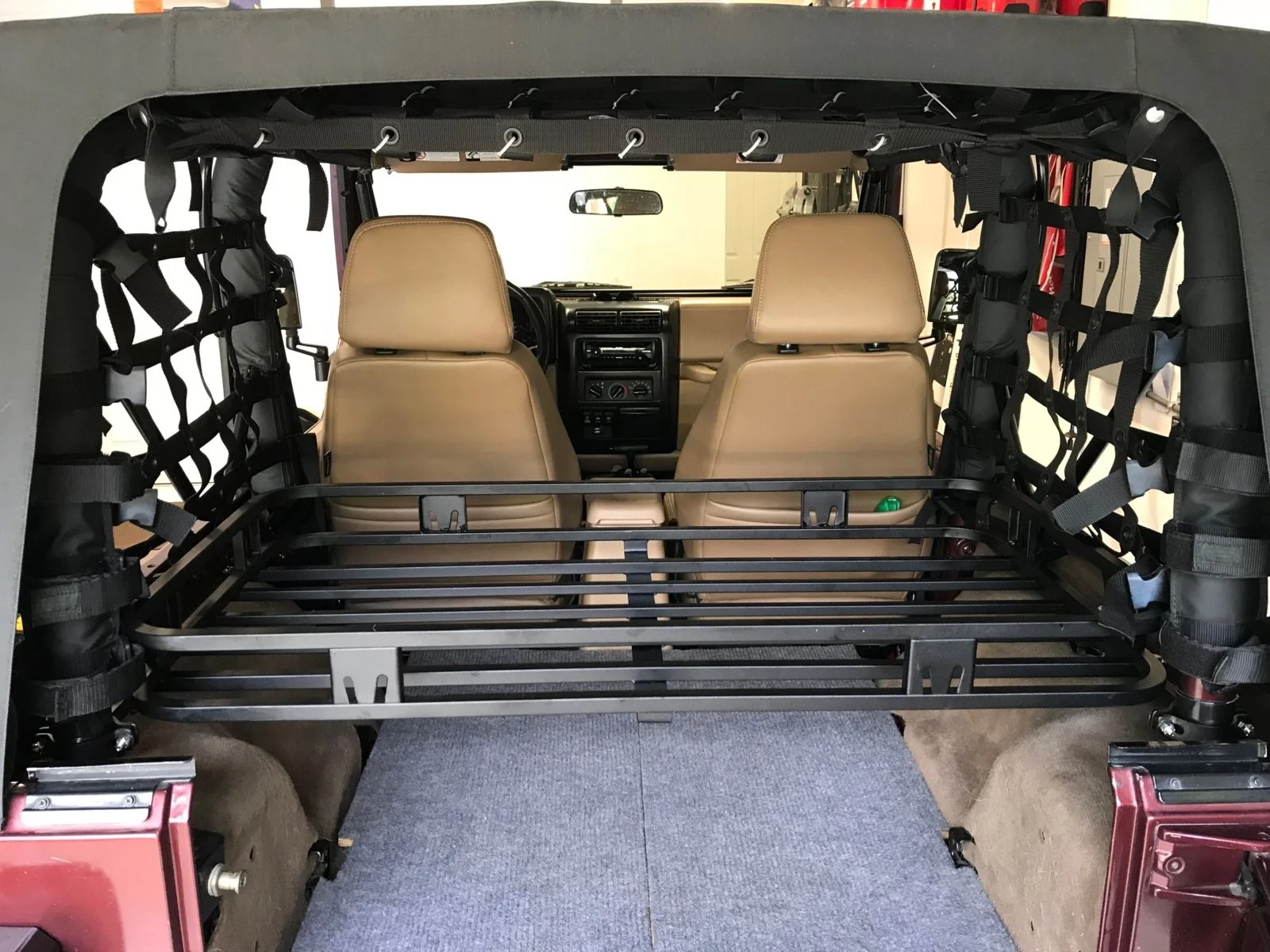

I finally got around to start installing it last night. I removed the rear seatbelts, which will allow me to mount the rack very low, just above the fender wells. I can keep the braces that span the rollbar in all the time, and install the rack (just four bolts) when we go wheeling. I modified the rack a bit by drilling four new mounting holes on the spanned bars. This allows me to push it as far back as possible toward the tail gate, which allows room in front of it to reach backpacks or anything else that needs easy or quick access.
