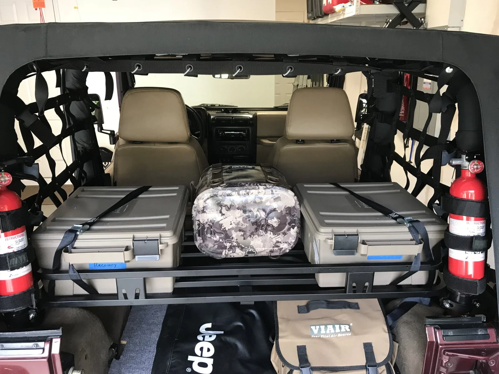

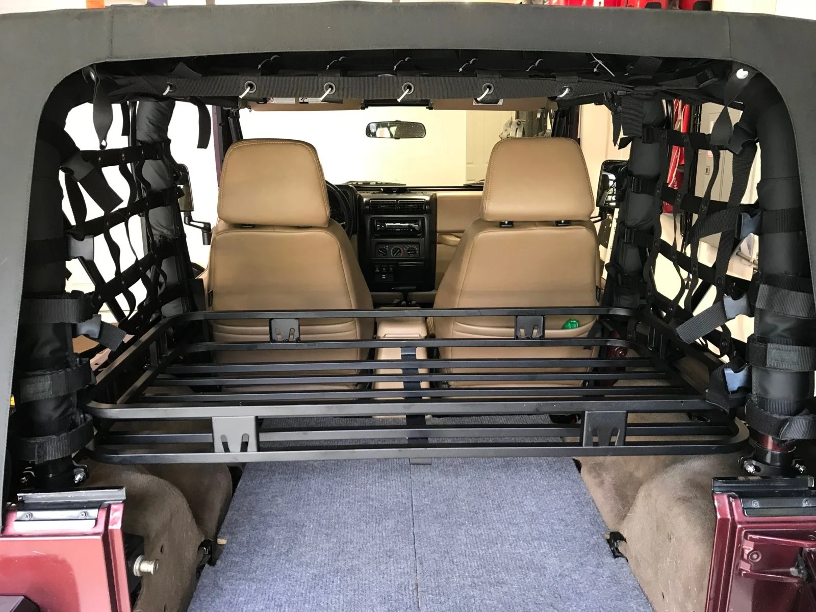

I have one of these mountaineer racks in my TJ as well. I actually picked up (probably in 2003 - EDIT to change from 2003 to 2002 - obviously since the photo below is from 2002) a 'display' rack from Wilderness racks which is a little bit bigger than the Olympic basket. I have the option to use either but the wilderness basket takes up all of the space behind the seats while the olympic basket leaves some clearance.
I have left mine centered (more or less) so I have the option of putting my folding table in the back (behind the basket) but still have some space for my rolled up tent, camping chairs, etc. behind the seats.
One of the coolest mods I found for my rig.
82770
That's the original BlackSheep with the wilderness rack behind the seat in 2002. BlackSheep II is in progress and at this moment the intention is to use the Olympic basket.
