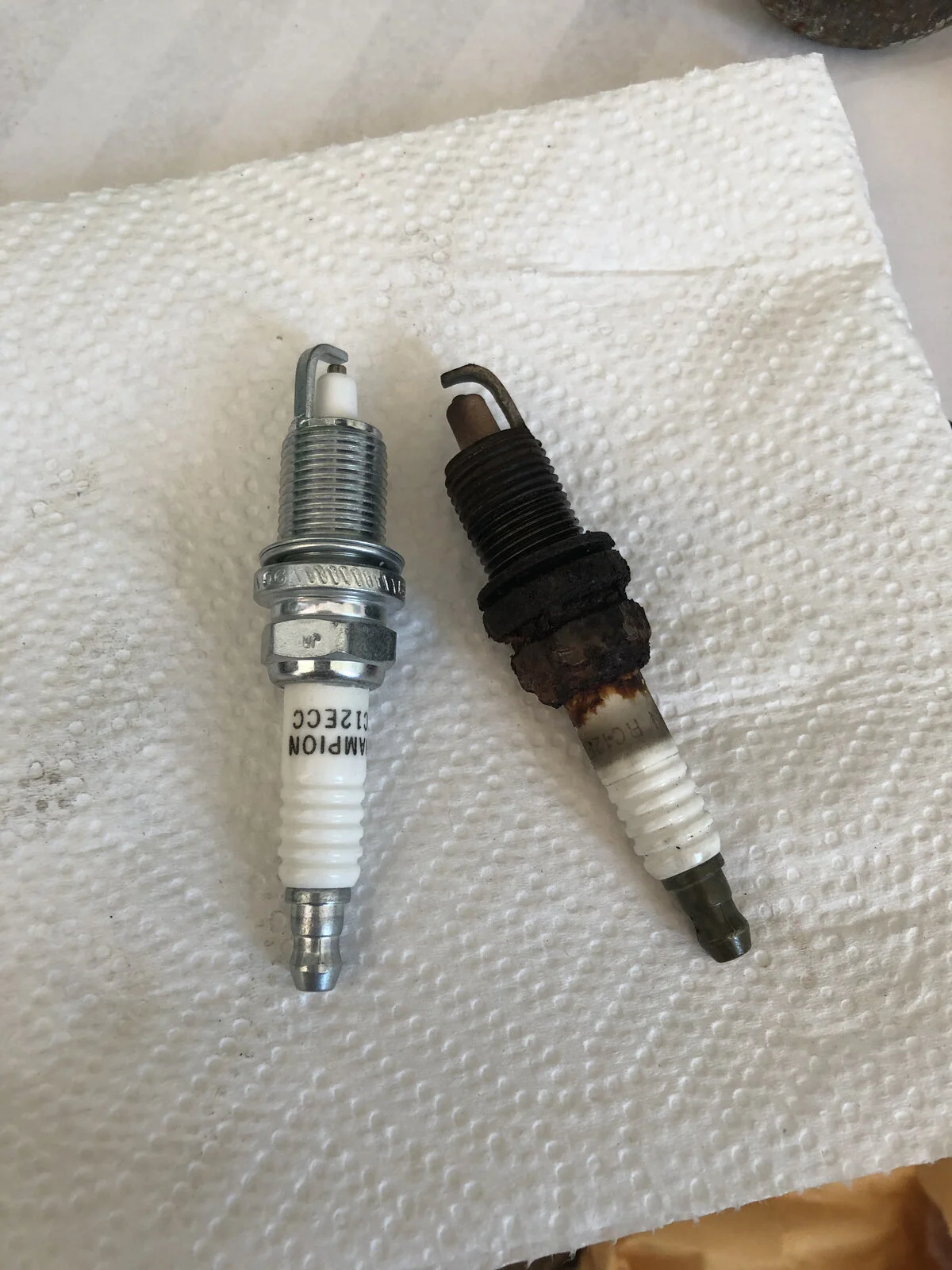

I did the regular maintenance with fluids and oil change. Big thing I noticed were the spark plugs!

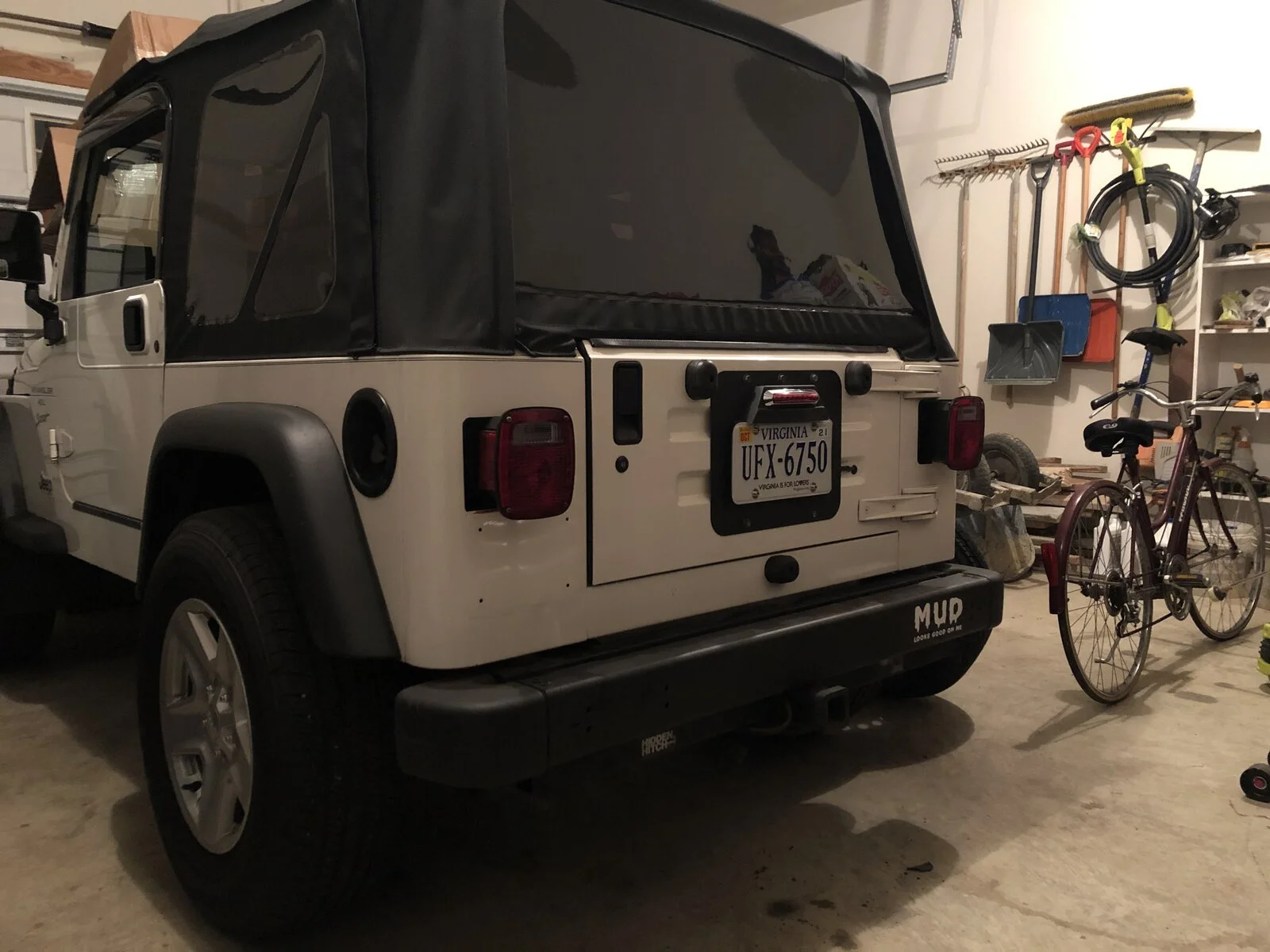

I removed the rear license plate and moved it over to the tailgate and wired the 3rd brake light.

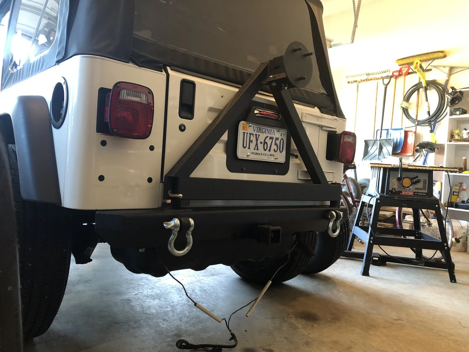

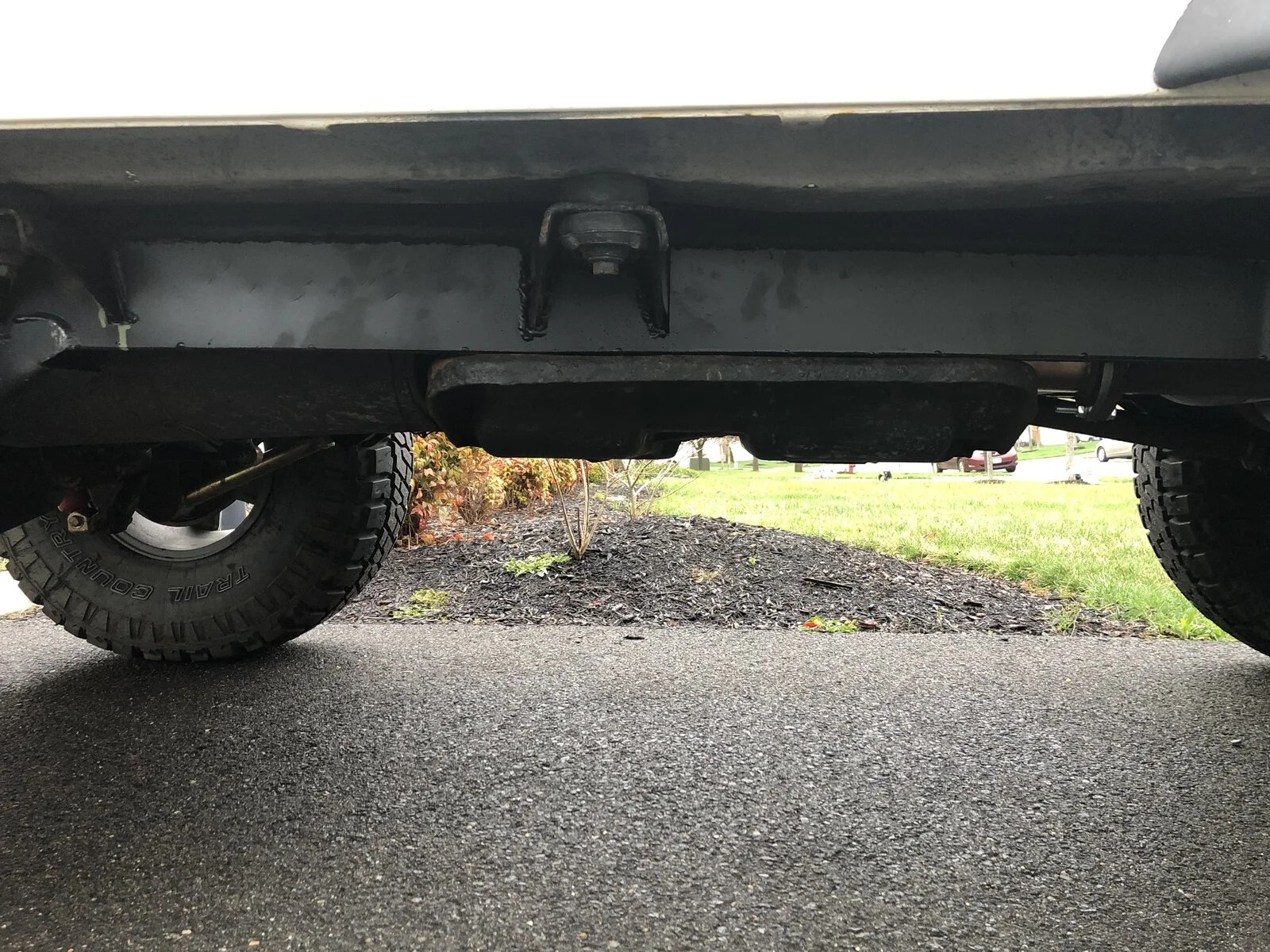

The project for this weekend is installing a rear bumper that holds the tire from the bumper and not the tailgate. I will only mount the tire when going away for far trips or when off roading.
So far I was able to take off the rear bumper with no issues. Just soaked bolts with PB blaster throughout the week.

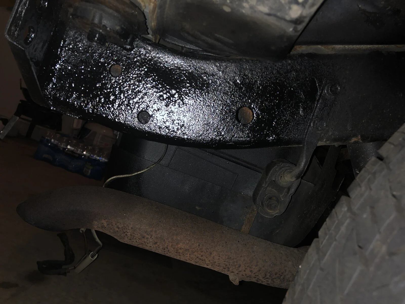

The hitch was a pain. The bolts for the hitch to the frame would just spin. I was able to use an angle grinder and cut off the bolts (first time ever doing this). The hitch finally came off. I was then able to fish out the bolts left in the frame fairly easily.
I saw some surface rust under the POR15 from the previous owner where the hitch was removed from the frame. I sanded it down. Used Rustoleum Rust Converter and Rustoleum rubber undercoating.
I will tackle installing the new number next.

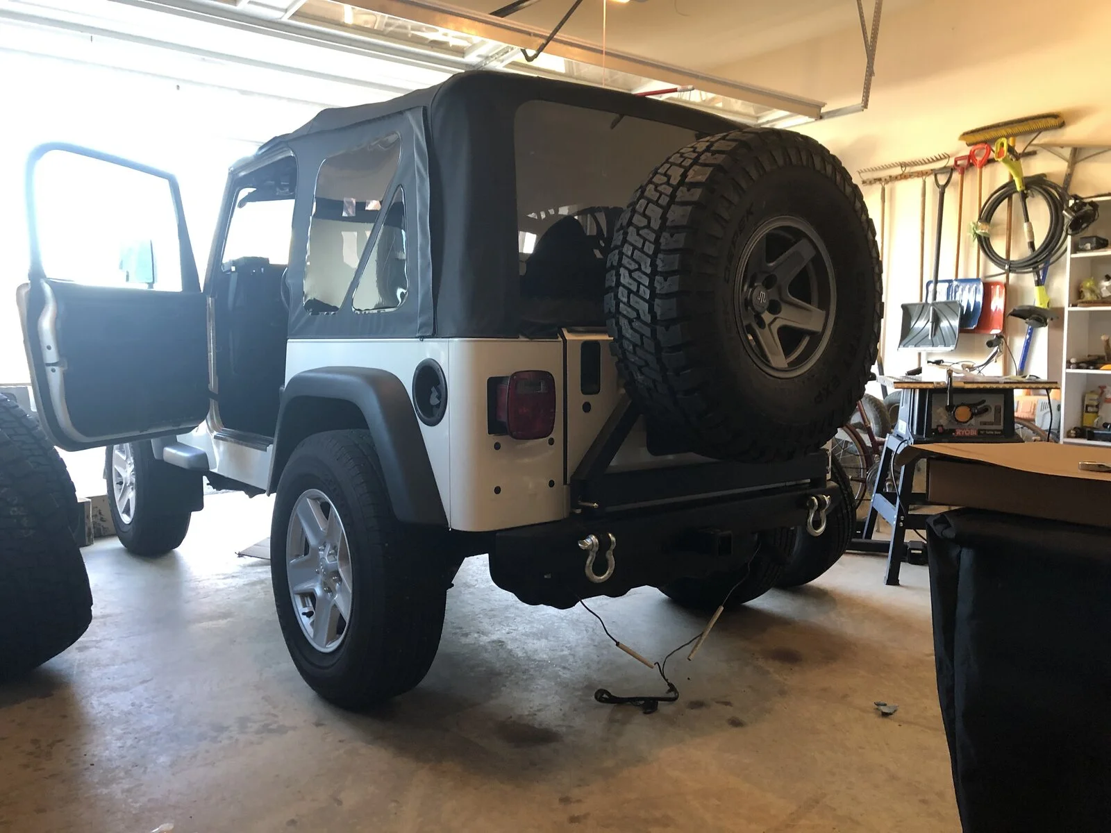

Today I installed the bumper. The bumper is the Smittybilt 76651D SRC classic rear bumper with tire carrier. It was a fairly easy install. The tire carrier gate won’t fully open (hits the bottom tailgate hinge by 1/4 or an inch). I’ll try to figure out how to get it open.
I will mainly drive this without the tire on the carrier. Will only take the tire on the carrier for off-roading and long trips.

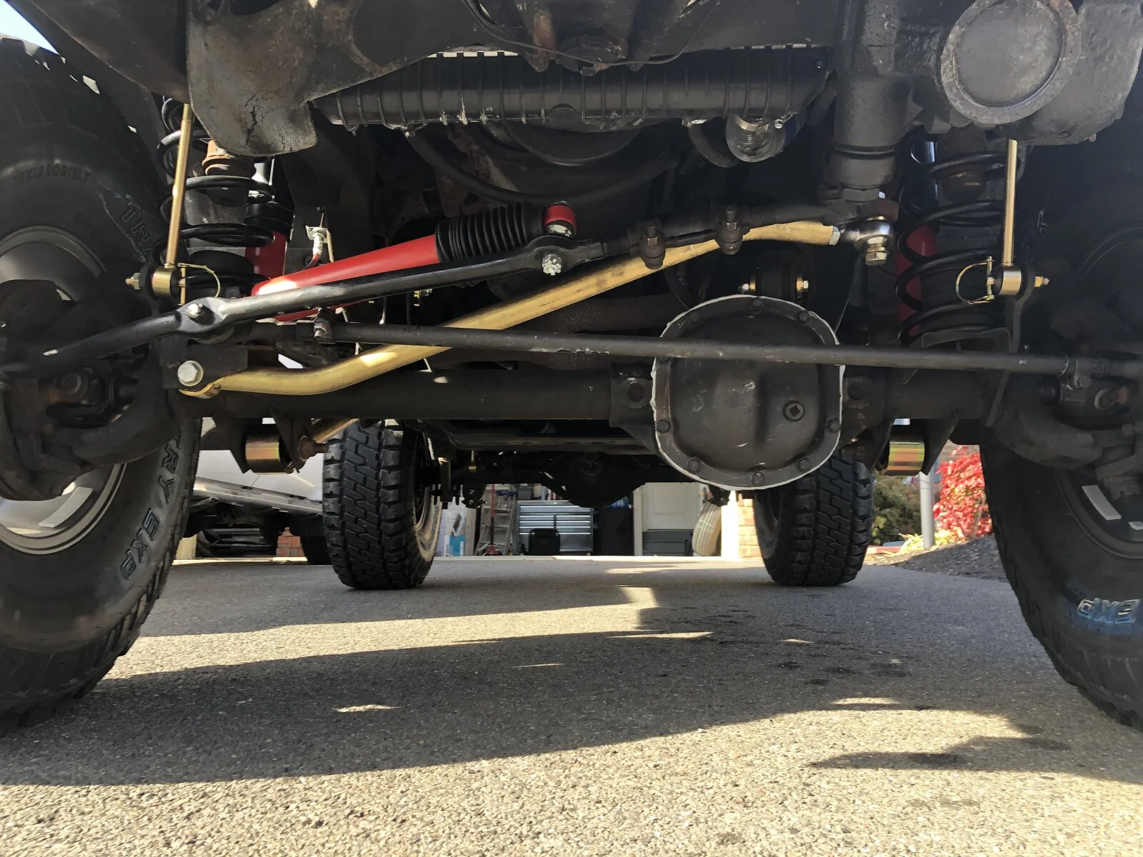

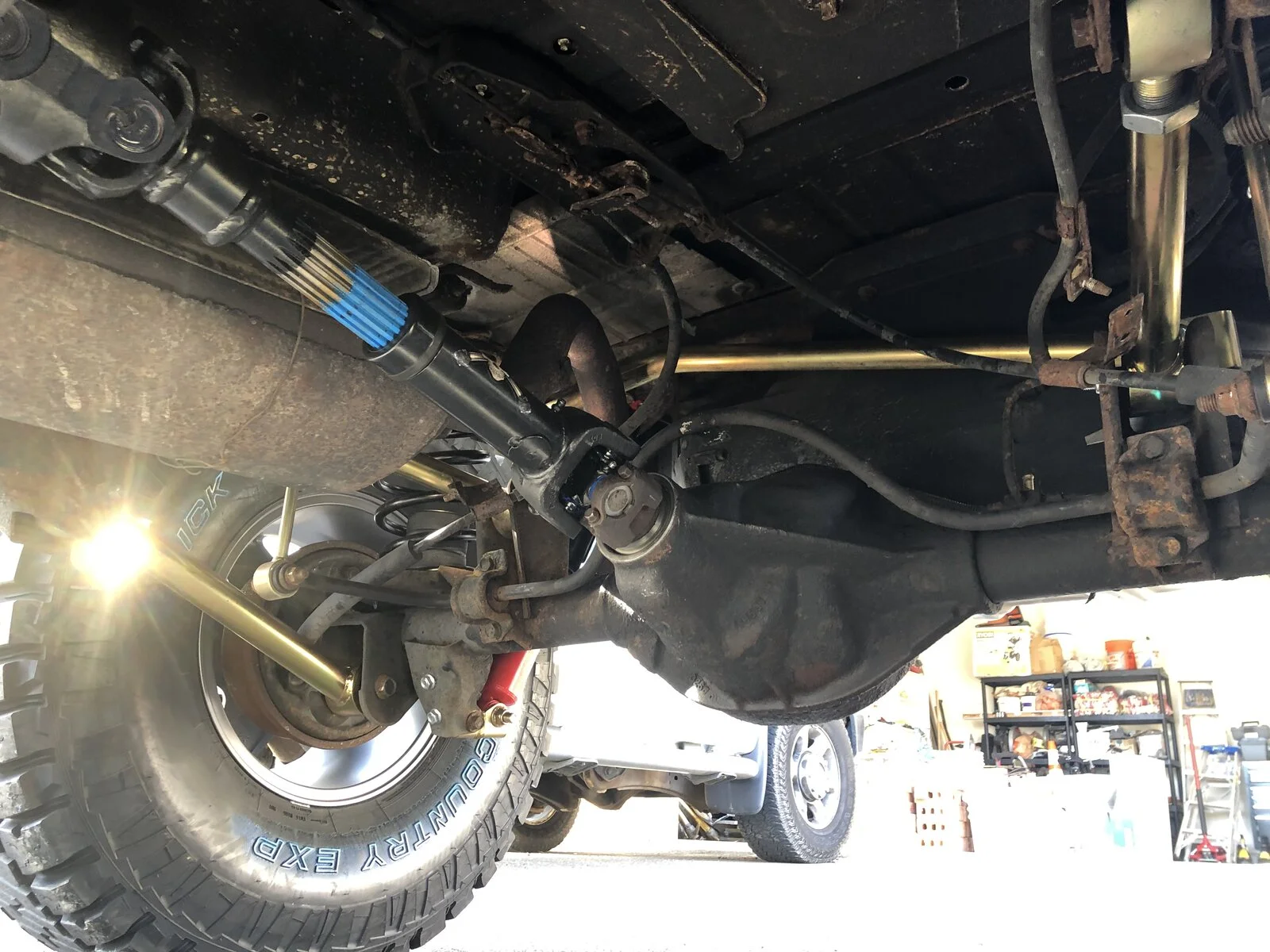

Just picked up my TJ from Torqued Off Road in West Virginia. They installed the following:
3.5 Metalcloak long travel short arm kit
Rockport steering stabilizer and shocks
Adam’s driveshaft and SYE
G2 4.56 gears
Front and rear chromoly axle shafts
replaced the both carriers and my calipers as they were seized
35x12.5x15 tires
Mammoth wheels
Drove 75 miles back home, following the gear break in procedure. I previously had a 3” BDS lift with 35’s on my JKU. This is what I initially noticed as I’ve driven stock and now 2 lifted Jeep:
I thought the breaking would be horrible from reading input from other members on 35s and stock breaking. For me, the breaking was better with 35s on my TJ than when stock. I think it was due to the new calipers?
The ride quality and steering was better than stock. Have the gear upgrade was awesome especially going from 3.07. It had a pip to it’s step!

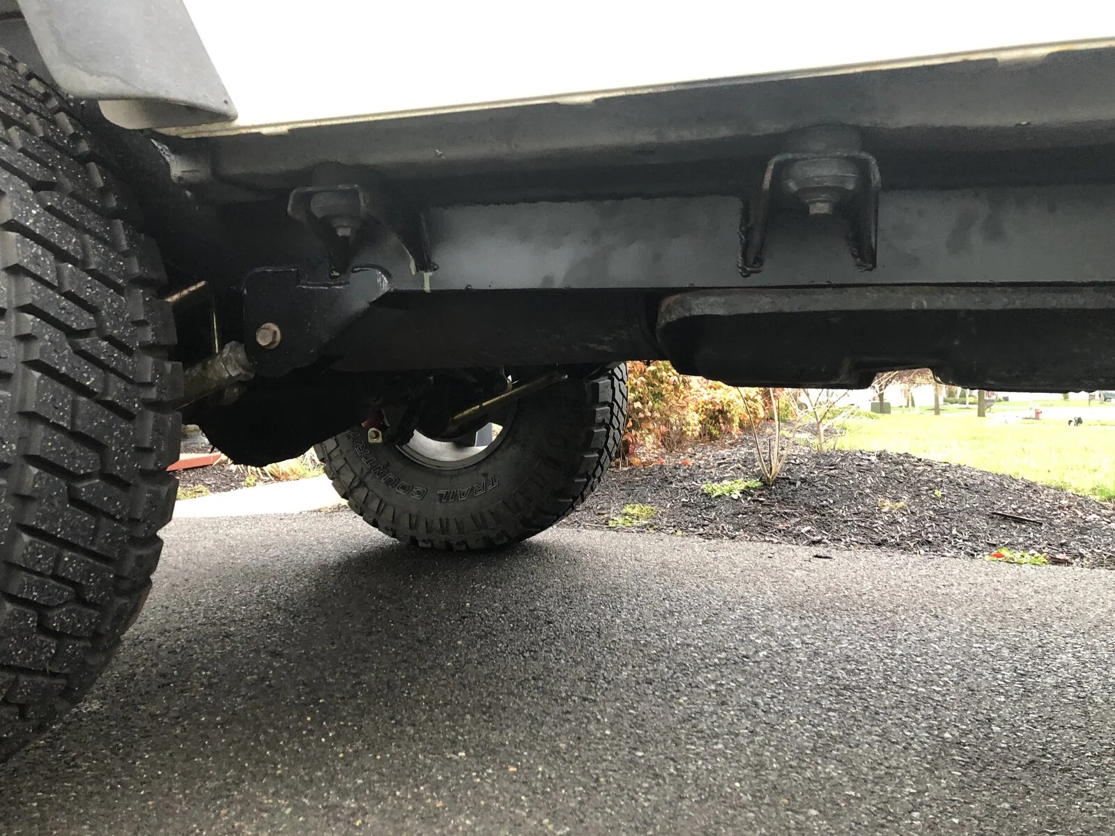

I got my Jeep Safe T capped from the rear control arm to the front control arm on both sides due to rot. The Rear main was leaking and my pan was pretty rusted so those were fixed and replaced. I also upgraded my stock steering to the Currie Correctlync. I can definitely feel the difference with the upgraded steering.
