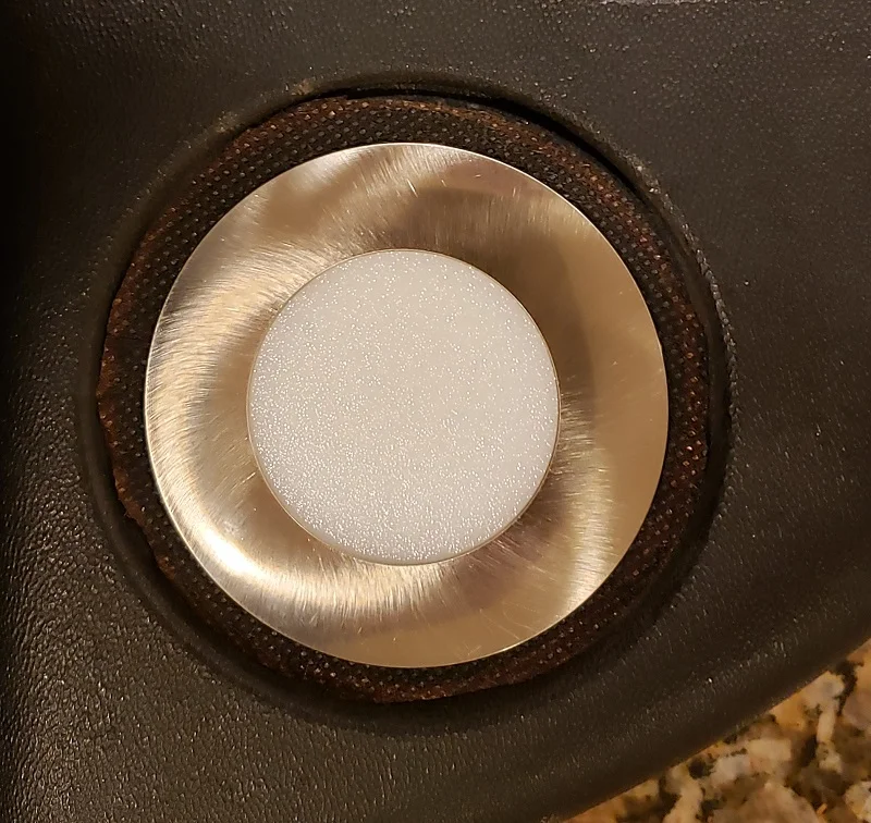

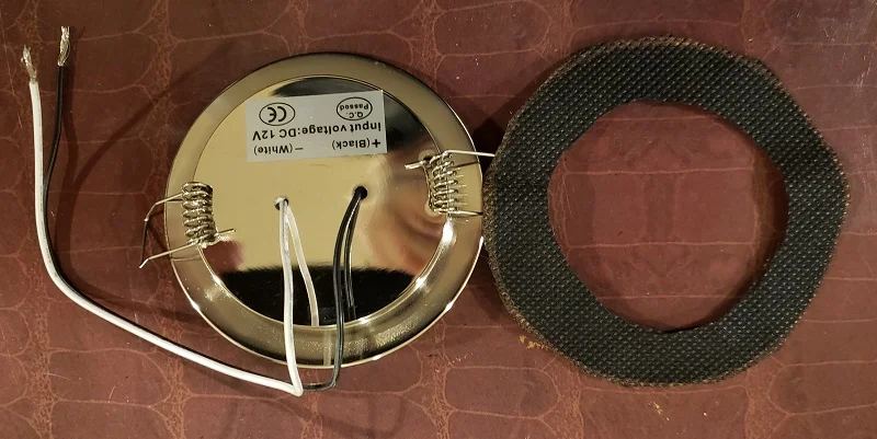

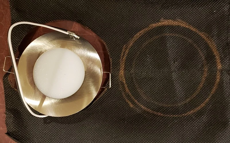

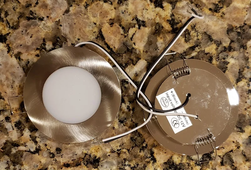

The lights came in and I had a chance to fit them. I'm not overly thrilled with the brushed nickel look, but the light output is much better than the stock incandescent bulbs.
https://www.amazon.com/gp/product/B075447DNV/?tag=wranglerorg-20
They were a little smaller than I'd like, with parts of the existing drilled holes showing in the overhead pod, when the lights were installed. To fix this issue I used some heavy black material I had and cut out two circles, which added about 1/4" to the outside of the new lights.

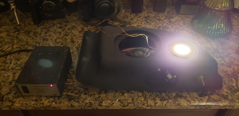

Once I had them cut out, I installed both in the pod housing to test the fit. I also attached the lights to a 12v power supply and let them burn for 15 minutes. There was no noticeable heat, and all was good!
Overall, I'm happy with the upgrade, which:
- reduced electrical load
- improved light output
- significantly reduced light heat and
- was a very easy upgrade
Ideally, the lights would be a little bigger, but this wasn't a big issue. Time will tell if they last!
Looking at the link I think they are actually 3" diameter, which is why you have the gap. Same company does one that is 3.5" diameter, but it is deeper, at 1". They also do a 3" diameter with a black bezel which is 3/4" deep. Do you recall roughly what the max depth is you can get in there?
