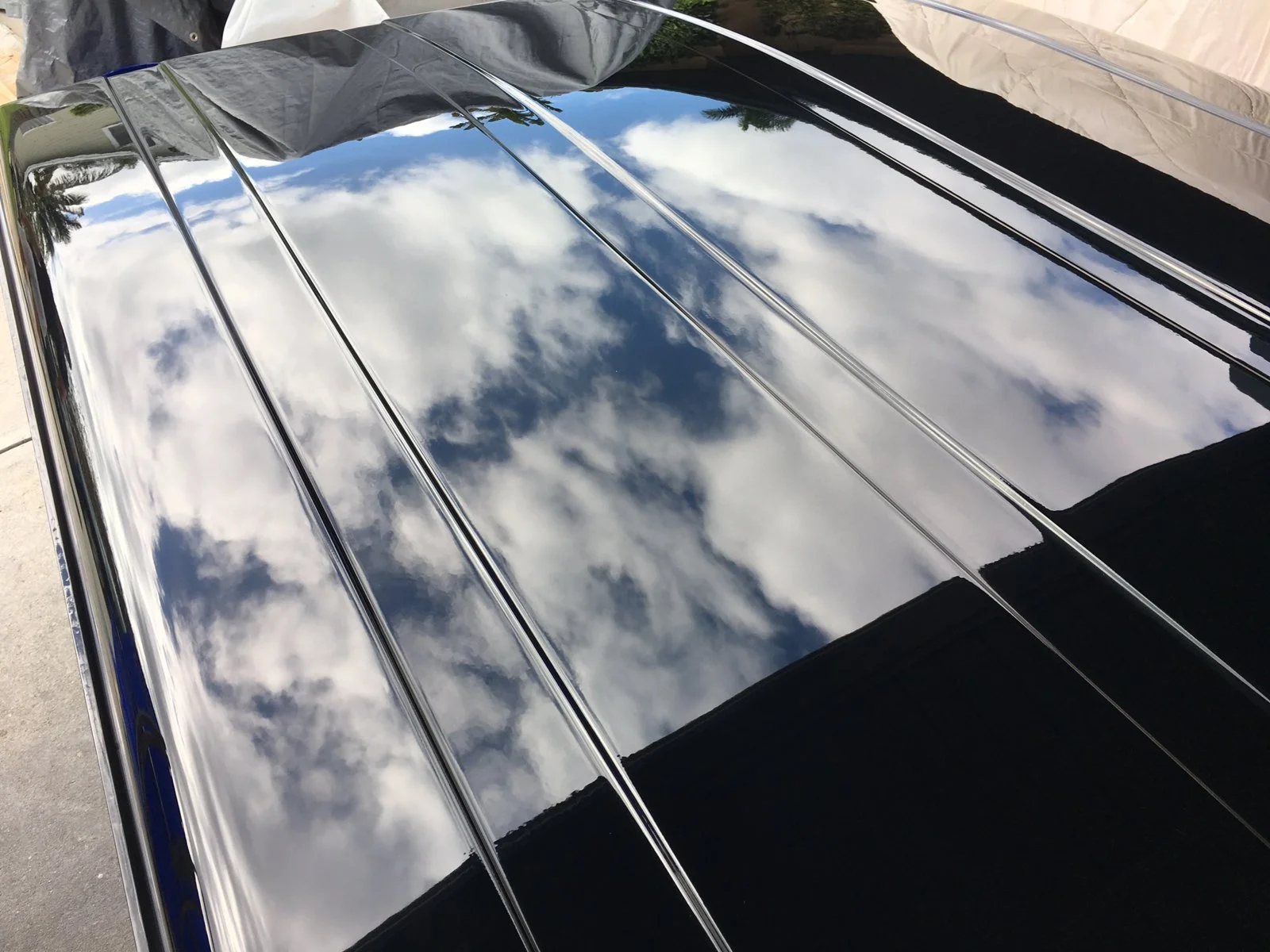

Thank you so much! Took 6 months on the paint. I am 6’1” and I have 5 inches above my head now. Much quieter inside. She loves it even more than she did before!

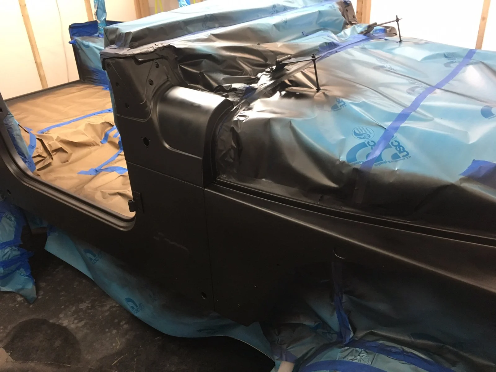

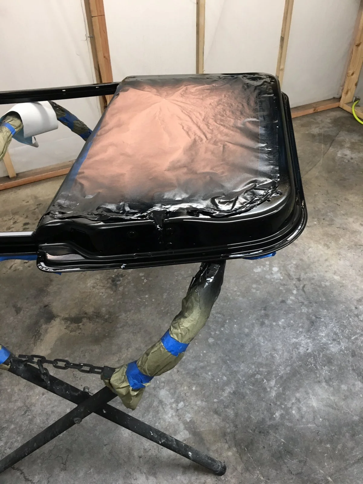

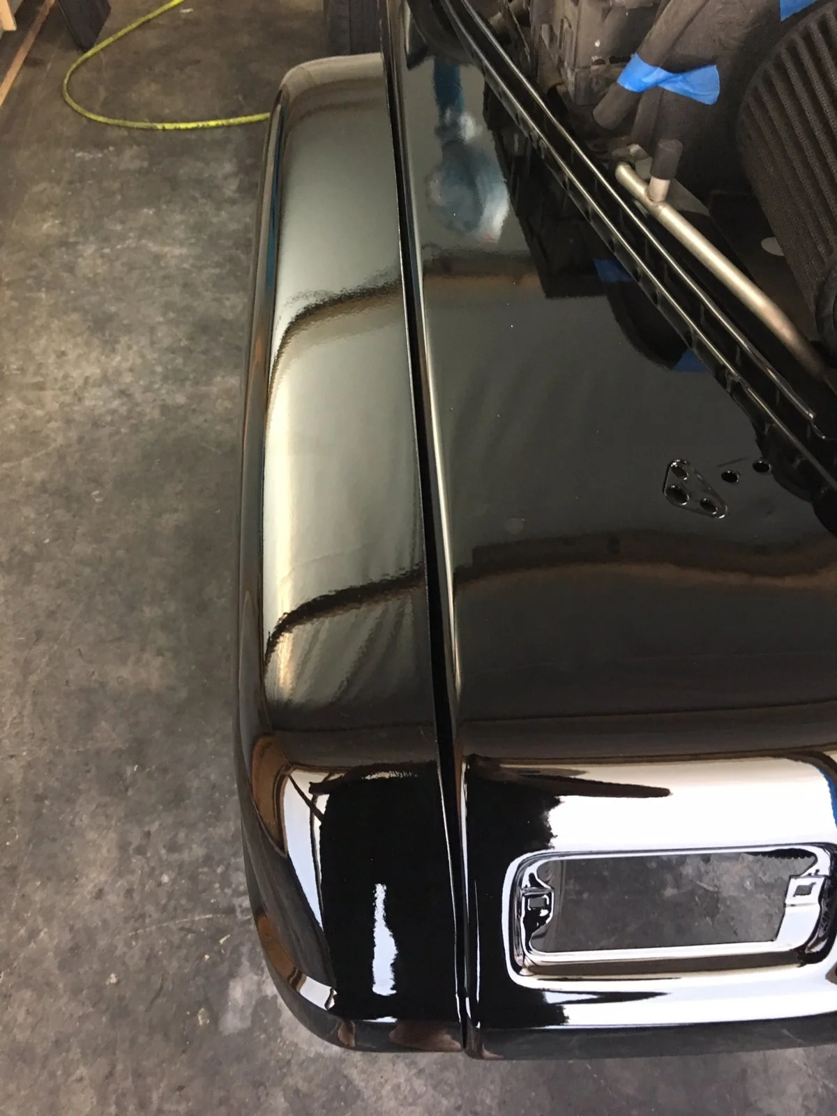

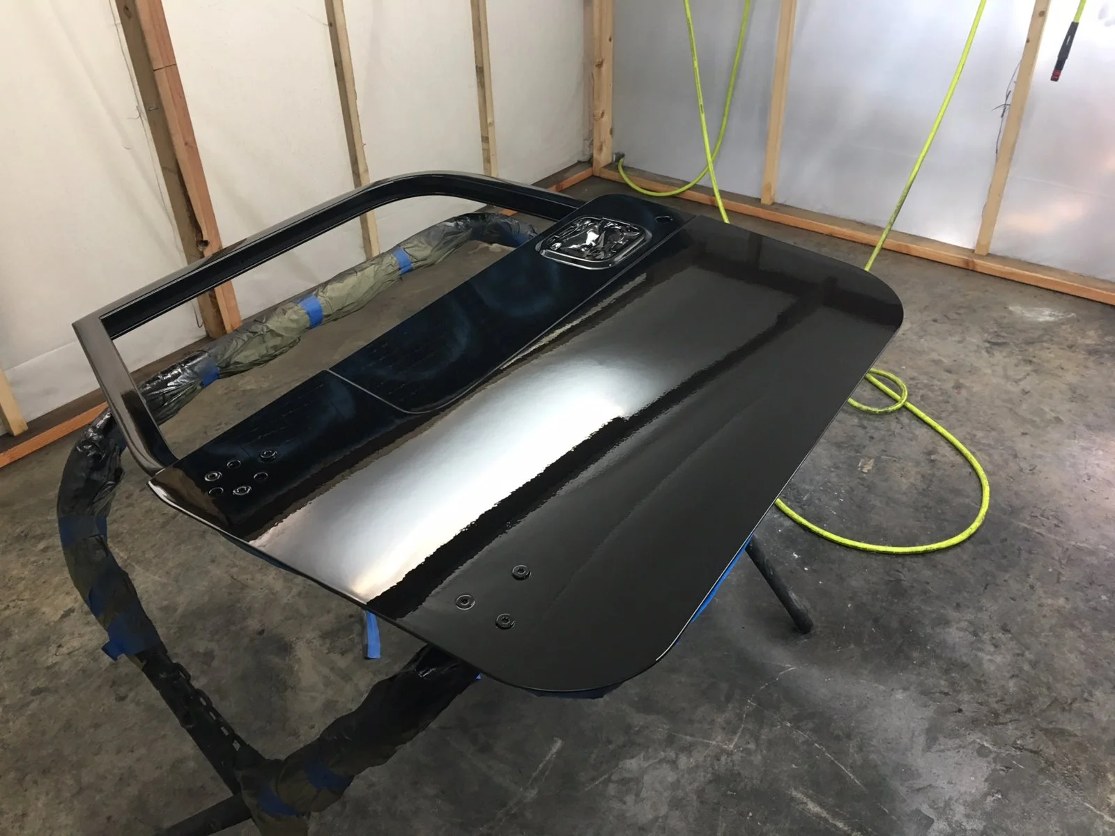

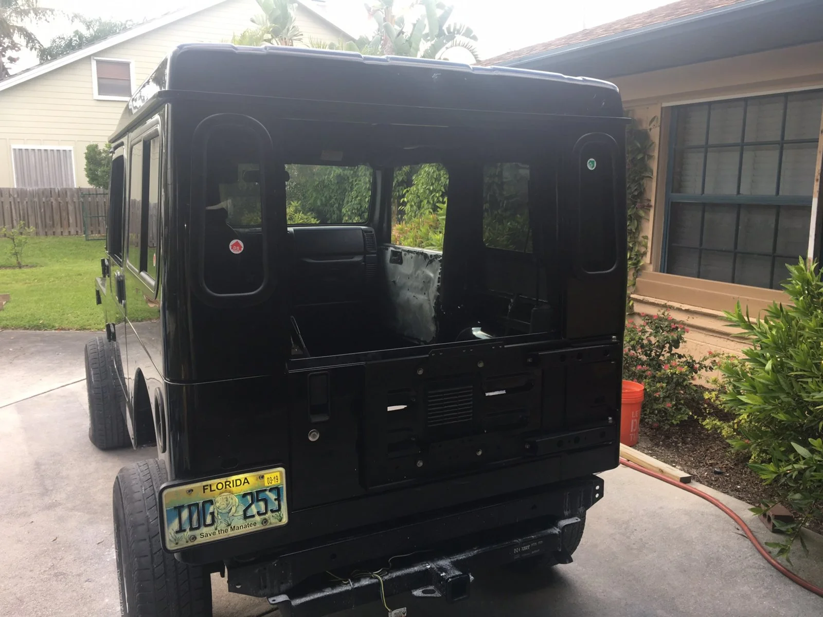

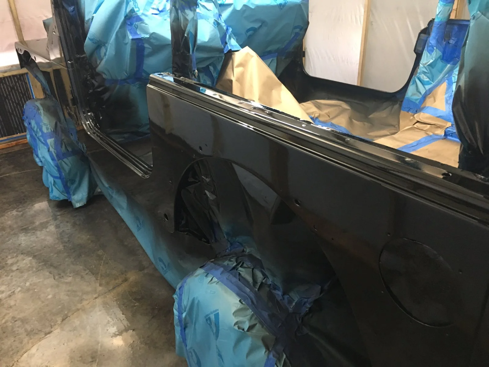

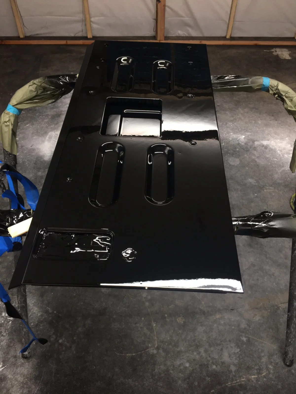

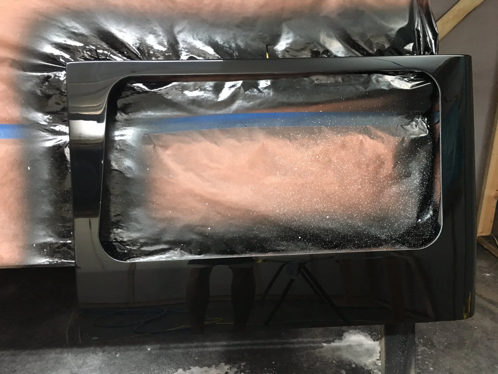

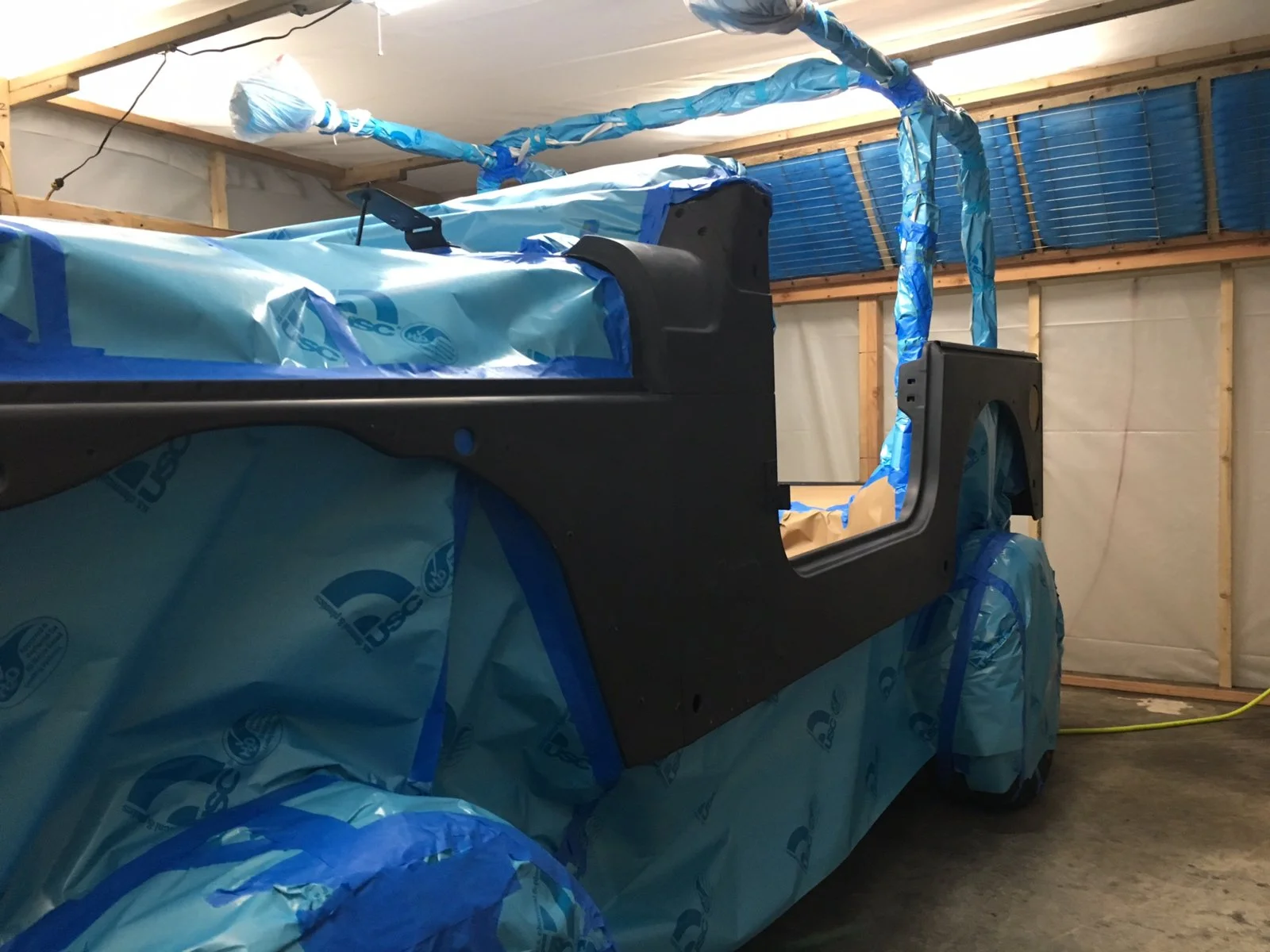

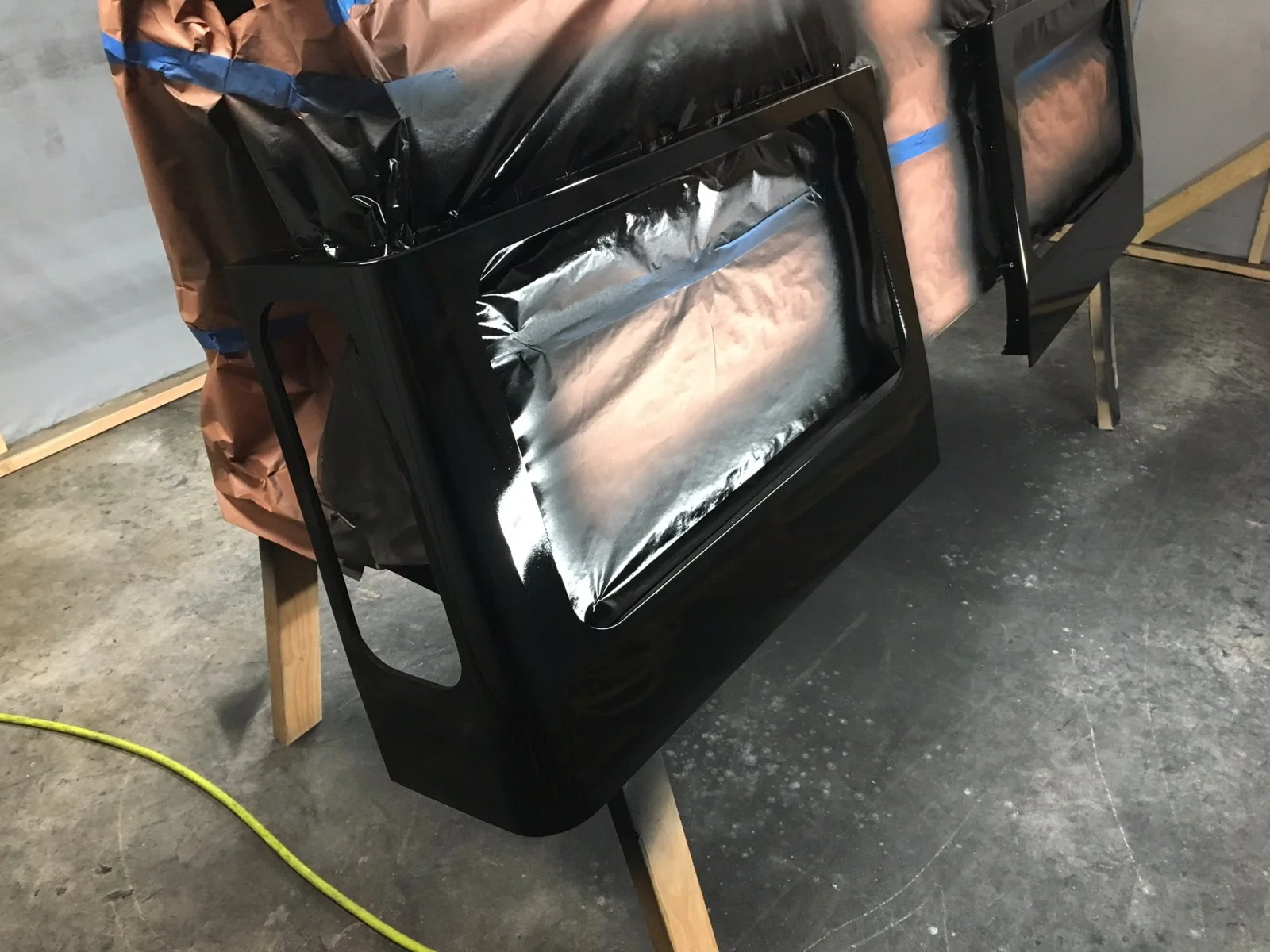

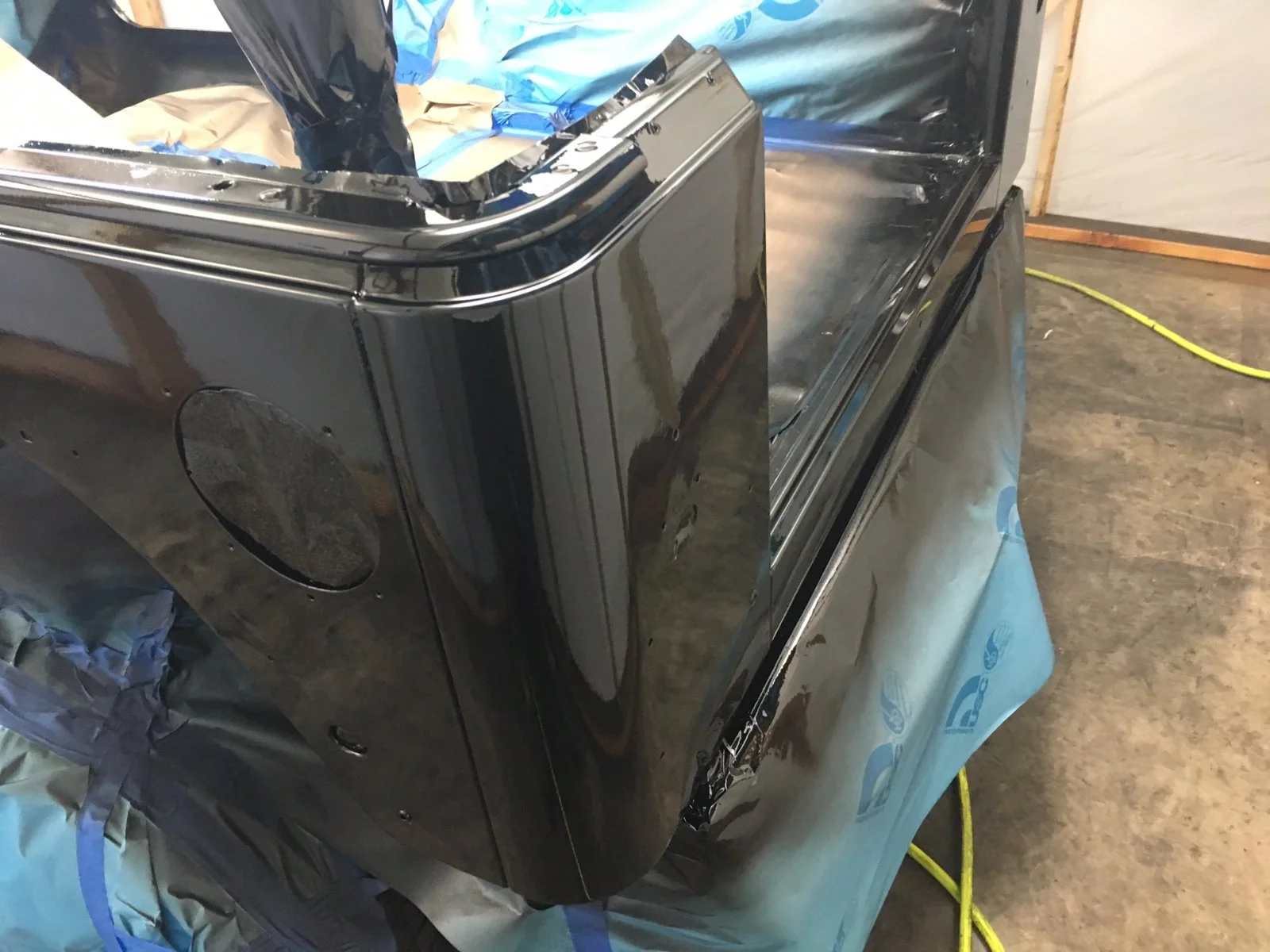

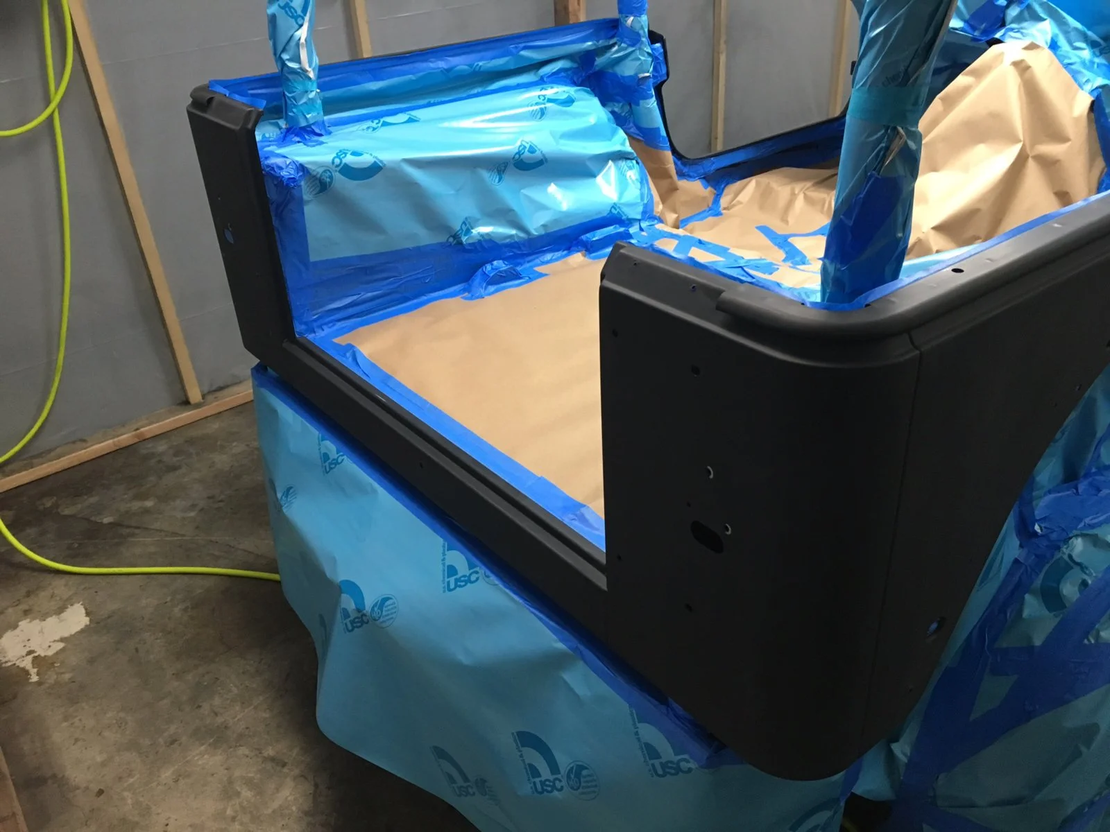

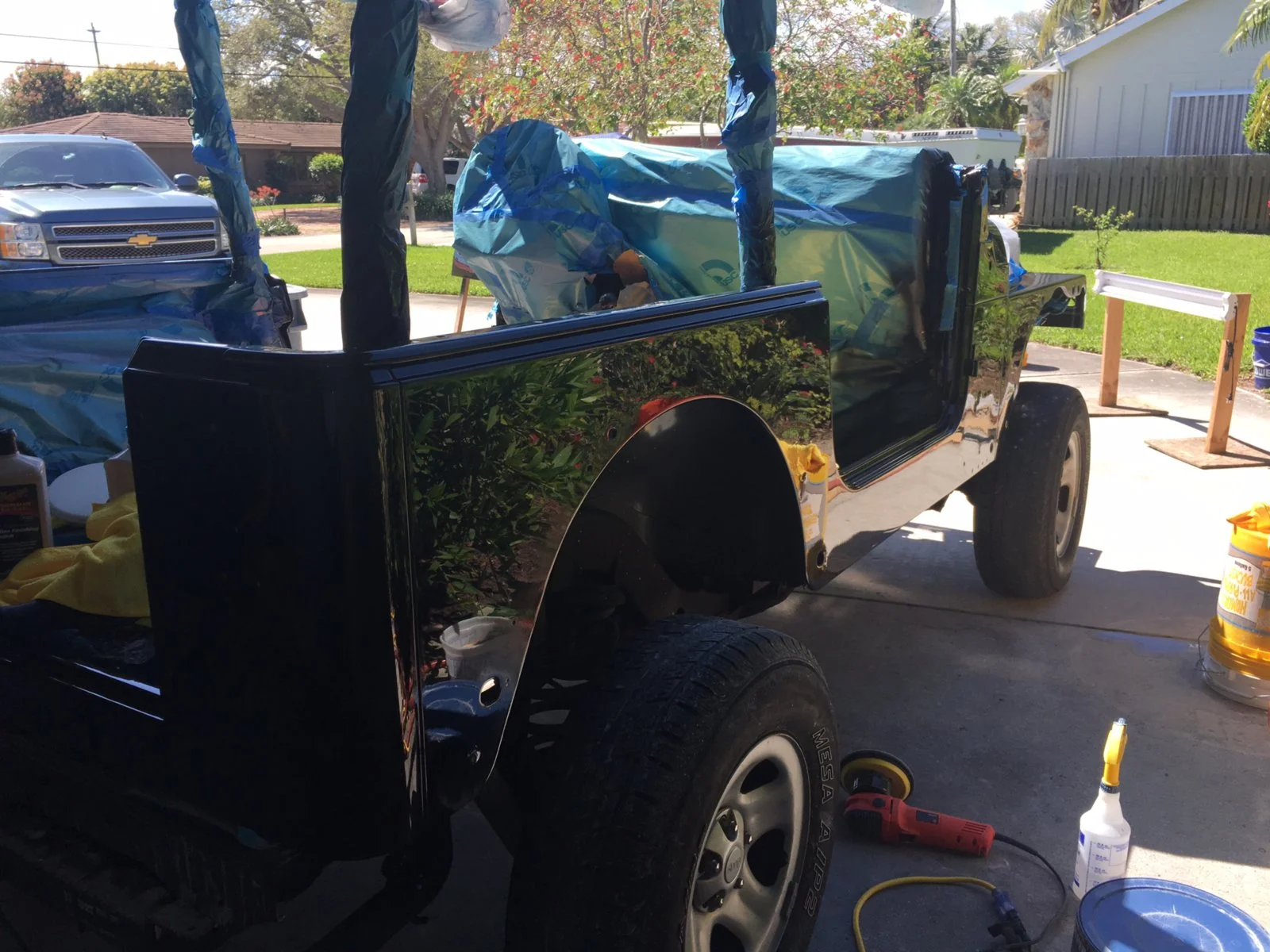

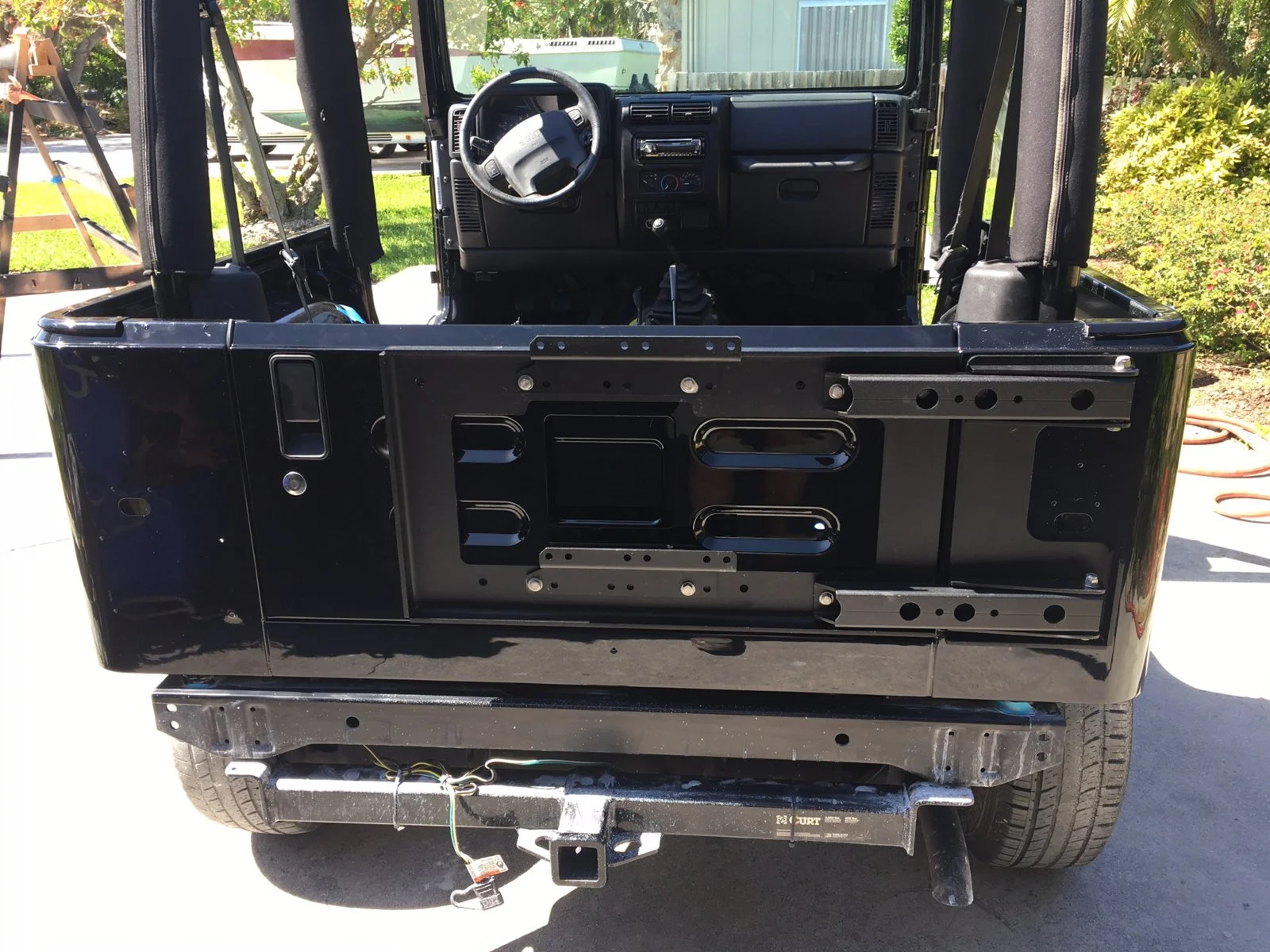

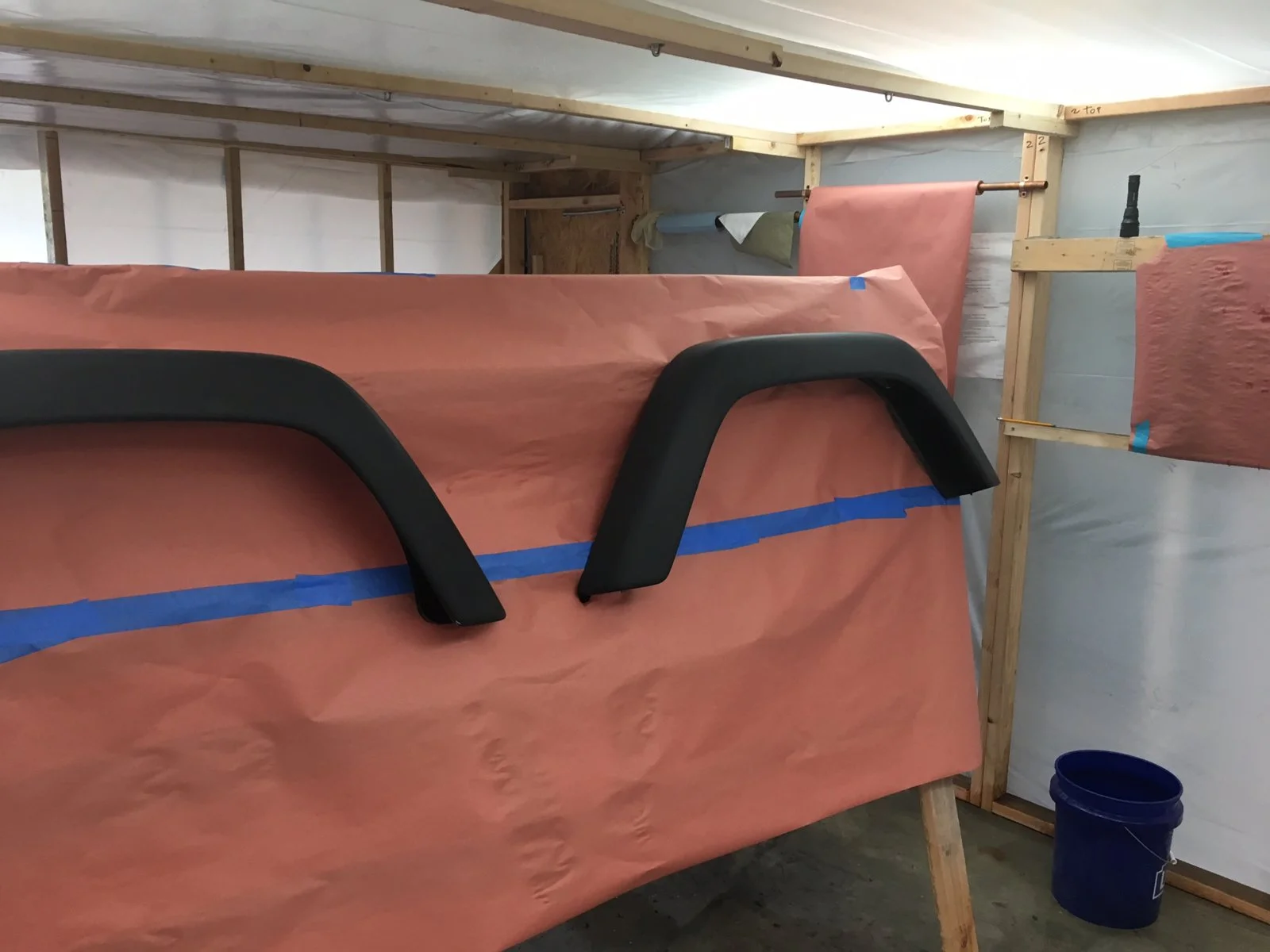

I painted it myself in my garage. These are som pictures at different stages of the process. Sealer, then Basecoat, then clear Clearcoat prior to wetsanding with, 1500, 2000, 3000 and finally 5000 grit paper prior to buffing. Lots of hours but I am really happy with the way it turned out

WOW, you did it the right way too!
Are you a painter, or was this your first time?
No way that was his first time painting. That is a top notch layout of the finish. That's a nifty little cross flow booth you constructed too! A clean painting environment with good visibility makes a huge difference in the end result. Well done sir!
Thank you, yes, built the cross flow booth from watching “Comet sixty two” on YouTube. He had a lot of good ideas I put into this booth. Hope his car came out good, I don’t think he ever showed his final paint job. But a smart guy.
